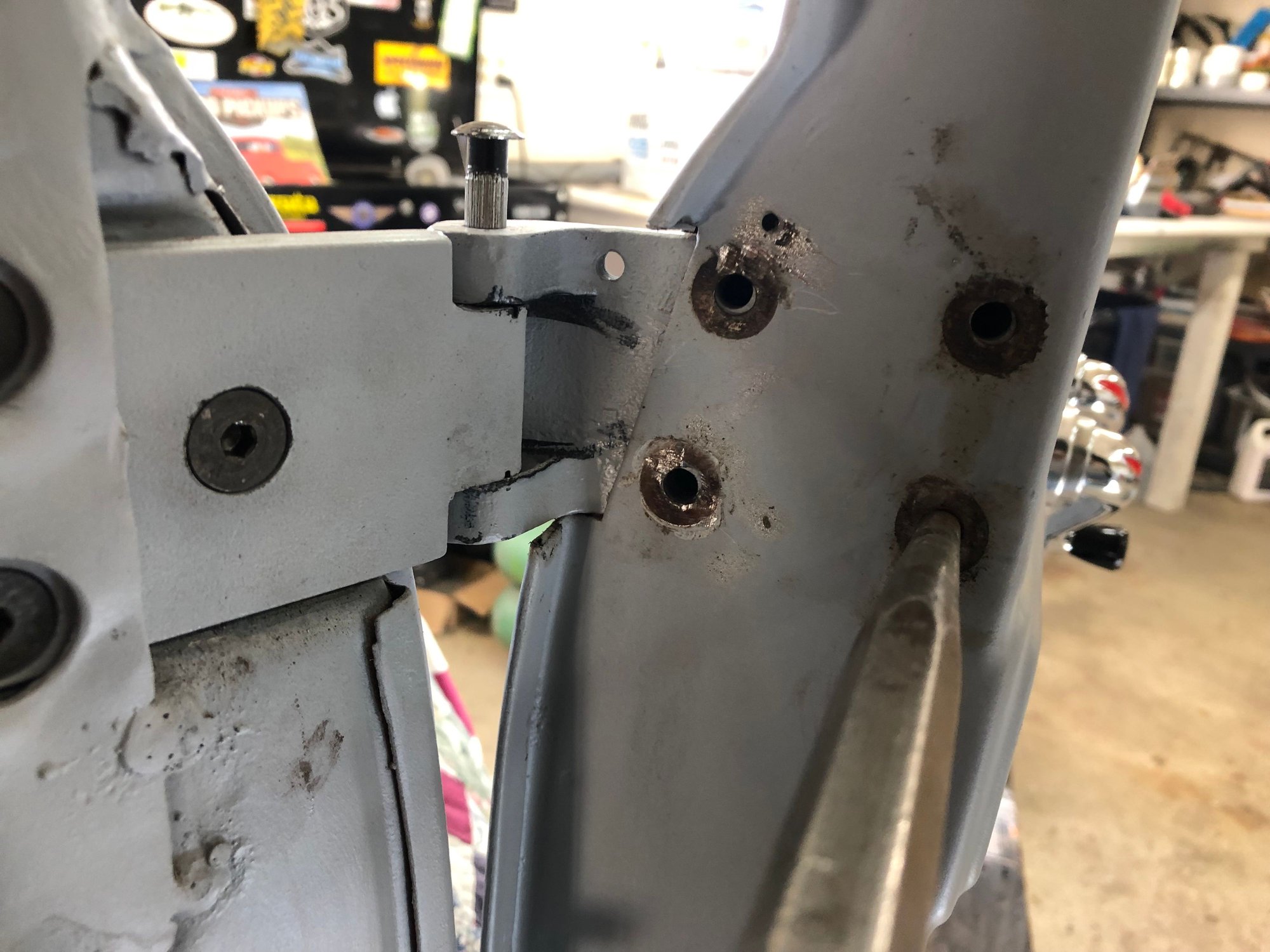

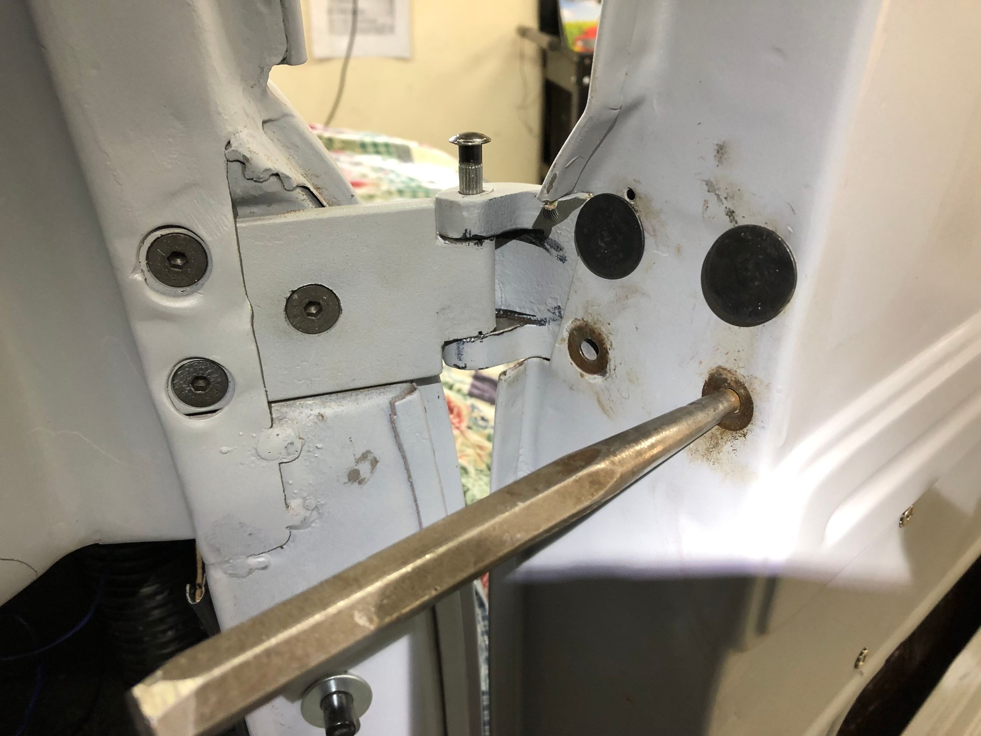

Left hinges in my ‘49 and imagined I’d remove them later, if needed. HAHAHA! Truck painted, doors installed, passenger hinge pin NOT gonna budge. Cannot heat red (painted) but warmed, lubed, beaten severely with every tool at my disposal including air hammer ( not advised per previous post). Finally drilled out hard rivets on door side then replaced new hinge with elevator bolts.
On a side note: I had to grind both upper hinges to fit mirrors (??!!). Broke one new arm discovering this.
New hinge
Did not know elevator bolts existed. Worked swell.

OK, I'll ask first. What are elevator bolts?

What is an elevator bolt?
Originally designed for attaching elevator buckets to conveyor belts, elevator bolts are similar to carriage bolts, except the head is thin and flat. Elevator Bolts have a square neck that resists turning when the nut is tightened or removed.

Also, ground MOST of square neck to fit hole. Need a tight fit, read here: hammer) to resist turning. Do not over torque. They will break.
