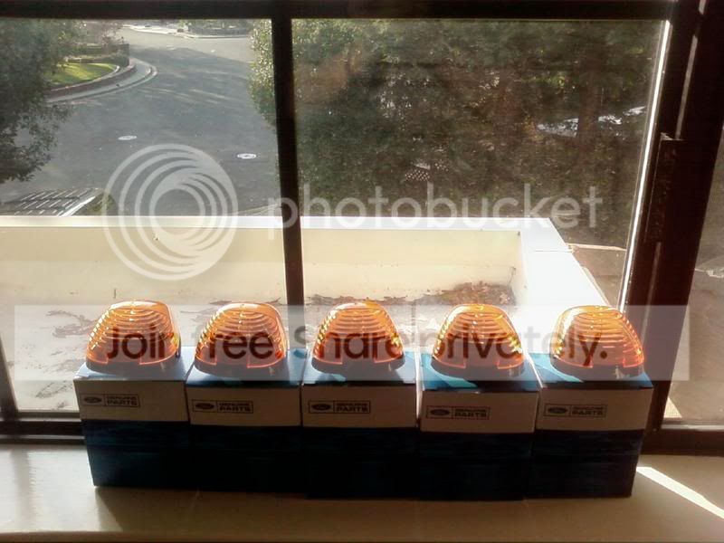

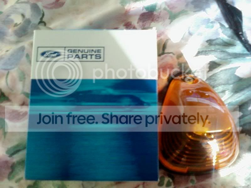

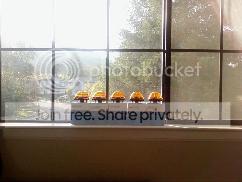

Originally Posted by weekendwarriorfsw32
Not to brag or anthing but I just got my Clearence lights for my Excursion to day.
Here are some pics
I cant wait to put them on. It sucks that I have to wait till christmas
But iam glad I got them
Nick
I just bought that same set off of ebay a little over a week ago and just put them in yesterday. OMG they look good. I love them. I couldn't drill the hole, but my uncle and his brother had no trouble doing it for me. Lol. So glad I did it. Freakin sweet. Follow those instructions by motoman. They will set your lights up perfect. Look better than the way the factory does them. Very glad I did them myself.
