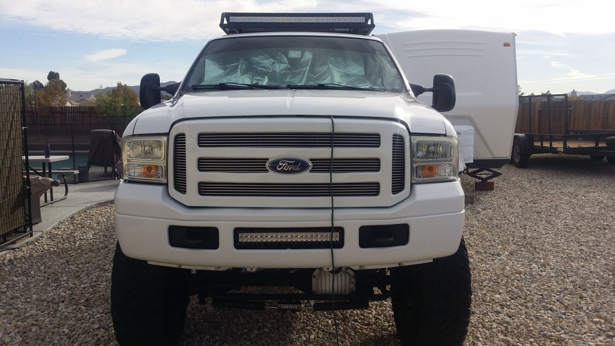

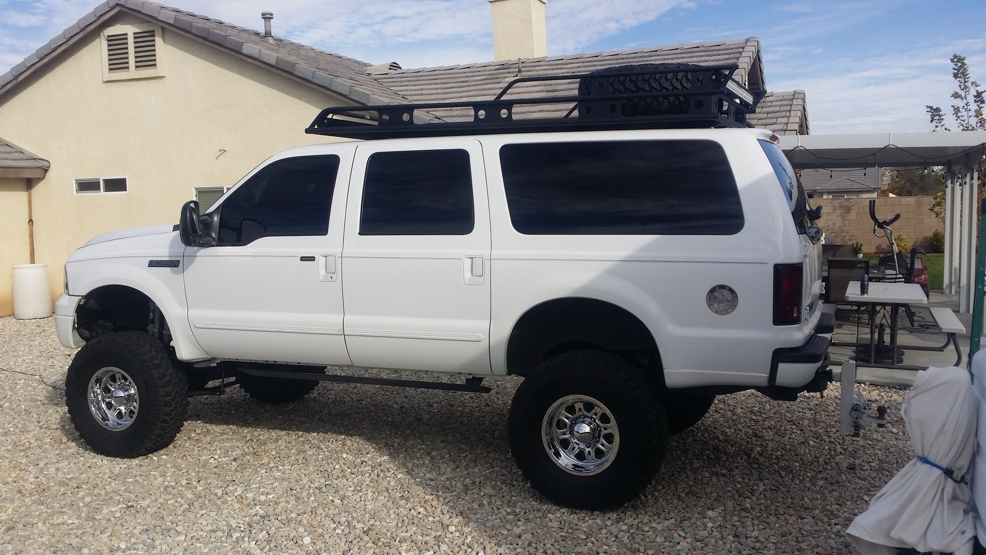

After getting prices from all the companies listed above the factor that limited me was the clearance while towing my travel trailer. The angle at which I could turn would reduced significantly. My solution was a custom roof rack with removable ladder.
It took two people to get the tire up there but literally took a minute to get up. One person got up there, tied a strap around tire, lifted tire at waist level and other person pulled up. I'm confident I could do it on the side of the road if necessary.
I ended up spending much less than a custom bumper and freed up some cash so I had my fabricator add two 50 in LED light bars and one 20 inside the front bumper.

Ummmm.......... We NEED more pics of the sweet looking EX!

Gosh damn that looks good!
I like everything about it other than nor being able to hit the car wash!
Can we get closer pics of the mounting locations?
You bring up an excellent point re the towing angles. Even owning a hitch shop and towing regularly, I failed to give that much consideration.
Are you running AMP boards on that?

That is sweet. I really need to see more pics of it. Did you drop the headliner and attach it the roll cage or just use the original roof rack mounts?

My fabricator utilized the stock mounting holes with spacers where needed. I know the stock mounting holes aren't the best but I only plan to carry my spare and any overflow cargo on long trips. He felt they were strong enough to hold the rack. It is also supported/secured by the rear ladder. He made a custom mount that slides into the stock hitch receiver and is removable (check out pics below). He was going to do another support bar vertically in the other side but felt this setup was more than enough.
Yes I'm running amp steps with the extension arms, that's why you can see the steps. If I didn't have the extension arms the steps would be much more flush with the body. Wife needed it lower so I added the extensions.

That rack is "something to write home about", it looks great! Is it steel or aluminum? How does it mount to the roof?

It was custom made by a fabrication shop in my town. Really slick mounting using factory holes and reinforced by the ladder with a custom mount sliding into the hitch receiver. All removable by the way.
Spare 37 in tire will not fit in the factory location. I could have tilted it and rested it on the third row, but did not want a projectile in the vehicle god forbid an accident occurred.
