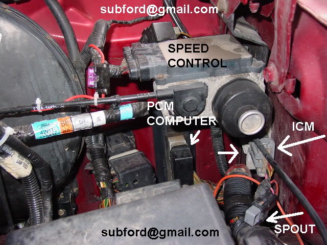

Newbie question here, what is this spout you fellows are talking about? I am having serious timing problems with a very similar setup to this subject and would like to know what the heck is going on? I'm used to much older vehicles which have a vacuum line. This 460 has only wires going to the Distributor.
Old Oct 5, 2021 | 10:11 AM
rla2005's Avatar
rla2005
Posts: 20,761
Likes: 1,734
From: Kentucky
You would be much better off to start your own thread....but in the interest of helping out a newb
SPOUT location courtesy of Subford
Attachment 277411
