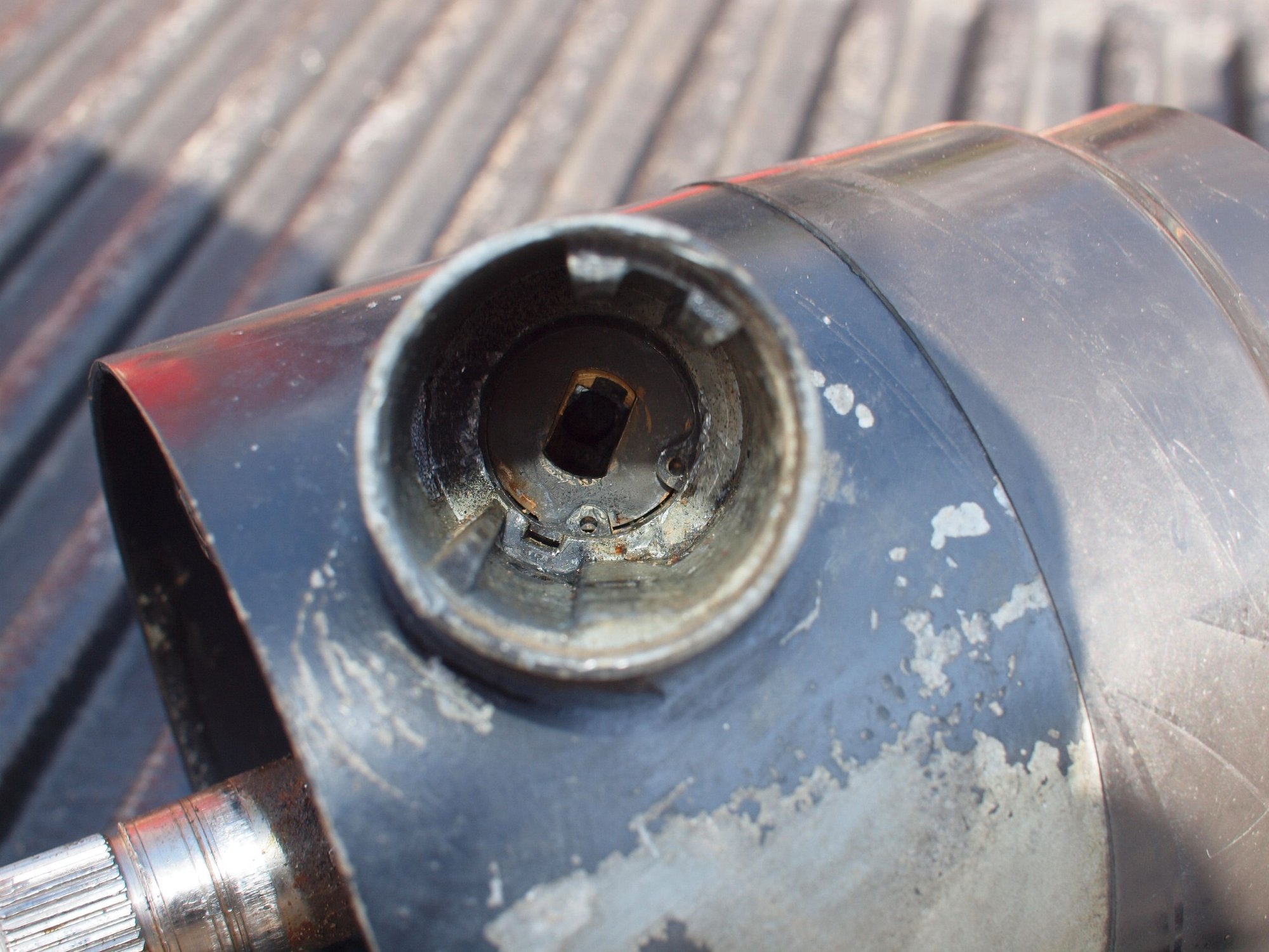

Originally Posted by DPDISXR4Ti
Relative to this step from the post above...
6) Remove lock cylinder gear (snap ring pliers required). It is down in the hole that you took the lock cylinder out of.
I got the lock cylinder removed and peered down the hole. I don't see a snap ring. Maybe a need a flashlight!?
Answering my own question, indeed there is a snap ring down there which will become much more visible once the ~30 year-old grease is cleared away. Pic tells the story....
