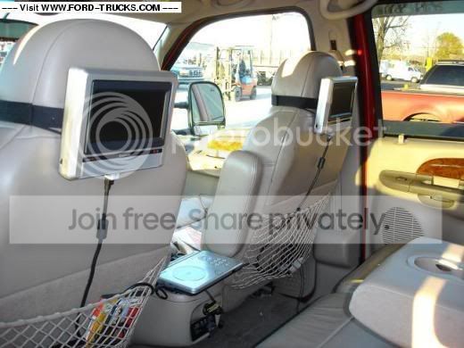

I didn't see that in my manual, may have missed it. My X is a company truck and we had a plow installed last year when our old Dodge plow truck gave up the ghost. I did alot of plowing last year with this and had not one issue with it. It is an awesome truck to plow with.
My boss has even sat in the back watching a movie while I have plowed, just to observe mind you. ha ha
