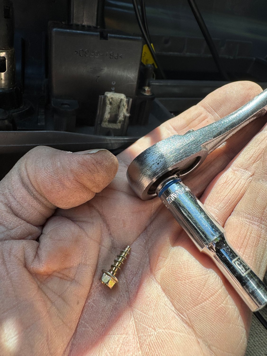

I finally realized that my airbag light was flashing code 27 and I read this thread. I offer a few photos showing how I soldered in a #37 bulb to fix this issue.

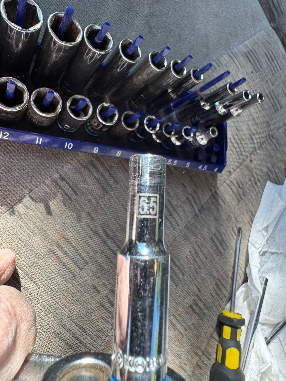

After you pull the dash surround out, you’ll need a 5.5mm socket to withdraw 3 screws that …

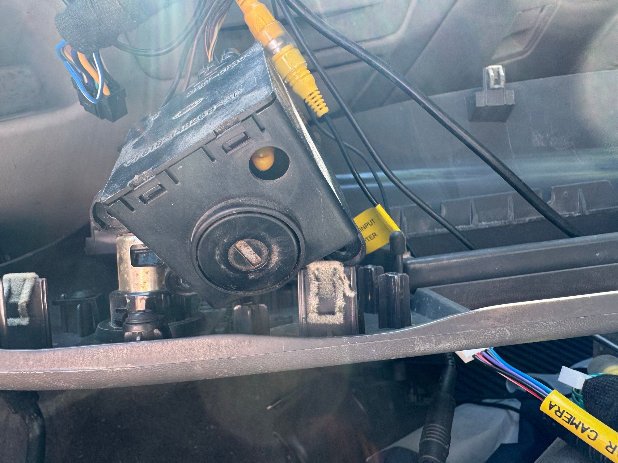

secure the black plastic assembly to the back of the dash surround,
You use a small flat head screwdriver to carefully pop up the tabs and lift a cover (seen on the top in this view) on one side of the box to access the PCB.

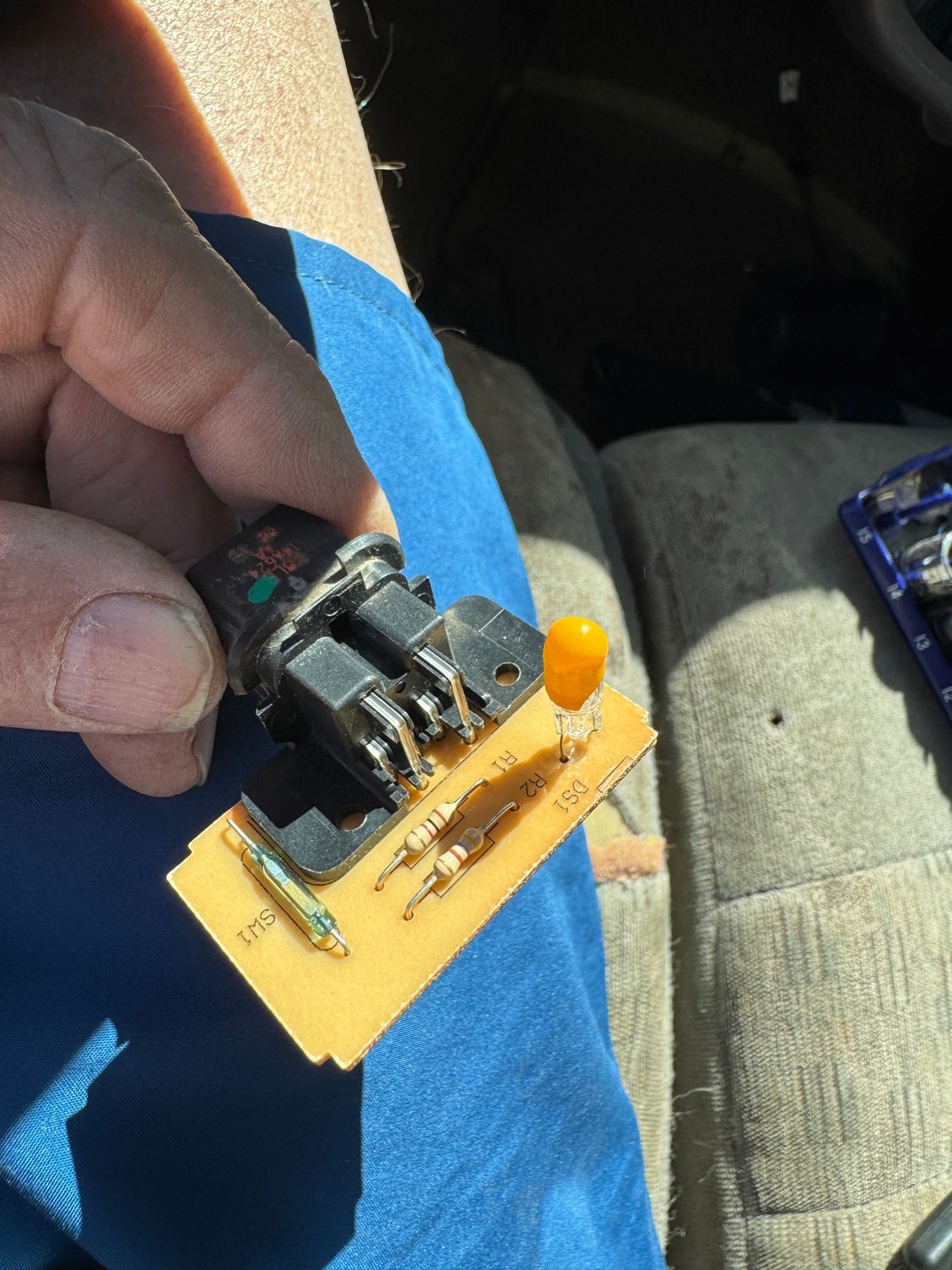

Here’s the small circuit board with a small bulb soldered in.  Note a thin plastic sleeve over the glass bulb.  If this bulb is burned out then the dash airbag light throws the 27 code.

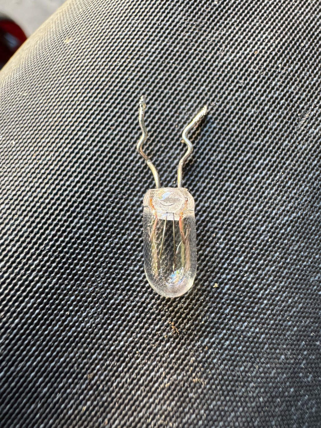

The bulb I sweated off the PCB.  I carefully got the yellow plastic sleeve off of it and put that on the new bulb after soldering was done.

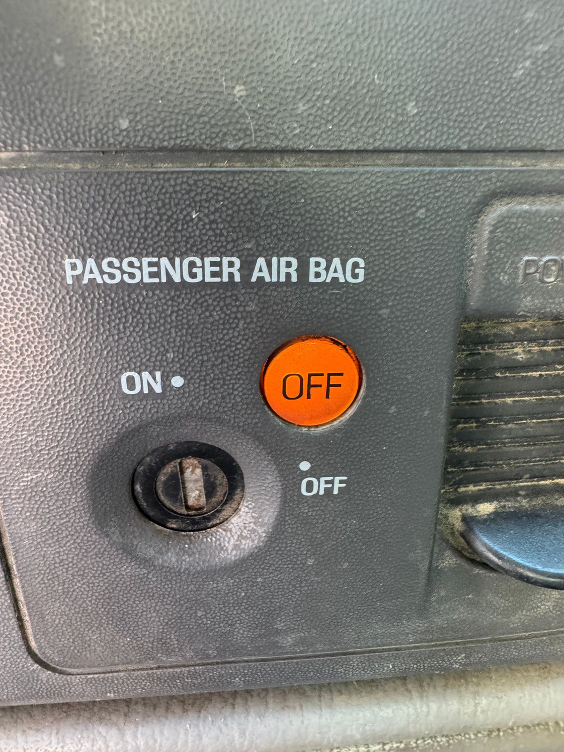

At start up you get a solid airbag light for a few seconds along with…
a solid (newly replaced) passenger airbag light.  After hearing a short beep these bulbs go out.  If you rotate the key switch to the “off” position, then that small bulb will stay lit.  I’d rather not burn it out too soon, so passenger or bag can stay on for me.
a solid (newly replaced) passenger airbag light. After hearing a short beep these bulbs go out. If you rotate the key switch to the “off” position, then that small bulb will stay lit. I’d rather not burn it out too soon, so my passenger air bag can stay on!
