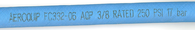

For the price of one of those bags of Ford pre-cut hose, you can buy a couple of feet of the same hose and cut the lengths you need. Go to a local speed shop that sells Aeroquip hoses, and buy this stuff:
http://www.backglass.org/duncan/aeroquip.jpg
If you go to a truck place looking for the high-temp diesel hose they'll look at you like you're crazy. Big rigs don't run fuel lines next to turbos, so they don't have this problem.
