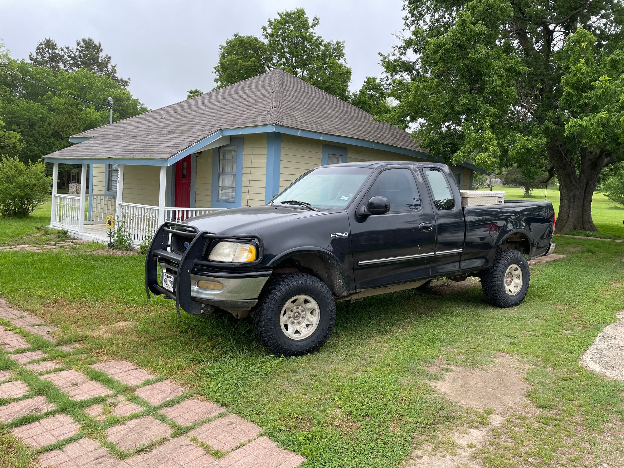

1997 f250 LD, 4x4, 5.4 2v.
just bought for $1k from an old farmer who’s had it for the last 15 years. It sat in a field with no window for the last year, so the interior was nasty, full of rat **** and dirt dobber nests. I gutted the carpet, and swapped the interior (mostly) with an 03 f150 parts truck I bought. Trying to make this thing awesome again!
Stock with the exception of a few LED light bulbs, and it has a small body lift from the previous owner, but I’ll be adding remote start/ keyless entry/ push button start, cab lights, and a bunch of other goodies as I go. Just put 285/75r16 Goodyear wrangler duratracs on her. Still working out kinks, my 4x4 isn’t working right and I’ve got a p0174 code, so I’ll likely be replacing all the vacuum lines in the near future.

couple of things to check, above the battery is a solenoid that will get corroded and could by why the 4x4 will not engage , on the vacuum leak check the PCV tube where it goes into the back of the intake, it is a rubber elbow that is known for going bad. Find a old rubber boot from a ignition coil wire as replacement. https://www.ebay.com/itm/MSD-Ignitio...t/182678219417

yessir, I had the same inclination as far as my p0174, so I checked the PCs tube and it looks like it’s in good shape. Went ahead and replaced the pcv valve and it’s still present, so I don’t think that’s the issue.
as far as the 4wd, when I bought the truck, the SOTF switch connector was ripped off, so I bought a new switch and connector and wired them in, but when I try to put it in 4hi, the 4x4 light comes on and that’s all it does. When I switch back to 2hi, the light stays on. Checked fuse #23, and it’s good, so I suppose the best place to start would be checking resistance at the switch connector?
