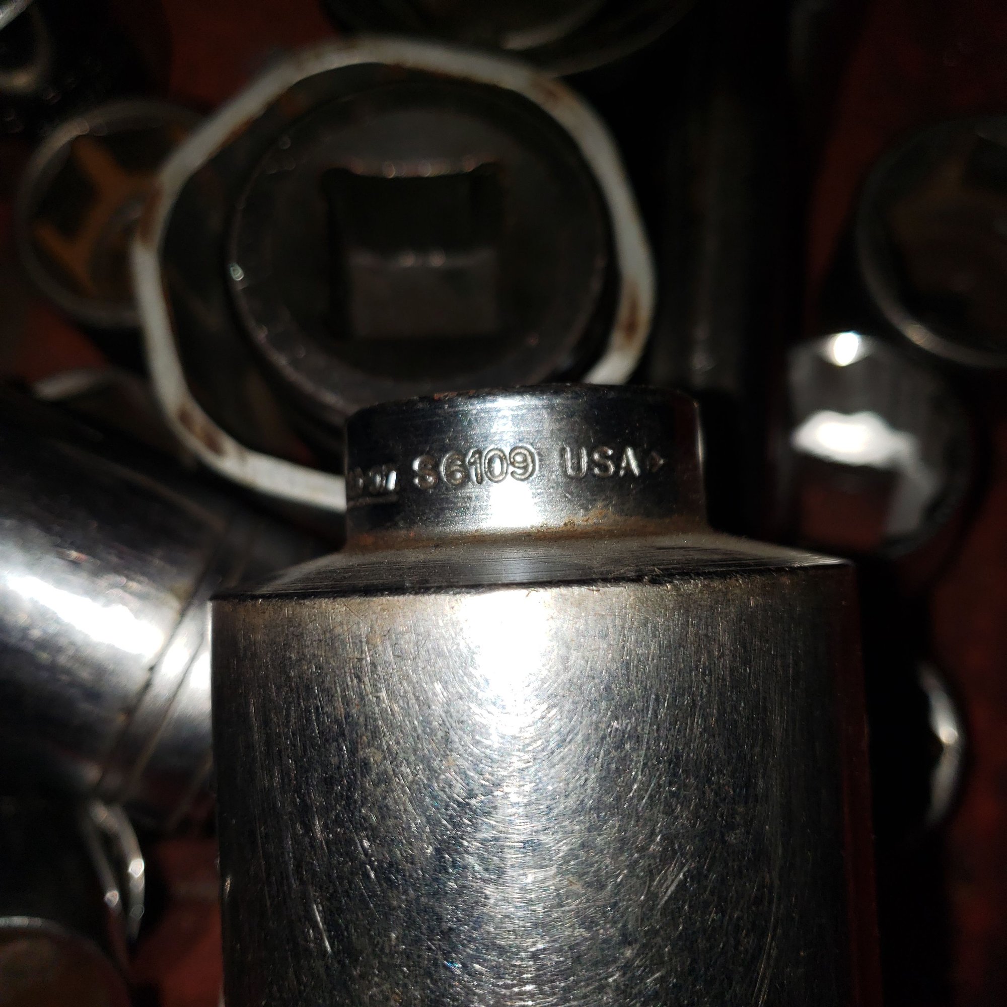

Snap-on S6109 Made in USA
I have them all after all these years

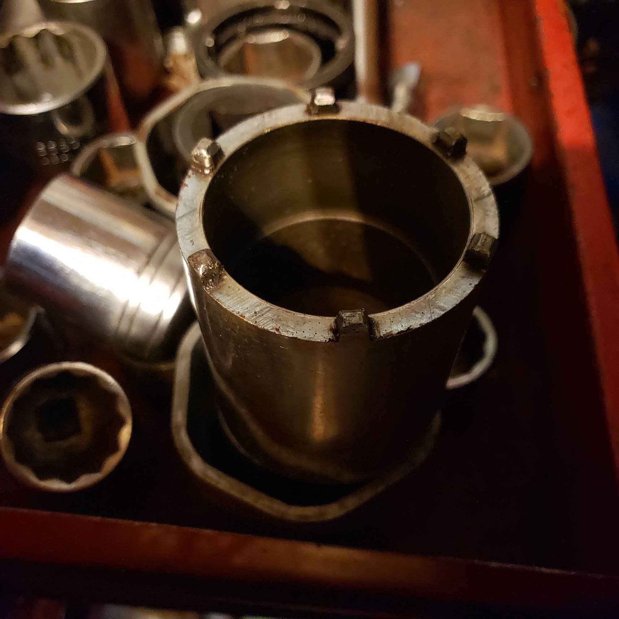

The six prong ones were only used on the rear axle nuts for a short time I think
Possibly used on the front on GM trucks
Made for a different type retainer
One nut against the other (with a flat washer style retainer (where you bend one of the tabs to hold the inner nut in position

Confirming item number for 6 point socket
just to confirm, the S6109 is for the front hub spindle nut just after the outside bearing on the three screw front rotors on 4x4 5.8L 1995 Ford F-150. Thank you for the information.

No, the 3 screw version automatic hub takes the special thin wall six sided socket
I would have to find that socket and post it's number
I can do that later
