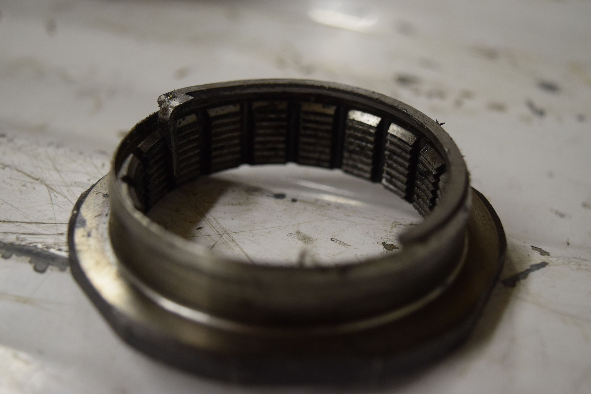

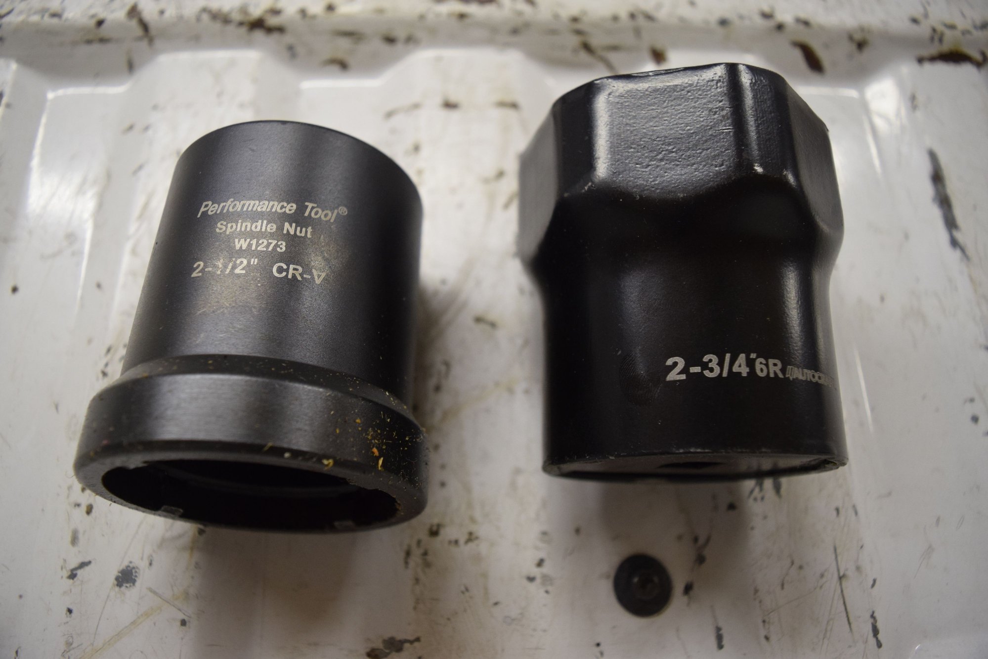

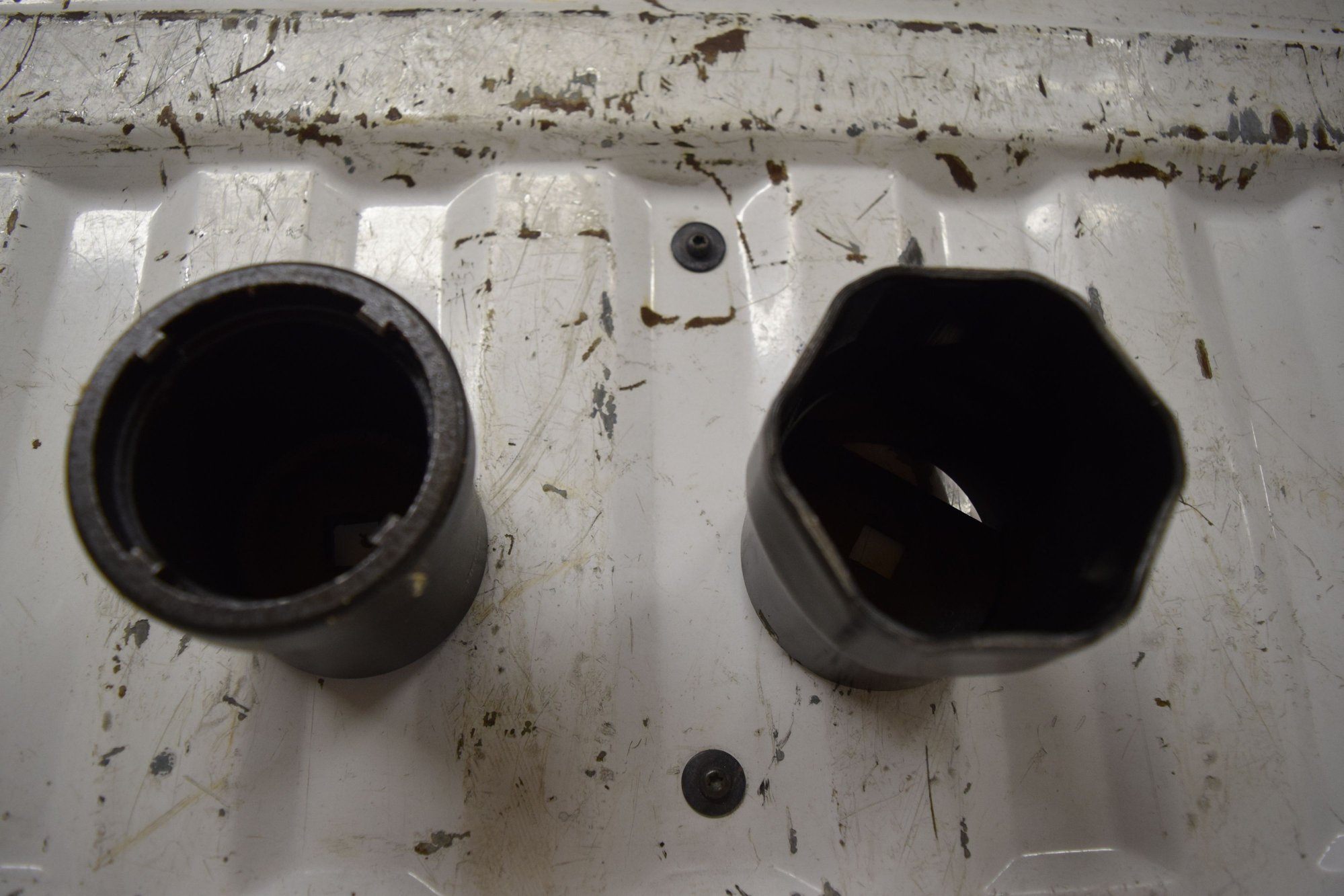

This threw me for a loop too when I did ball joints on my truck recently. To my knowledge are two different style axle nuts, four prong and rounded hex, and different sizes for the various axle types, Dana 44, 50, 60. I believe the correct sizes for the OBS F350 Dana 60 are: 2 1/2 inch four prong for the manual hubs, 2 3/4 inch rounded hex for the automatic hubs (someone correct me if I am wrong). What was really confusing for me is my truck had manual hubs, but it had the automatic hub nubs. The truck had the auto hubs from the factory, but the original owner swapped them for manual hubs apparently without swapping the nuts.
Here are the two different style sockets:
Manual hub socket on left, auto hub socket on right
Here's a close up up the sizes:
Here's the auto hub not with c-shaped lock ring:
Got to make sure the lock tab on the lock ring is not broken and is inserted properly in the slots
Manual on left, auto on right
