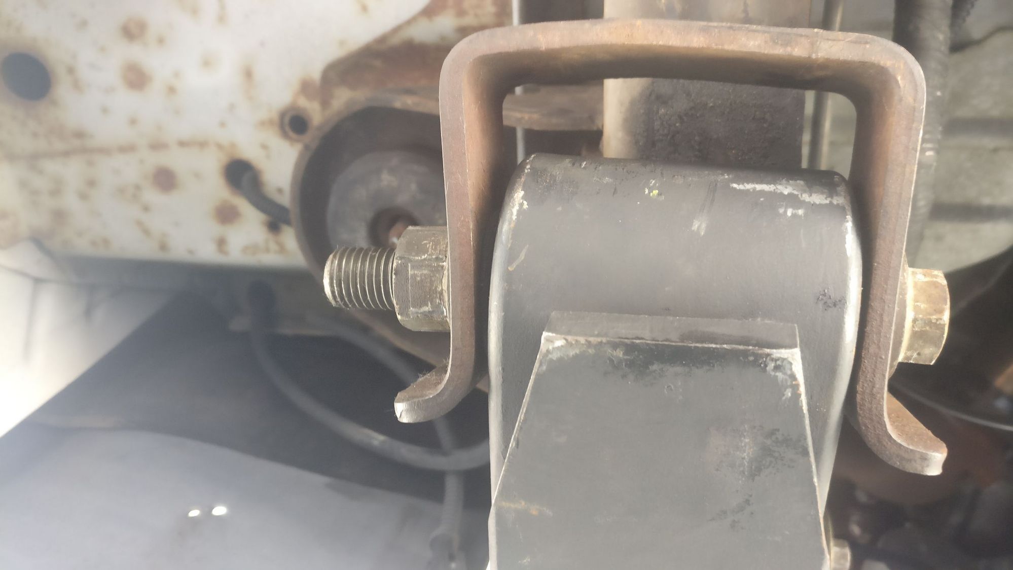

Here's a pic from the underside...

Bushing definitely seems too narrow.
