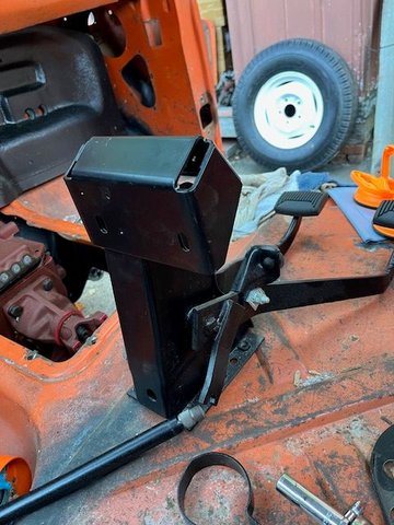

So, as some may know, I actually have two trucks I'm working on in a race to get at least one working as I am currently without a working truck. I initially thought that the '66 F250 was the more likely one to get working, so I stopped my efforts on the '65 F100 I'd been dealing with the past year. Mission creep set in and the '66 F250 workload expanded and I'm off to the electroplaters and powder coater to refresh the parts I will be reinstalling.
I spent today working on the '65 F100 for the first time in a couple months. The rationale was that I could use the '66 F250 as a guide on which nuts and bolts to use for the reassembly. I had stripped the '65 cab down to the bones. This is required to replace the firewall insulation.
I bought the ABS version from Dennis Carpenter. It is not original, but I feel it will be more durable than the original type.
Lessons learned (over the course of this day) hopefully to spare others from wasting time figuring it out.
1. Hopefully you retained the original insulation cover as a template. Use it to identify which cutouts are necessary. There are several cutout on the ABS panel to account for various configurations.
2. Allow about 20 minutes with an xacto knife to clean up the openings as needed.
3. Unless you have unobstructed access to punch the original metal plugs through the firewall from the engine bay, they will likely break if you try to pry them out with a claw hammer. Buy some new ones. I decided to purchase metal ones from DC which are pricey but the plastic ones at the auto store weren't that much cheaper when only sold in pairs for $5-6/package. If you buy the DC firewall insulation, you've already committed to spending money.
4. Test fit for good measure to ensure all the openings line up as expected. Do not attach at this time. Then set aside.
5. Install the steering column metal bracket with rubber gasket from the inside. It should be clear that the steering column has been refurbished prior to this and the steering shaft should not be installed withing the column during this initial sequence.
6. Install your newly refurbished pedal assembly; the one with the new plastic bushings and new paint that's been lying around for months waiting for the big reveal. Yes, that one. Your instrument cluster has been removed a long time ago and it's waiting for its big day too, but not today.
7. The pedal assembly can be slid into position and will hold itself in place so that you can install the bolts from the engine side into the firewall to secure the pedal assembly. I've left these bolts slightly loose as I figure out my brake system upgrade and will likely need to install a bracket using these bolts; so I'm on hold for now.
8. From the inside, install the two bolts with washers and locknut to attach the rearward end of the pedal assembly to the dash. The instrument panel is out and allows this with ease.
9. I called it a day at this point but tomorrow I start by placing the ABS firewall insulation up against the wall, then slip the steering column through the opening; do not bolt it in place yet. At this time lay the column flat so that you can slide the steering rod, from the outside into the steering column. I set the retainer clamp approximately 3.25 inches from the forward flange of the steering rod, as I found in my other truck, for reference. I needed to do this as I have the steering box in place so I needed the clearance by keeping the steering column horizontal while doing this.

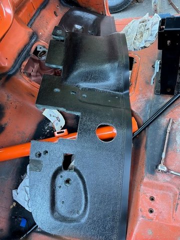

Check fit of firewall pad

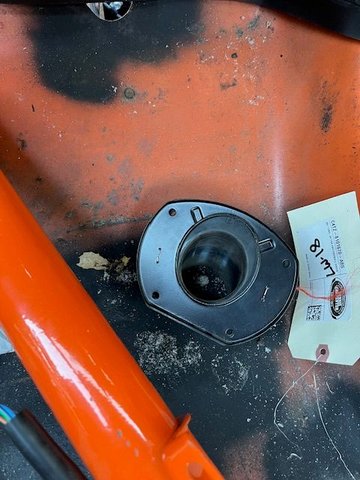

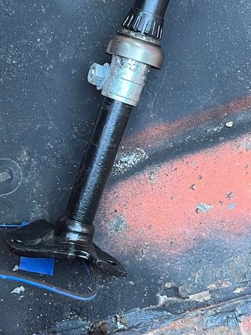

Steering column grommet attached to metal backing plate with two handmade staples.  I used Tig wire to make the staples
Pedal assembly waiting its turn
Steering rod with clamp approximately 3.25 in from flange.  This can be adjusted as needed after installation

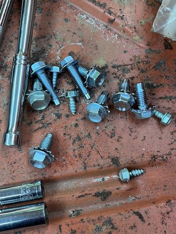

My collection of fasteners for this task.  I would remove one example of each from the '66 F250 then go through my parts bin for the refreshed bits I needed.  As soon as I finish with the '65, I will remove these from the '66 and send a bucket of bolts to the platers as well.

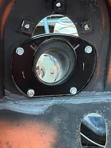

Steering column grommet installed, ready for the ABS panel to be put in place.
ABS panel ready to be placed.  I will not use the plugs until column is set in place.  Allow it to float.

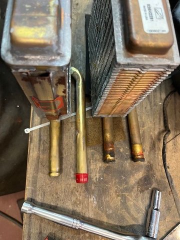

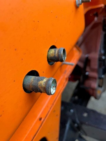

Heater tubes from original heater core.  I was not comfortable with the shortness.  I originally thought that I could gain more length by removing some insulation from the fireshield as I witnessed from the original fireshield.  Only minimal gain.
Comparison in length between the foreign made core on left and the USA made one on the right.  I don't know how old the original one was but its condition was outstanding and was the reason I originally chose to reinstall it.

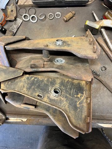

Photo showing two examples of pedal boxes each from 1966 model year.  One from my truck and the other from a spare cab I acquired several years ago (since discarded).  Both had cracked bushings on the clutch-side bushing

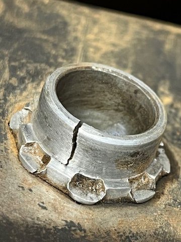

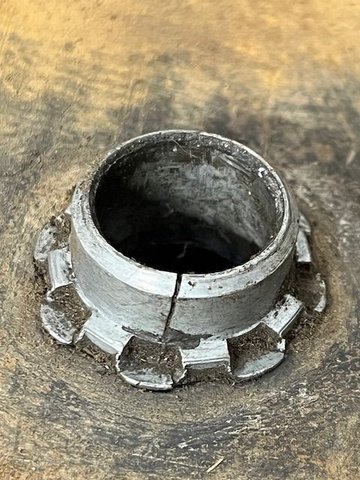

close up of one cracked bushing.  I had a machinist make new bushings from steel by copying the originals and tack-weld them in place from the outboard side.  The originals are a zinc-diecast material pressed and swaged in place as shown.
close up of other bushing on other pedal box.  This should incentivize folks to inspect their pedal box for serviceability.

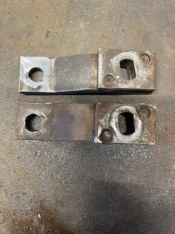

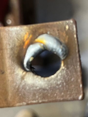

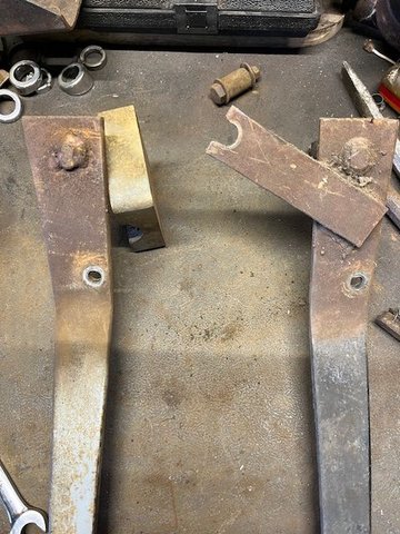

Clutch linkage swivel arm showing ovalized hole on bottom and after weld buildup and filed to fit, above

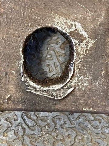

Close up of typical wear.  Note that the clutch rod that fits in this hole also, typically shows corresponding wear on both ends.  I have repaired these rods similarly with weld build up and gring/file to fit.  These components should be inspected within 5 year intervals or less, for condition.  Similar wear occurs on the z-bar as well.  I've seen the clutch rod pegs worn pretty badly, but have been able to save them.
Initial weld repair cycle

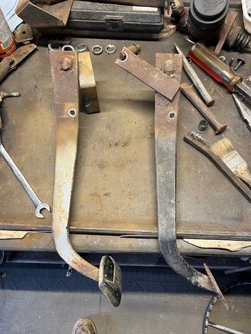

Two different Clutch pedals!!!???
Folks, I never gave much notice to my pedal box configuration on my '65 F100 as I derived comfort in knowing that I could merely take a look at the pedal box assembly from my '66 F250. So I finally got around to installing my refurbished pedal box into the '65 which gave me the confidence to remove the old pedal box from the '66 in preparation for replacing the firewall shield in that truck. Notice a pattern here? Install one component on the '65, then follow up by removing same component from the '66 for refurbishment.
Well, to my surprise the clutch pedals from each pedal box are different and I don't know how to reassemble the earlier pedal box with the additional lever arm. I know there was a strong spring used, but I forgot how to place it or where it goes. If anyone knows how to reassemble the pedal box with the spring i'd be grateful.
Photos below.
clutch pedal from my '66 F250 on left and same pedal from the '65 on right.
close up of the lever arm on the right that's missing from the '66.  All other aspects of the pedal box are the same with the exception of the bump-stop between the '65 and later '66.  I should note that the spare pedal box I have from a '66 cab also has this lever arm but the bump-stop from the '66 model year.

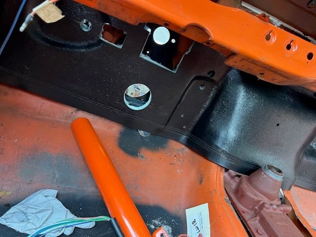

So I decided to bite the bullet and buy another ABS fireshield from DC for my '66 F250. I guess I'd forgotten just how much teardown is required to remove and install one of these. Everything needs to go: heater, wipers, pedal box, parking brake, and wiring harness. In hindsight I'm glad I committed to the work. Now this truck will look refreshed almost like my other one. Pulling the old one out allowed me to spray bomb the interior upper nether regions primarily to cover areas of thinner original paint.
I recommend buying about 4-5 of the metal tabs from DC because I found that the original ones are too short and I bent 2 new ones in the process of trying to drive the first one in. I only use 1 metal tab above the transmission area to start. Additionally I find it very helpful to use two long bolts (10-32 w/washers) to secure the lower portion below where the heater box goes which helps align the fireshield sufficiently to install the heater box. You will need a helper to attach the nuts from the engine bay.
I'm still waiting for all my suspension bits and the parts I removed for this task to return from the powder coater. I forgot to install the steering column bracket as mentioned in Step 5 of my original post. I should be able to fold the fireshield up enough to bolt it in from the inside.
Removing the floor stick shift is necessary for installation.
Location of the two temporary bolts used to secure the fireshield to aid in placing the heater box
I didn't waste the opportunity to spray the outer wall after careful masking of surrounding area.  Very rewarding when it's done.
