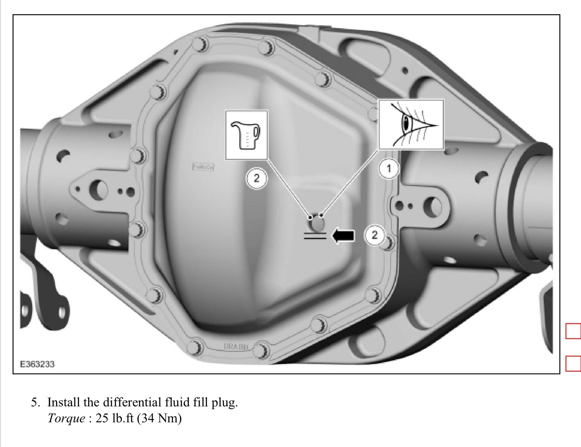

Is filling to the bottom of the hole what is recommended for Ford axles currently? I ask because I have read that for Dana axles it is 0.24–0.55 in (6–14 mm) below the bottom of the fill hole. This was in Ford workshop documentation.
I don't believe so, I believe it is a certain distance below the fill hole for everything. What that dimension is varies and I don't know what they are offhand.
Adding fluid til it dribbles back out is no longer proper procedure though, that much I DO know. At least, according to most OEMs' manuals.

Likes: 534
From: Florida
There's normally a safe zone... usually 1/4" below the hole to completely full and dribbling out, which, while there is no actually measurement given in the 2023 service manual, is exactly what every differential fluid picture in the service manual shows. The AAM on my old Ram was the same.

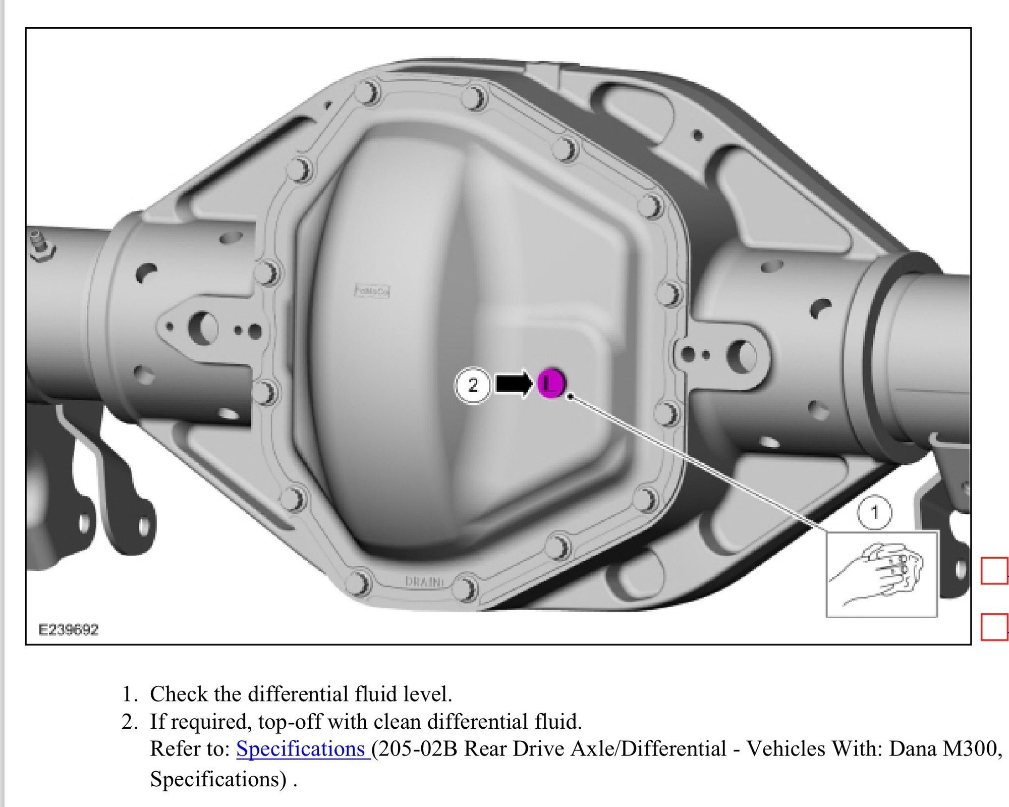

I have the 2023-2024 workshop manual. These photos show the Dana M300, but it shows the same procedure for the Dana M275 and M315 axles. For the Ford 11.6 the manual advises the filler hole is mounted too low to add the proper amount of oil so it must be added through the actuator hole for the Electronic Locking Differential.
My 23 service manual states that this is only for trucks built up to 18 Jan 2023.
Differential Fluid Level Check - Vehicles Built Up To: 18-January-2023
Check
NOTE: The fill hole on the 11.6" is to low for the capacity level needed at this time. To add the correct
amount of differential fluid it is necessary to remove the differential housing cover and drain the fluid. Then
add fluid through the ELD connector adaptor hole.

Likes: 99
That makes sense kry226, I took delivery of my ordered 2024 in December 2023. I was able to add 4.5 quarts using the filler hole when I changed it.
