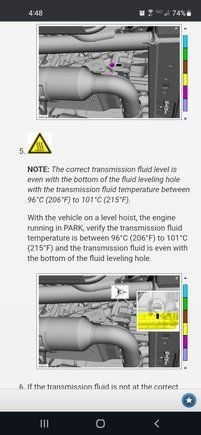

It doesn't have the stand pipe like the 10R140 and the plug on the passenger side like a 10r80 is useless. It's at the rear on the driver side and is a plug like in a rear diff. When up to temp, the fluid will trickle out so it's literally a level plug. I had to change my FMC dealer password and have a new phone as well so can't remember it. I did post it somewhere here and will look
Old Dec 7, 2025 | 10:26 PM
SMSTX's Avatar
SMSTX
Joined: May 2025
Posts: 188
Likes: 119
Here you go

Thanks for sharing that it’s exactly what I needed. Interesting that the dipstick is there but not used.
