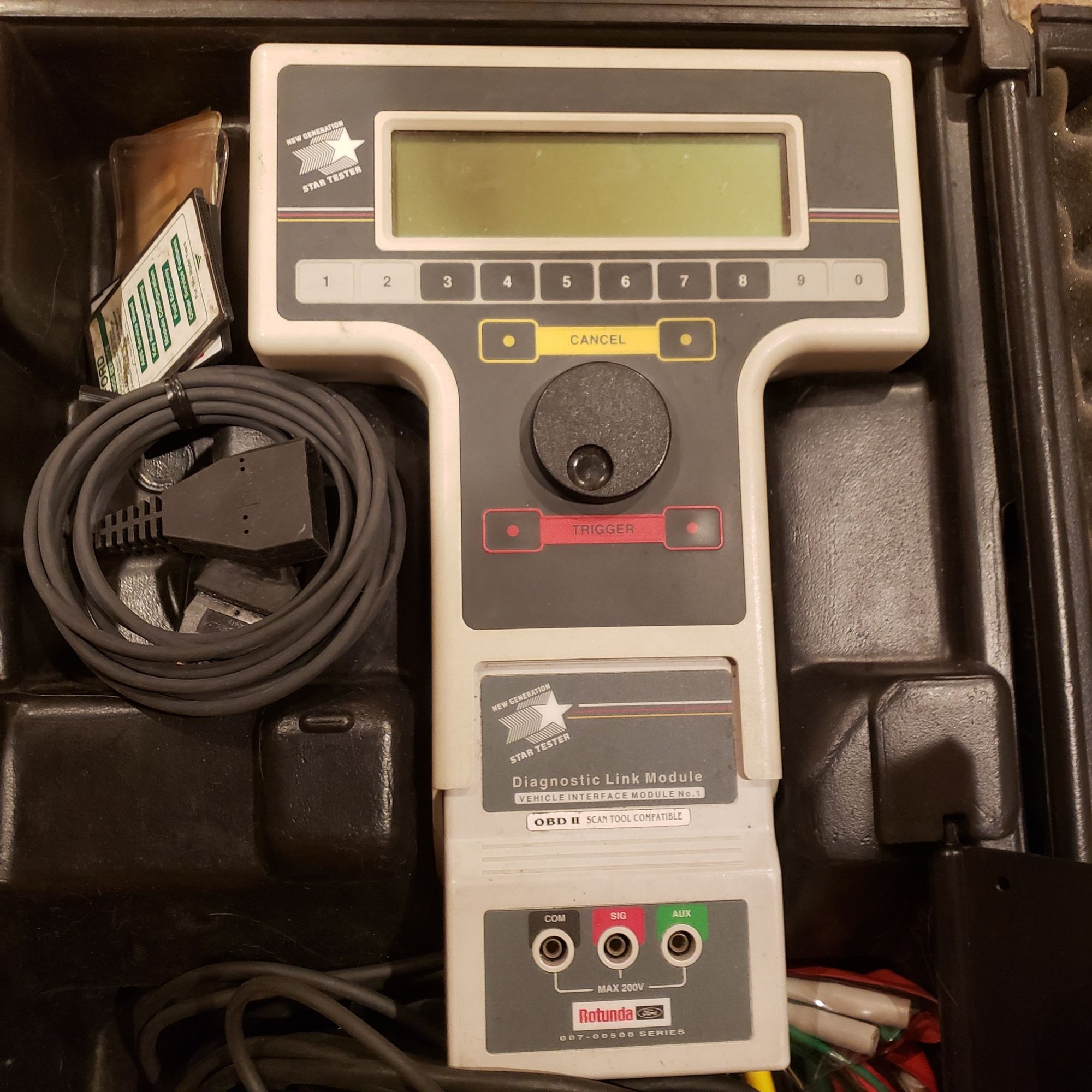

This is THE scan tool for a 1997
If a NGS reports back 111-10-111
THEN you have NO codes

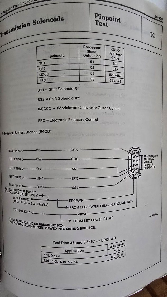

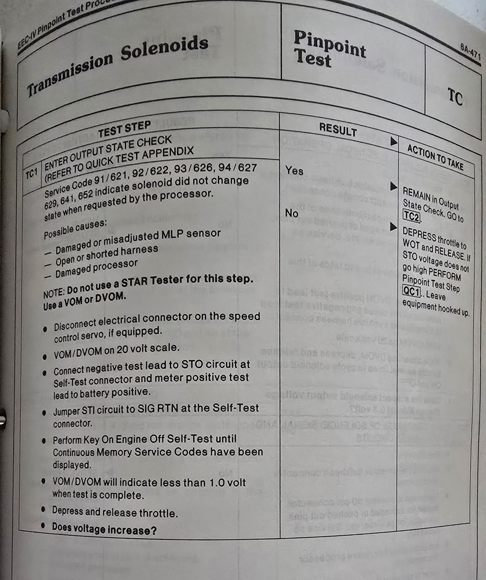

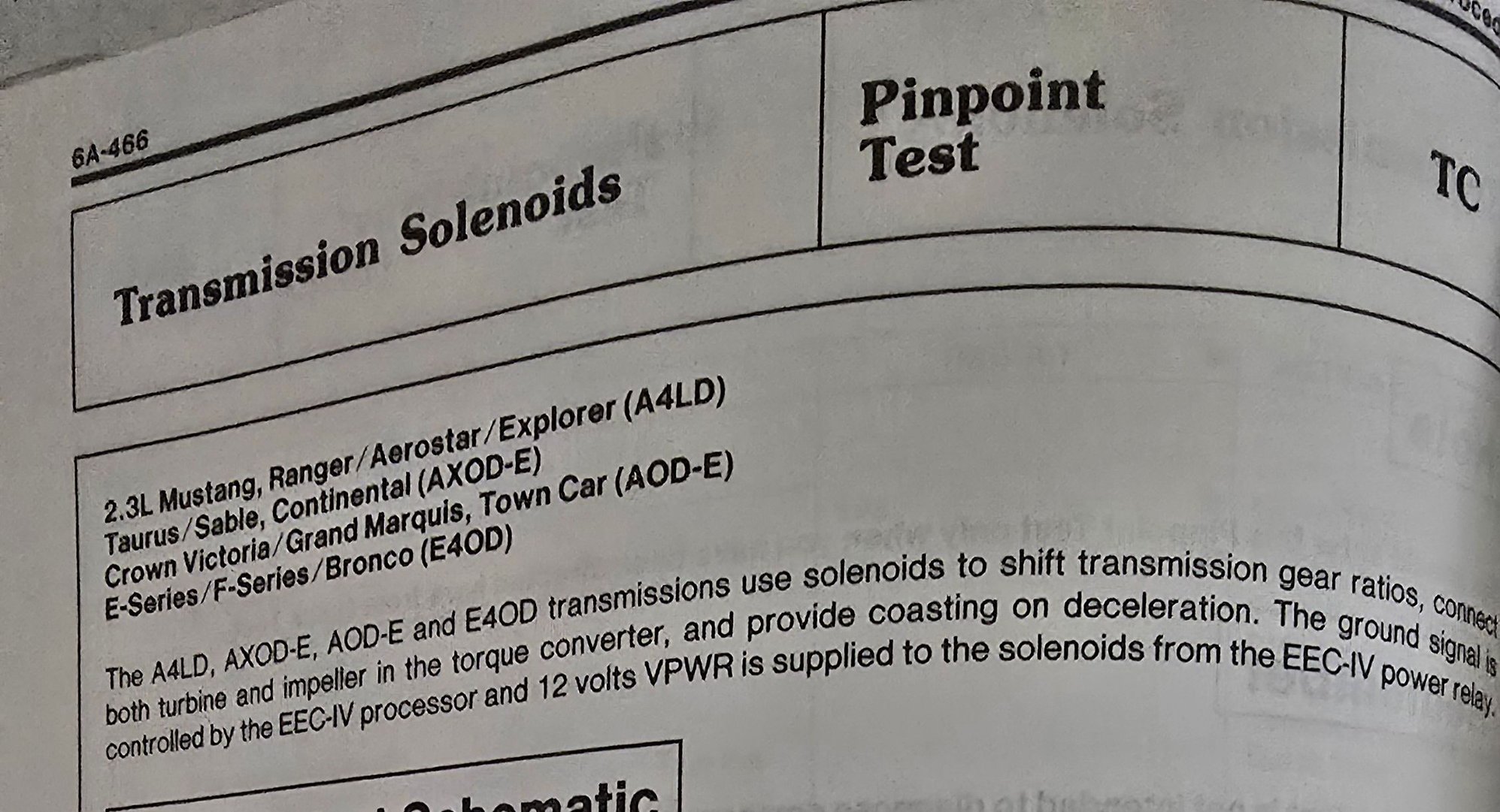

Do you want any of the diagnosis pinpoint tests for the codes out of the PCED?
I can get you started but you need a 1997 PCED and I have a 1992 and 3 and 4
However, the codes and pinpoint tests will be similar if not the same
Here is 4 pages out of the 1992 PCED
Note they say not to use a star tester
By '93 they were all over us to use the new generation star
You can do the test needed with a DVOM
If you come up with an answer for pinpoint test TC1, I'll post more if you want

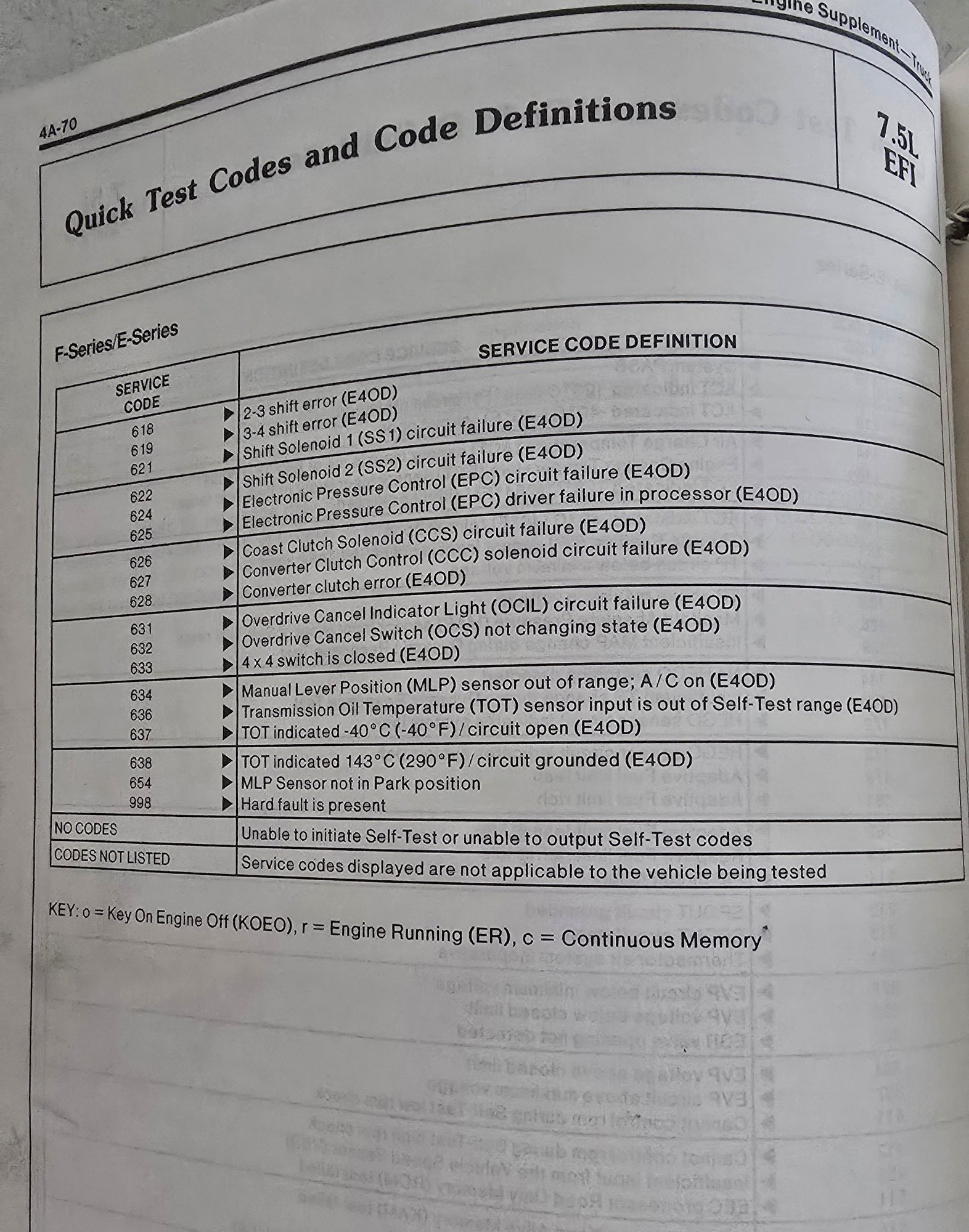

Sorry it took so long to reply, I have been busy with work. When i originally scanned for codes I used one of those junk scan tools from Autozone. I had to order the Ford adapter for my Snap on Solus which has the capability to scan the truck. I was able to scan it today and have the following codes KOEO 654, 633, and 622.
622 (O) Solenoid/circuit failure – shift solenoid 2 – Transmissions
633 (O) 4x4L switch should be in 4×2 or 4×4 high for the test
654 (O) Transmission selector not in PARK – Transmissions
Did you have your trans in neutral and your t-case in 4 low during the test?
622 is the place to start. Failed plug or solenoid probably.

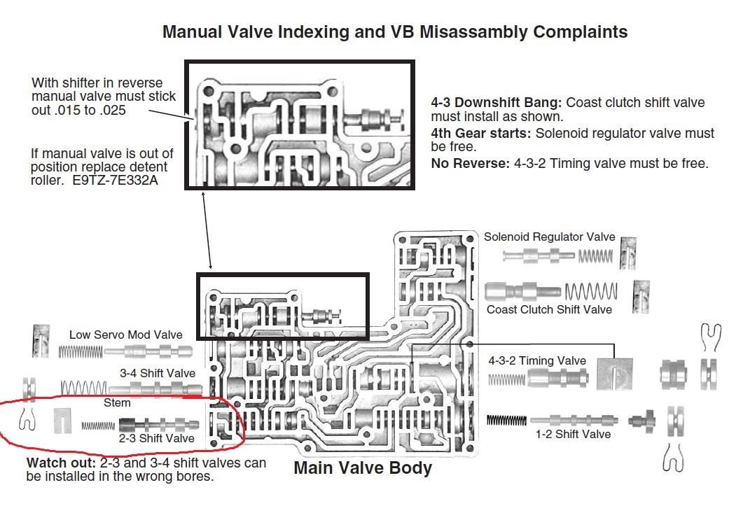

E40D: The Importance Of A Clean Trans Harness
