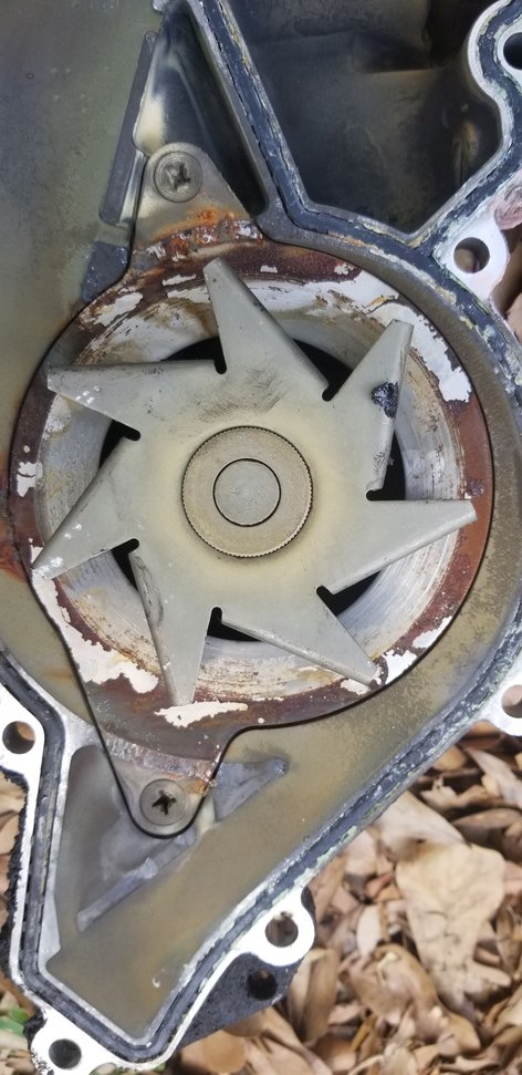

I pulled the Excursion out of the garage to head over and take care of some stuff on one of the trailers, but went back inside to grab my sunglasses. When I come out I notice a small pool of liquid under the truck..and sure enough, it's coolant. I go ahead and pull it apart and look at the receipt for the warranty. It's from the summer of 2017, but there's probably only 35k+- miles on it. Get it all clean & buckledup hoping this pump last longer. It was a good opportunity to get the billet aluminum thermostat housing put in place as I've been putting it off for years given the possibility of snapping those 3 small bolts.
I moved on to the F350 thinking I'll try the billet aluminum housing on it. If it snaps off I'll pull the pump, clean it up, paint it, and re-install. None of those bolts would budge, even though I put some penetrating oil on them. When I pulled the pump I noticed it did have a bit of play in it, though it wasn't leaking, but has been on the truck since 2009 when it was replaced under warranty 140k ago. When I get the pump off I see where the impeller had been scarping into the back plate of the pump...the front cover on the truck looked good, no scraping. The thermostat was toast too as the center rubber seal was all caught up in there so I'm assuming it never was really completely closing. I ordered a Gates water pump and a thermostat with the one piece gasket that fits around it to seal the top and bottom. I also noticed the belt on my truck was beginning to crack on the groove side of the belt so I ordered the Gates K081213HD green unit. This belt is about an inch or so shorter than the ones on the trucks now, but when it got here and fit with no issues I ordered another given the age of the one on the Excursion and they both seem to have a chirping bird in the engine compartment. Found a good deal on them for anyone interested...
Amazon Amazon
So far no leaks on the billet aluminum housings, but I did use a small bit of Permatex Form a gasket around the outside edge surfaces. I also put some ant-seize on all the bolts and even the large fan clutch nut...hopefully won't have to do this again for a while, but I was really worried about the bolts on the F350 pump given they'd been in there for so long. Interestingly everything came apart easier on the F350 than it did on the Excursion.
