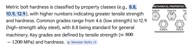

I think that 12.9 is the thread pitch not the grade as you see different markings on the heads of metric bolts like 8 or 10.

On metrics, the thread pitch will be something like 1.00 or 1.50. They have their own hardness scale, they don't use "grade 5" and "grade 8" like we do.

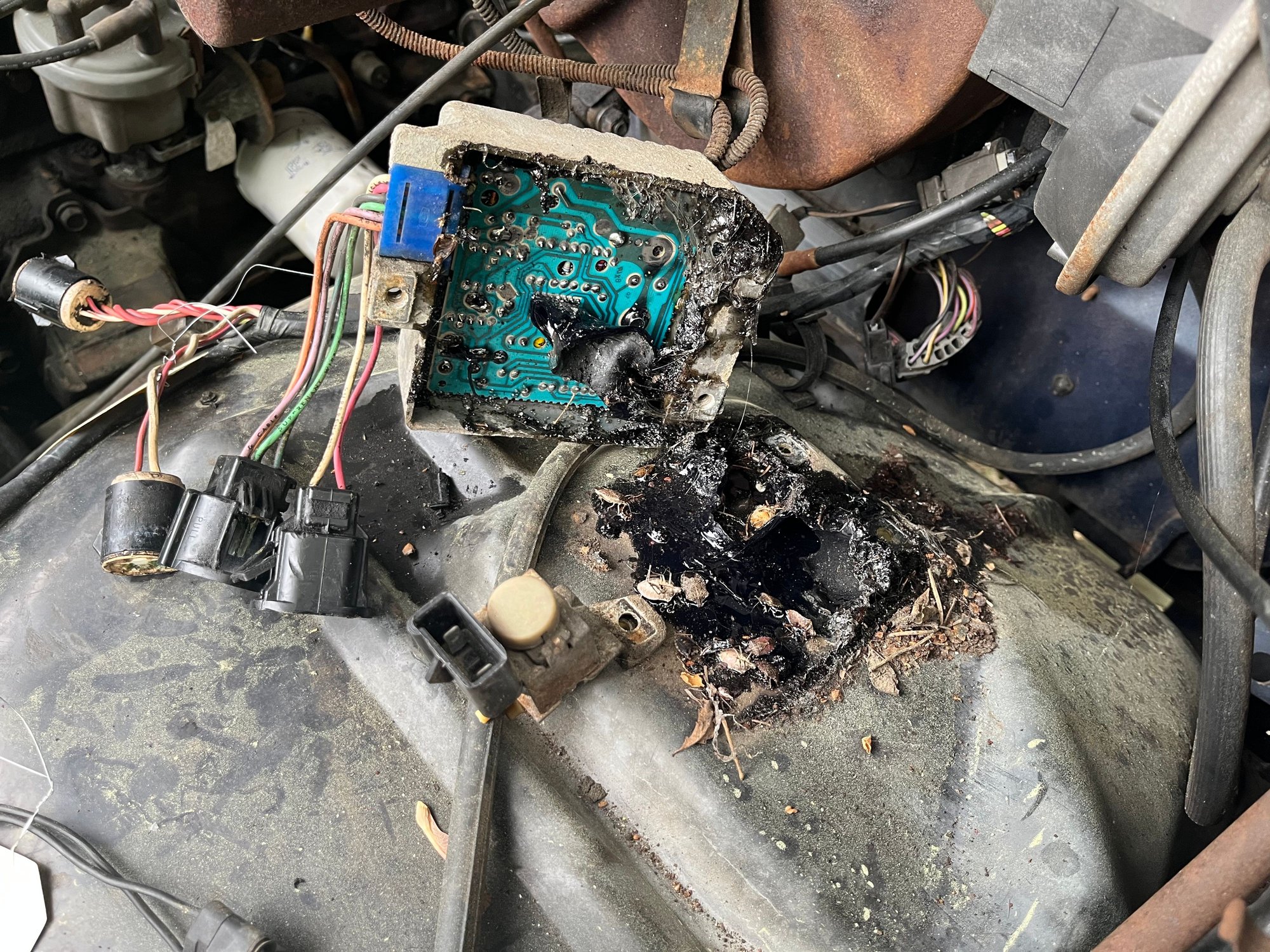

My truck also had the box leak it's potting all down the inner fender and onto the house garage floor
It still worked and I have it as a back up somewhere safe but dont ask me where
There is nothing wrong with the DSII system and is just as good as the HEI distributor.
I seen a factory DSII run in the 11's in the 1/4 mile and 10's on spray till the plugs melted because the gas solenoid failed

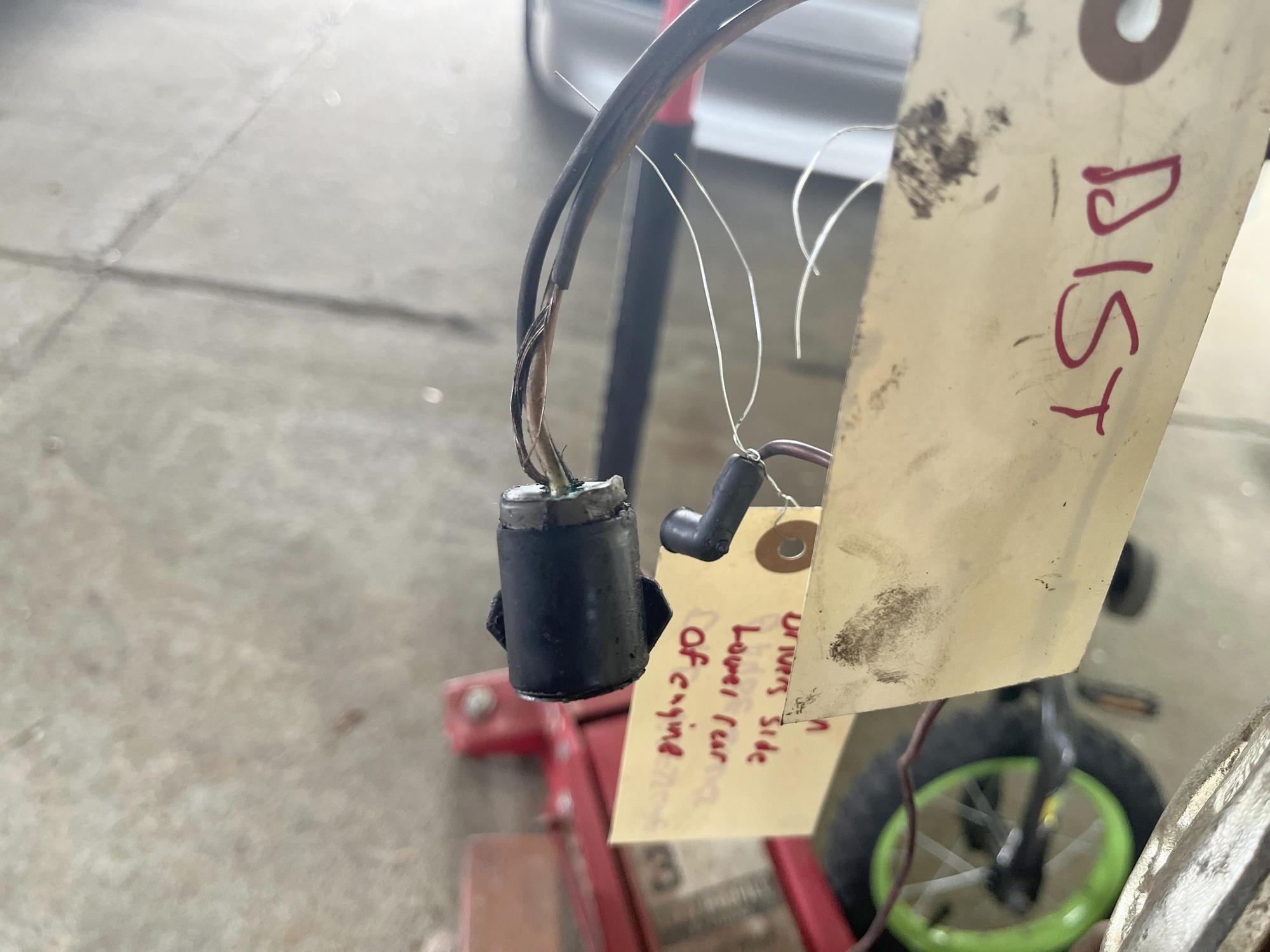

Oh forgot to show this picture. This was the distributor connector in the parts truck. This was a running working engine. One of the leads is skinned back and frayed for a good 3 inches.
Whatever work was done to this truck originally to put the red dash in here in the first place, they did a **** job on the insulation mat & all that stuff. And now that's it's sat this way for years, it doesn't want to easily go back into place. I tie wrapped the corner up to hold it closer to being in place and let it relax a little. After a few hours I was able to straighten some of the wrinkles. I got some of these automotive style interior panel thingies from the hardware store. They come in various sizes, I got the ones made for 1/4 inch hole with a 1 inch wide head. Drilled a few holes to hold the rubber in place and seems much better. At least now I can clean it.

They say you can get them plugs / pig tail from NAPA but I have not tried.to get any.
Also what shape is the ones we pulled out of the truck? Can you cut and splice it, solider and heat shrink, it to that harness?
Again I would try and keep the DSII IGN system as I have never had any issues with them that is not normal like when they start to fail you get no spark.

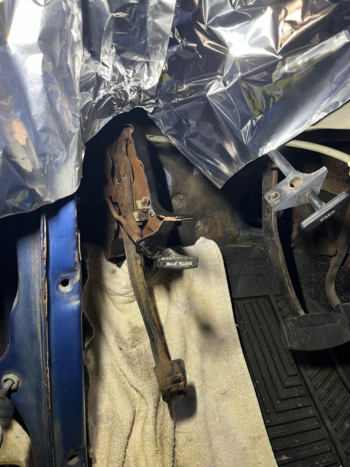

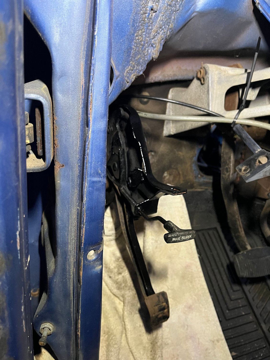

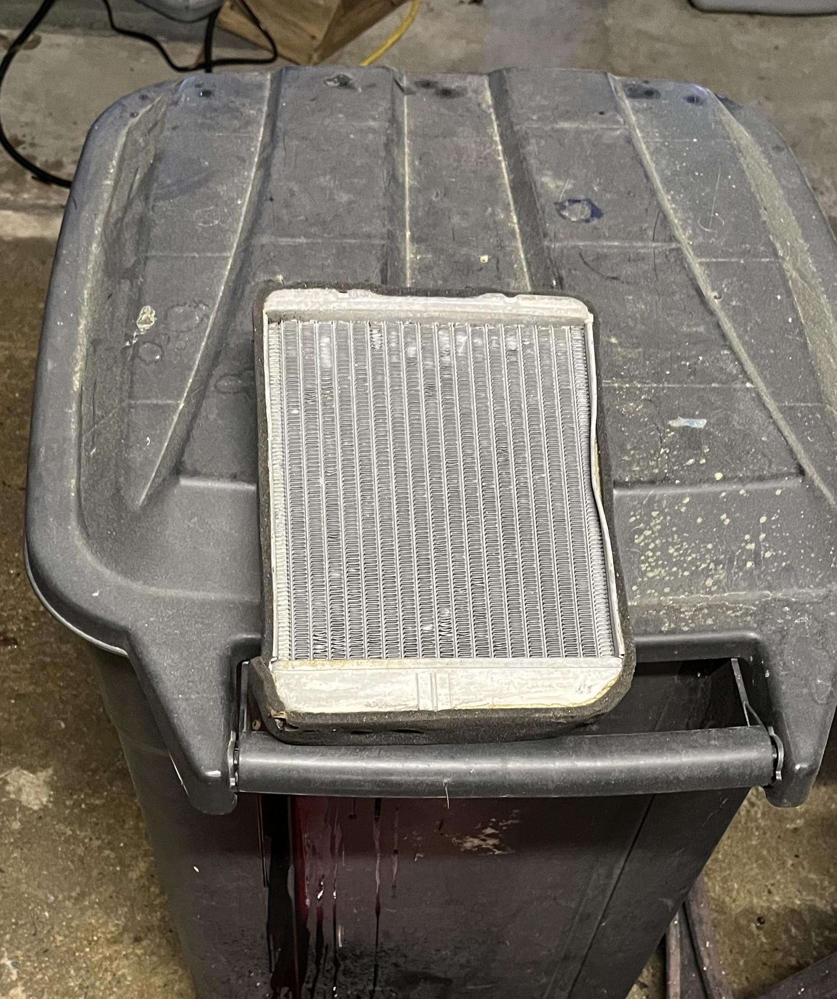

I removed the heater core from the 83, figuring it will never be as easy to replace as it is right now with the whole dash taken out. Well it's a tight fit, it was really wedged in there, but I got it out. When I looked at it, it looks great. I was expecting to see corrosion & discoloration but doesn't have any of that. Now I am second guessing myself. Is an old part that still works better than a brand new made in China part?

John on the heater core the new ones you get do not fit the housing.
I think they fit the 87> housings and they must have made a little change so the new cores dont fit our trucks.
Thing is they dont list a different part number for the core that fits and the one you can get everywhere.
I know there was 1 place I think on Ebay where you could get the right one but the wait was a week or more.
I stuffed the wrong one in my truck, had to as the old one leaked, and ordered the right one but have not installed it over a year or more

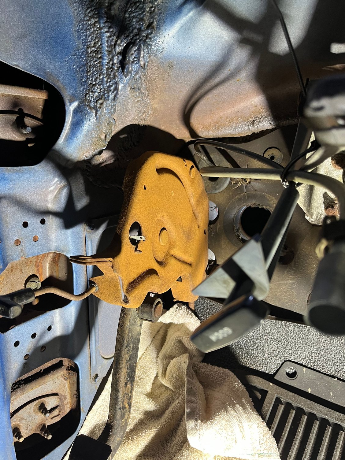

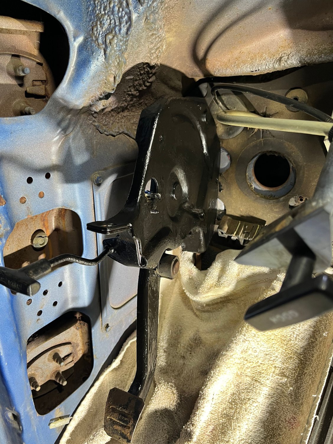

This parking brake assembly was very rusty. I went over it with a wire scrub brush and then coated it with zero rust.
Back side is rusty too, but there's no way to get in there with a paint brush. I sprayed it with rust converter, let it sit for 24 hours per instruction, then sprayed rustoleum as best I could.
After letting it dry for several hours, I sprayed all the moving parts down with PB blaster. I didn't want to do it before trying to paint because I'd play hell trying to get paint to stick if I had sprayed any kind of lubricant down first. Now it goes up down easily and works as it should.
