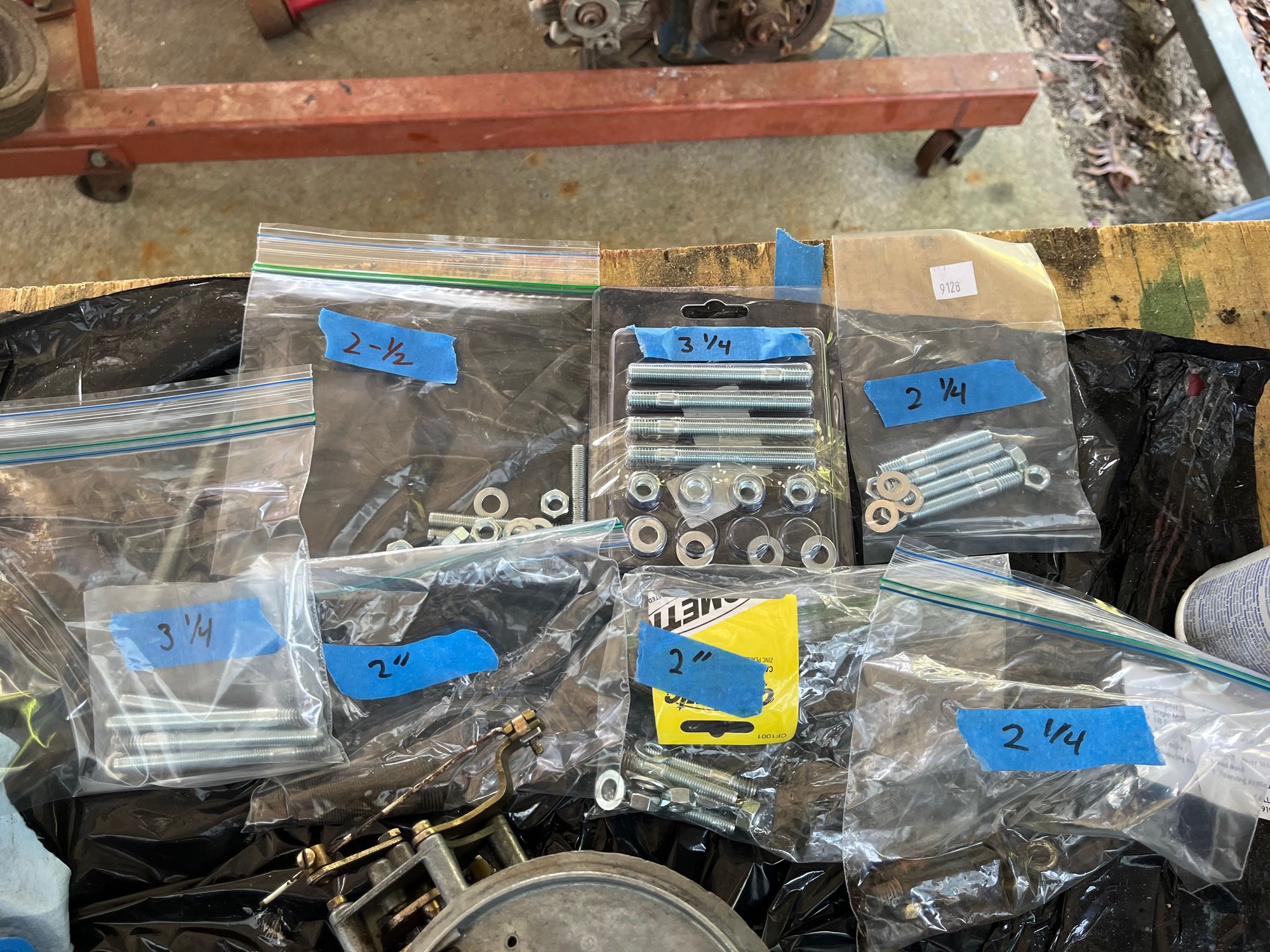

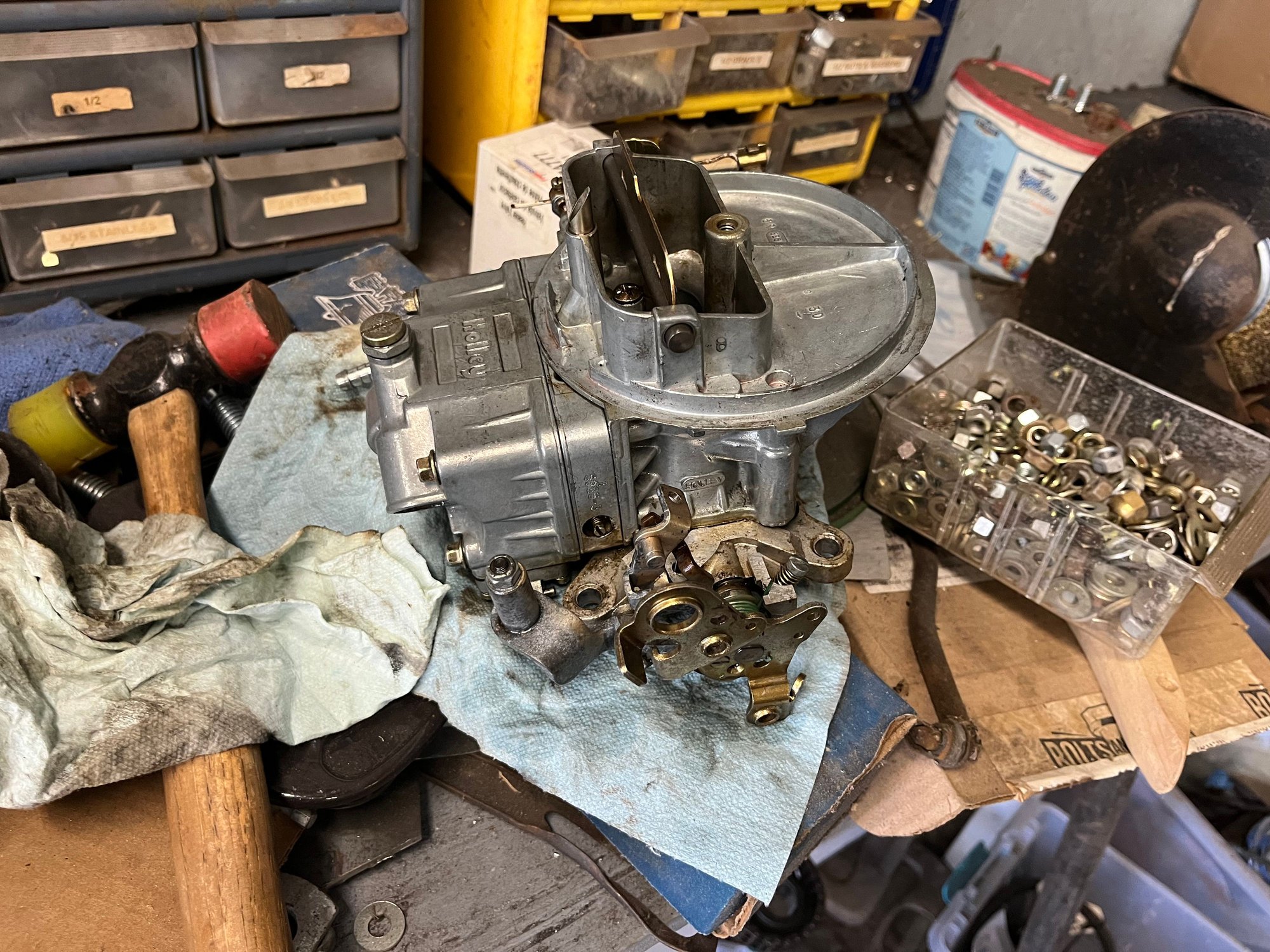

The 8-ball was on my safety shut-off bar behind the tail light:
Well my intake manifold swap project is underway, but not completed. I am pleased to say everything came apart with no problems, nothing seized, but I did find that the intake manifold bolts were not tight. All of them were "one-hand" loosen with the ratchet, at no point did I need to put any effort in it. Also I figured taking the plug wires off the drivers side would allow me to move the distributor cap out of the way and make more room, and when I did that I found that 2 of the 4 spark plugs were loose enough to turn by hand. So I tightened them and need to check the other side as well. Andre has ribbed me plenty for not bearing down hard on bolts and just "snugging" them and I have to admit this might prove his point.
True to my prediction, I had to leave partway through the job to go chase parts. I needed some stainless lock washers for the valve cover bolts, a flange bolt for the dist hold-down, a new fuel filter, and some oil & filter because I figured this will be a good time to do my oil change. That killed more than an hour but when the time came to put everything back together, I found my RTV was just a ball of rubber. Randy was over at the house and said "wait here" sped home and got a tube for me, said anytime I need it to let him know because he gets as much as he needs through work.
The intake valley looks great, that red glyptal I used in 1994 has held up well.
I didn't do anything to the carburetor as the Holley 500 has been working great, but I did put in a pot with some kerosene and scrub the funk off with a toothbrush.
I was not able to install the carburetor yet, as I don't have the right size studs. I estimated what I thought I needed but I was at least 1/4 possibly 1/2 off. I have bag full of studs in my carburetor box, but they are all either too short or too long!3 inch long studs should be perfect. I called O'Reilly's to see if they had what I needed; they said would have to order it; $4.99 for the stud kit, $15 shipping, and would not be here until May 7. Wow. So I ordered them next-day on Amazon for $8 so some time tomorrow I should have what I need to finish the job.
If you ever need some carburetor studs let me know, I have quite the collection going.

I will keep you in mind if I need carb studs, looks like a nice collection and again just not what you needed.
For the Javelin I used threaded rod to make the carb, hot air choke assy. in the manifold and Tstat housing studs.

On the studs I would take the ones you just got and cut them to the size you need.
The short ends go in the manifold so thread a nut down past were they need to be cut, measure, cut and round off the end and the nut should come off but if not it will fix the threads.
If all I had was threaded rod then I would use it like I did but nothing wrong using the studs and cut to size.

I definitely should have just cut 1/2" off the longer studs and gone that route, but it's funny when you're in it you're so focused you missed the obvious solution. But the threaded rod is in there and working fine so I'll leave that part alone for now. The only downside is that with the studs that are made for it you have fine thread up top and use the small nuts that take a 7/16 wrench which fits better in a tight spot, vs the full size 5/16 nuts which take a 1/2 inch wrench, but my space is not too tight and I was able to get them on with no problem.
