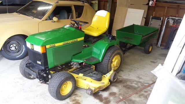

Picture of when I first got the tractor

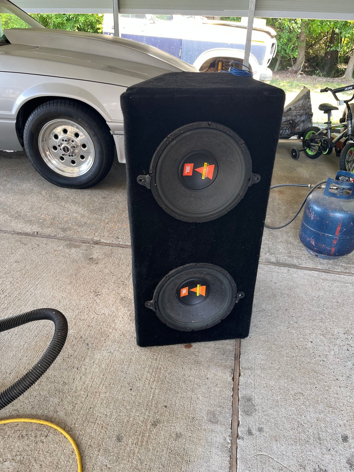

I wanted to take some stuff to a swap meet tomorrow, but I went down a rabbit hole and burned up most of the day. I got this big heavy sub box out of my workshop attic, I bet it weighs 100 pounds and is big / awkward to move. I wrestled it all the way down the attic stairs brought it around to the carport to clean up. Only to find that the amp won't power on! This was in my son-in-law's cars when they lived here, probably 12 years ago. I couldn't remember why he removed it from his hatchback but now it makes sense. Instead of cleaning my truck and car and gathering items for the swap meet I burned so many hours on this and my back was killing me by the evening, so I'm just going to play it by ear tomorrow.
Dual 12" JBL's but I think the 1200 watt amp is blown.

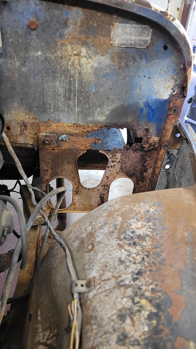

Removed the battery tray as there is a good size hole in the firewall that I need to fix and also removed the shifter & Ebrake handle.
The plan as of now is to use fiberglass mat and POR 15 as a rosin and put that down first. It should bite into the old rusty metal and help make it a little more solid.
I can run it up the rear lip where the rear floor comes down to the front floor, it is rotten all the way across, and I can also run it up the toe boards as there are holes there too.
Then I will use the metal over the glass with angle iron across the rear floor to rear wall and at the door openings as that is all rotted away.
I will also use the metal on the toe boards and the firewall hole. I just dont know if I will glass over the metal around the edges to seal it and in place of screws or screw it to the glass under it or maybe both?
Oh I cant weld anything in as there really is not anything to weld to the rust is that bad. Did I tell you the thick patch that was on the right side floor rotted just as bad as the floor!!!!
The floors got pushed up into the cab and bowed the floors and why I had to pound them back down after I lifted the body off the frame.
Being from New England rust does not scare me but figured moving south I would not be seeing a lot of it

John, How much are you asking for the sub box? I recently gave mine (much smaller) to my neighbors kid who wanted something to bump in his little pick up.

James I put it up for $200 but I would take half that. I just wanted to make sure I gave myself wiggle room. Here is the listing with more details:
https://www.facebook.com/marketplace...0514152922330/

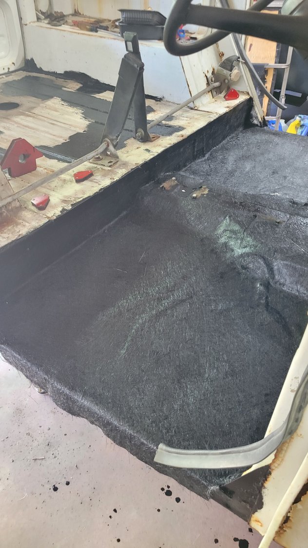

Went out easy this morning and did a little more on the DJ.
I got to thinking I am going to need to move it out so I can get my sons pickup in to rebuild the front end on Friday but the way the body was jacked up & supported it could not move.
If I was to lower it back down it would push the floors back out and I did not want that to happen. Also if supported a different way I could work on the rockers / bottom of the door opening and not have a high lift jack in the way.
There are 2 braces from the firewall to the frame and I was able to stack 2- 2x4's between this brace and the frame and have room between the frame and the floors where the mounts are a win win!
Once I got that done I removed 2 brackets that look like they keep the doors from flopping out at the bottom. This way I can run the fiberglass & metal over that area and then drill out the holes to remount them.
I also found on the left side the rear of the rocker / door opening had come loose from the body. The metal was still in good shape so I ground away the rust drilled a few hole to "spot weld" the rocker to the body and pulled out the welder and went to town. To do this I had to rig up something to push the rocker back up into place. I also found the front side was broken so welded that too.
I will go back out and start to fit the fiberglass mat to the floors on both sides and get them installed so they have time to dry before I lay the metal over the glass.

POR15 and fiberglass mat to seal the rust and cover the holes that were many. I forgot to take before pictures
I will let that set up and cover it with metal that John brought over. I will also have to use angle iron to it to add strength like from the floor to that upright to the rear floor.
There was rot all the way across so the floor was not connected to that rear part.
Also the floor went under that part and there was a body mount there that was not holding anything.
