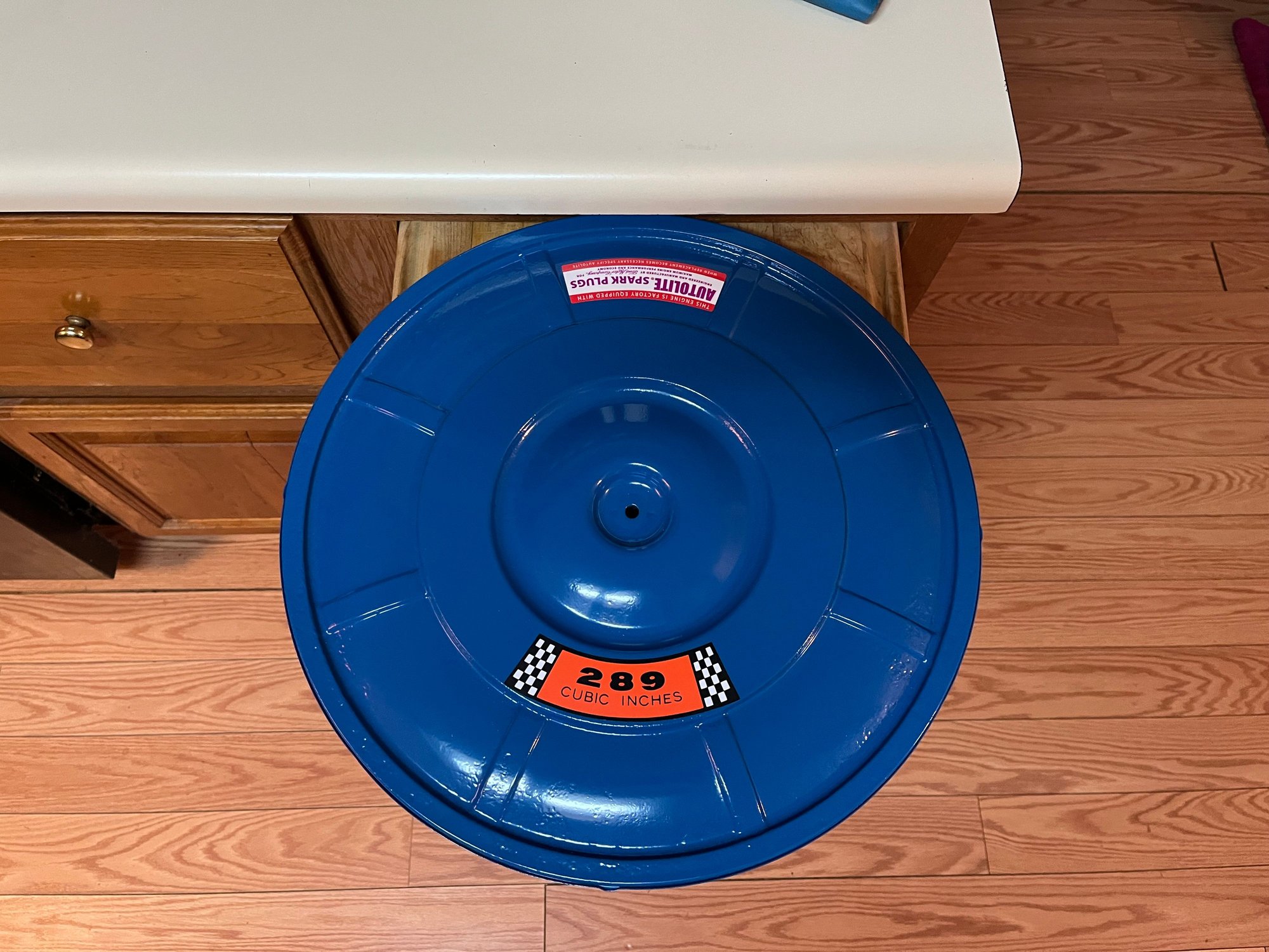

My new air cleaner decals came in the mail yesterday evening, so I put those on this morning.

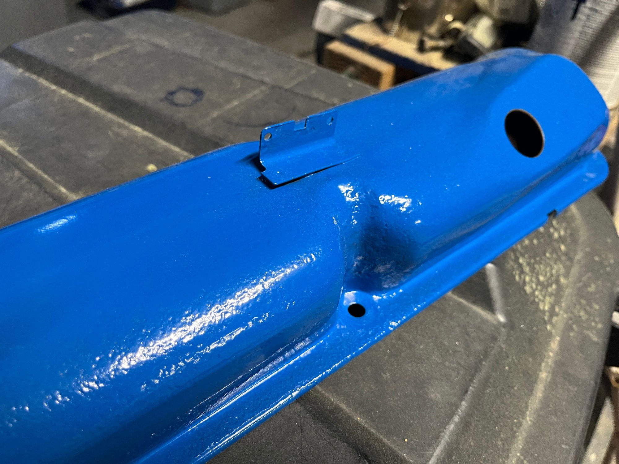

One of my freshly powdercoated valve covers, I saw this tab is up. It's always been this way as long as I have owned the car but it slipped my mind. I wish I had noticed / thought about it before sending it to the powder coater because I could have clamped it down and tack welded the edge to keep it in place. Oh well it's too late now.

To bad about the valve cover tab but the stickers look good and everyone will be looking at them not the tab.
Besides once you have the plug wires in place you will not even see the tab.

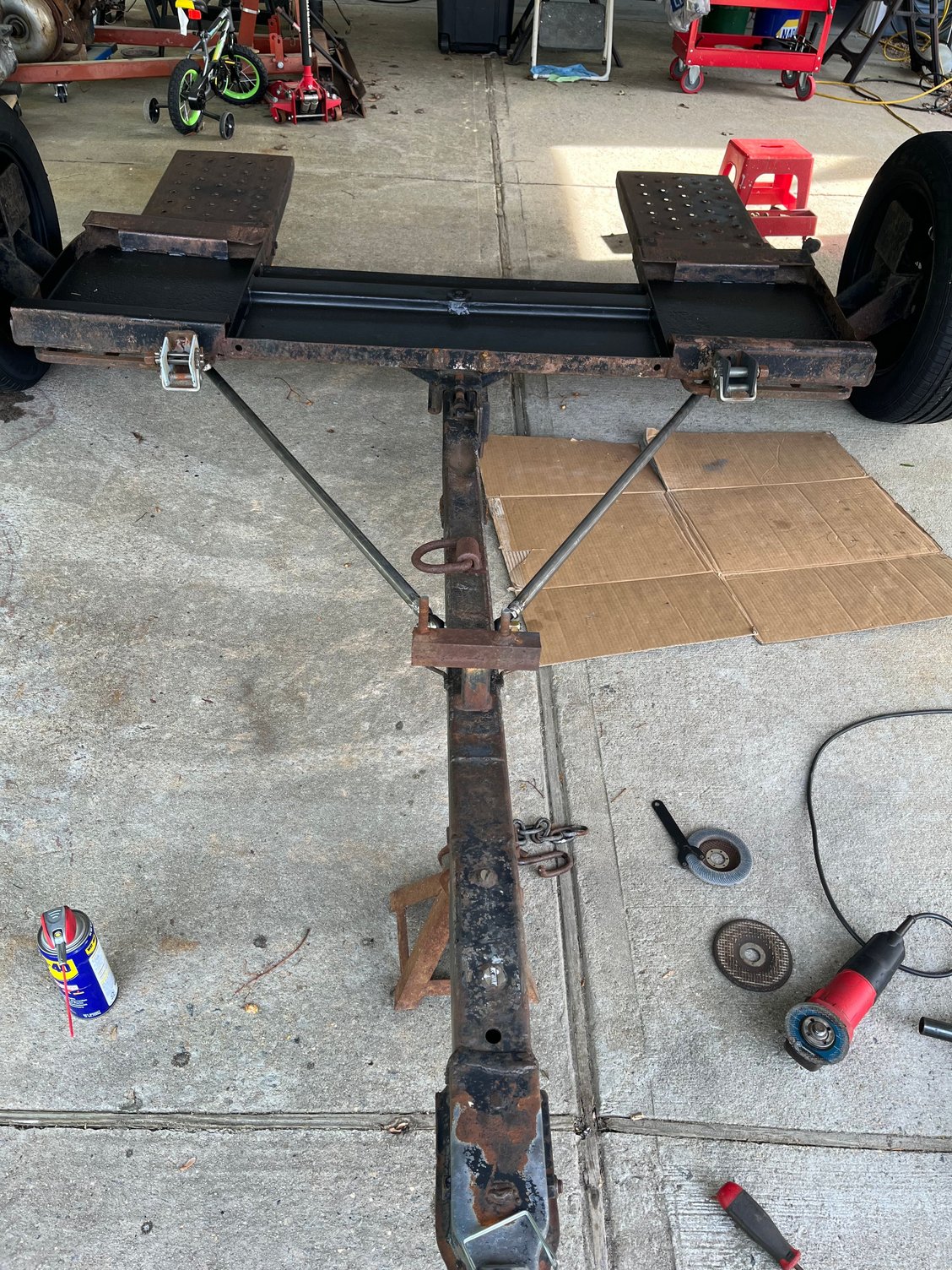

That tow dolly is coming along nicely. If you make it too nice you will not be able to use it as it will be lent out all the time

Dave your day is shot today like mine was yesterday! I am hoping I have time to go get my Mustang and wash it so as to be ready tomorrow morning, but it is looking like that won't be until later in the afternoon or early evening. I've been sanding and painting ever since it warmed up today, I guess around 10:30 or so.
I was back and forth about this last year and finally settled on black, but now that's closer to paint time I'm up in the air again. A red trailer would be nice and would kinda "pop" with the aluminum wheels.
Just can't decide...

The red would also match the truck that will pull it
When I had a 2 car trailer it was painted yellow to match the yellow stripe down the side of the truck used to pull it.
I had a smaller 1 car that was blue when I bought it but painted it black, maybe because I had the paint left over from the trailer I have now?
The one I got now was black when new when a buddy bought it so I just repainted it the same color but did the fenders in silver to be different along with the storage box out front.
From sitting it needs work first is tires if I was going to use it, then a good cleaning and paint job, go over the brake system and maybe add brakes to the 2nd axle as it only has them on 1 axle.
