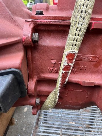

I've made my first attempt to install my transmission to my engine, inline 6 engine and T18 trans. It's only me and my engine hoist and my cat and dog as spectators. They absolutely refuse to lend a paw for help. I was hoping that once I got it mated up I would be able to rotate the transmission into position but it is too heavy to rotate and I'm fighting against the sling.
My next effort is to try to reconfigure the sling so that it lifts the transmission in the proper orientation or close to it. I got it as far as up to the input shaft cover and perhaps a little more but I do not want to whack on the driveline any more than absolutely necessary. Additionally, I will reinstall the shifter so that I can put the transmission in gear to be able to line up the spines with the clutch plate.
Question: Is it easier to mount the bell housing to the transmission first and work with that pair to mate to the engine?

IME, it's easier to have the BH mounted to the transmission, I've done it both ways and it always seems harder to get everything lined up with the BH on the engine, but that could just be my incompetence too LOL.

Success!! Since it was mentioned that both methods were tried, above I decided to have another go with mating the transmission with the bell housing already on the engine. It was a matter of redoing my lifting slings. Fortunately I had another pair and was able to improve the lift such that the transmission was better aligned with the bolt holes and in plane with the pilot bearing. Having it in gear allowed me to verify that the splines were properly engaged as well. The last quarter inch of travel was done using the bolts to drive it home. Very rewarding and no swear words were uttered nor contemplated during this procedure. I would hate to have to do this while under the truck. Getting the slings just right to lift evenly was the key. The whole procedure from changing the slings to installation took no more than 10 minutes.

Well, I got a late start but heeded the advice to remove the transmission cap before proceeding. That was a key bit of experience shared. Thanks. I did this job alone and spent about an hour fussing with the engine and using wood pieces to wedge it here and there and minimize paint damage. I can report back that all in all it went okay. It was a lot of tweaking, lifting, shoving, coaxing and taking my time. It might have been a little easier with an engine leveler, which I have, but this engine is so much heavier than the four cylinders I've typically used it for. With only a standard engine hoist to lift, I don't think this job is possible with the radiator and support in place. An overhead chain hoist I'm sure would be an improvement. At any rate, I'm delighted to have this engine off the ground and back on the truck.
