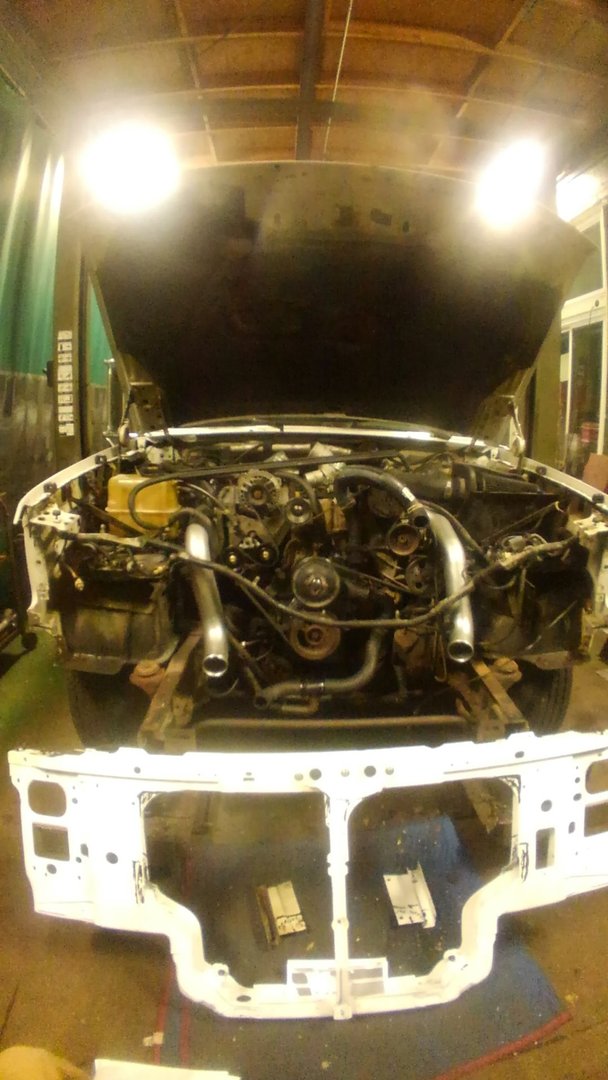

Replacement core support. Shaded areas were removed
Rusty core support out. Getting an idea of where CSD tubes belong.

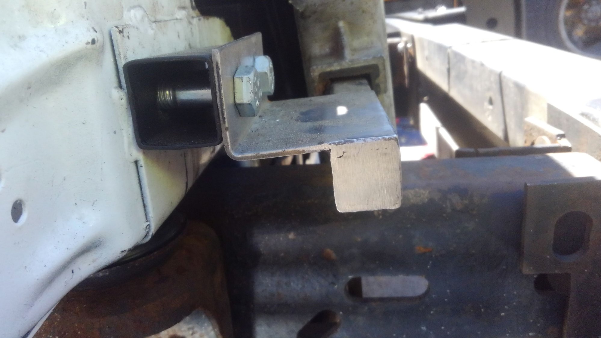

SD CAC mounting bracket
Found I had to extend it

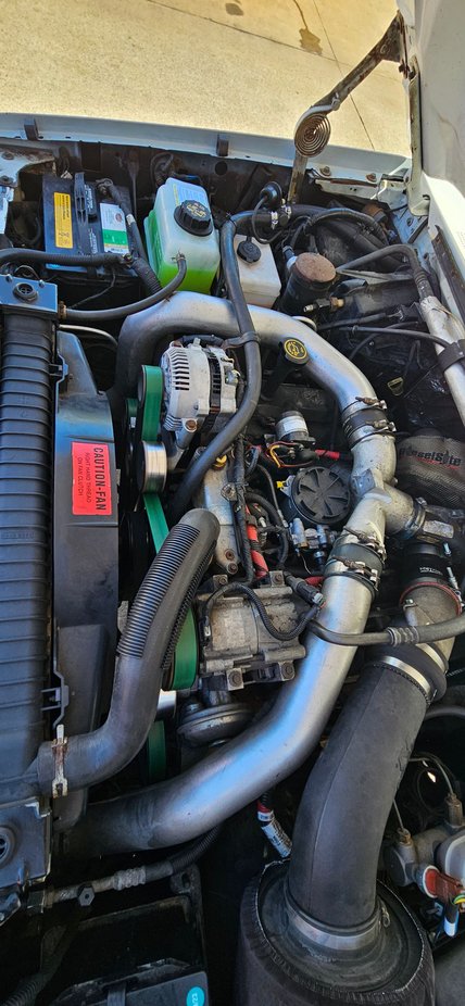

It all fits. Sorry, I dont have more mounting detail pics to share. There is a 6.0 trans cooler in there. Hood latch lever needed to be modded a little. My AC needs to be redone this year, so Ill take pictures when that area gets dismantled.
It all fits. Sorry, I don't have more mounting detail pics to share. There is a 6.0 trans cooler in there. Hood latch lever needed to be modded a little. My AC needs to be redone this year, so I'll take pictures when that area gets dismantled.
Long-time fan. Everything seen in the engine bay, I couldn't have done without your support! Hope this helps. Happy Easter.
