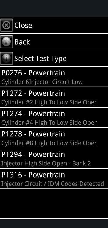

p0276
p1272
p1274
p1278
p1294
p1316

I'm still getting P0276 (Injector 6 circuit low)

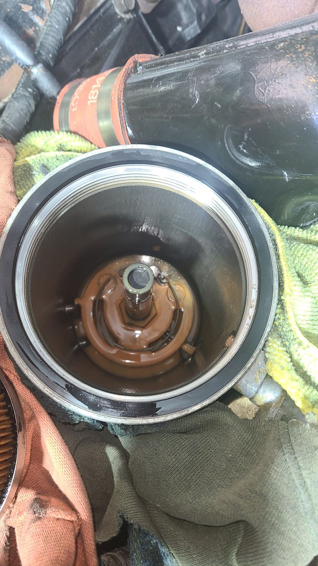

Fixed Problem
Well now we get to see a great example of what happens when you try to revive a motor that sat for a few years without cleaning the fuel bowl. My bad, I should know better. Fortunately I have only went around my block at low speeds about 4 times during all my issues. Lots of idling. That is likely how it survived. Funny how it only affected one bank of injectors though.
This also shows what the '97 7.3 IDM will do when a couple injectors get clogged up. It will shut down the whole bank, make the engine run 'kinda smooth' on 4 cylinders. This would explain the Buzz test as the IDM was configured for 4 cylinders with D-side bank shut off... my theory anyways.
