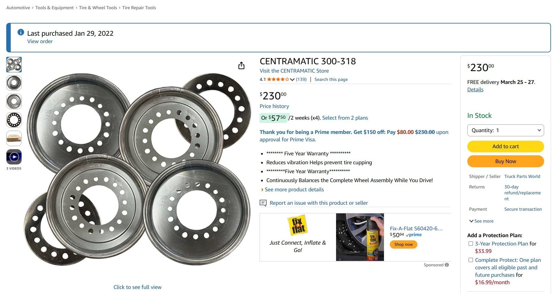

I just went on the centramatic website, and the 300-318 are the only 4-wheel set that will fit our trucks.
They have different numbers for front axle or rear axle pairs only, but the 4-wheel set that fit our trucks is 300-318.

Centramatic said 400-409. She said because I have 20 in wheels. But on their web site it says that number is for 16 and 18 wheels. I also thought 300-318 would fit these trucks. There was also another number in there too but my head is not allowing me to find it now. So it seems like my initial number of 300 318 is correct. Thats 240.00 for a set of 4. The 400 409 is like 245.00 per axle. Thats a big difference in price. Thanks guys I will order the 300 318

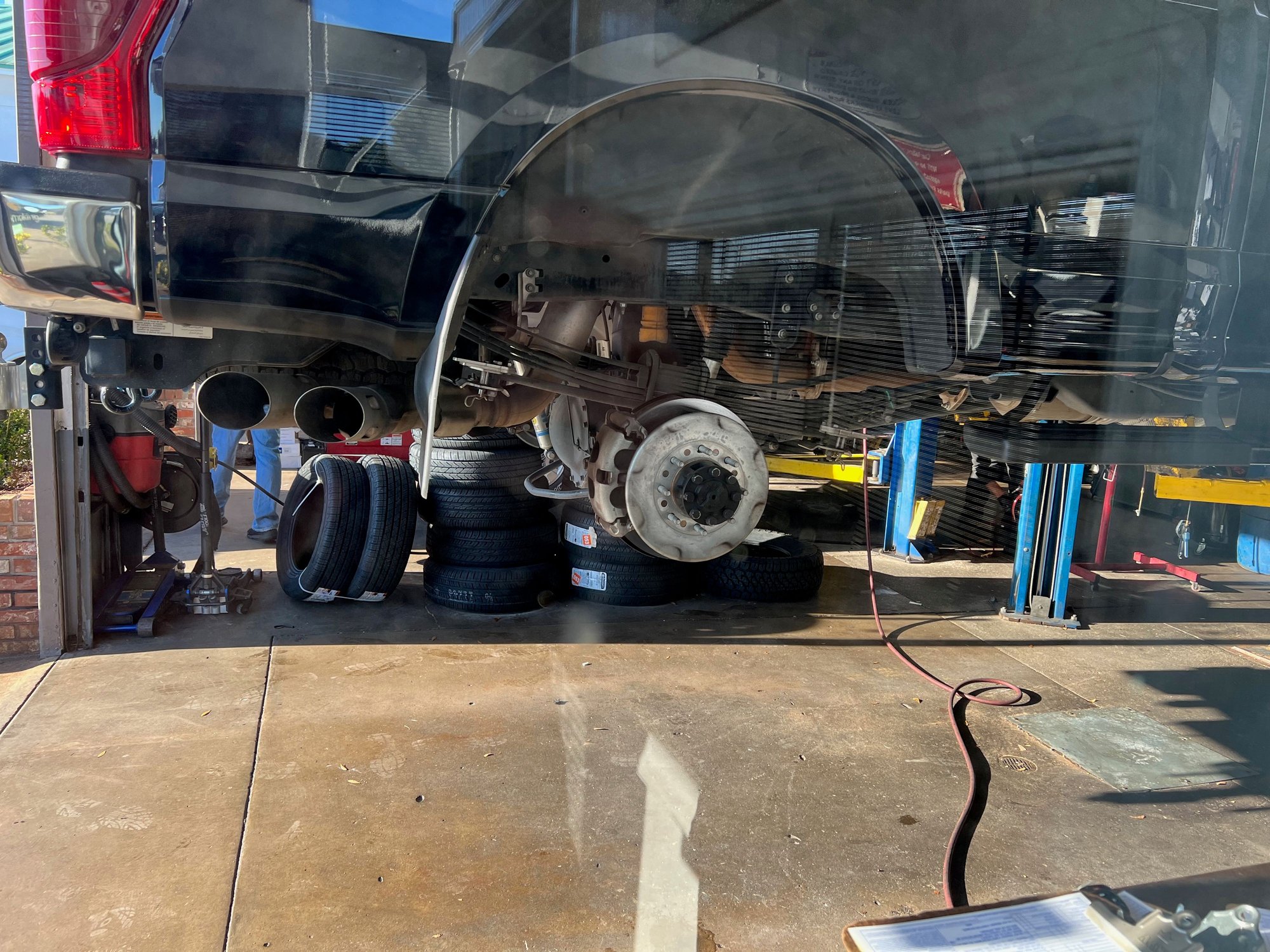

300-318 for my 22 with 18" wheels. I used the spacer up front due to the brake calipers. They did fit a little tight, catching on the threads of the lugs, so I slightly drilled the holes out a hair more and now the glide on perfect and smooth.
If I recall, a long time ago there was a thread about them in which someone mentioned a different number from the 300-318, but it was something like only a number or 2 different... I don't recall now though. But I can say that the 300-318's will work!
This is about the only pic I can find of them... this was when I was at the shop getting my new tires installed!
