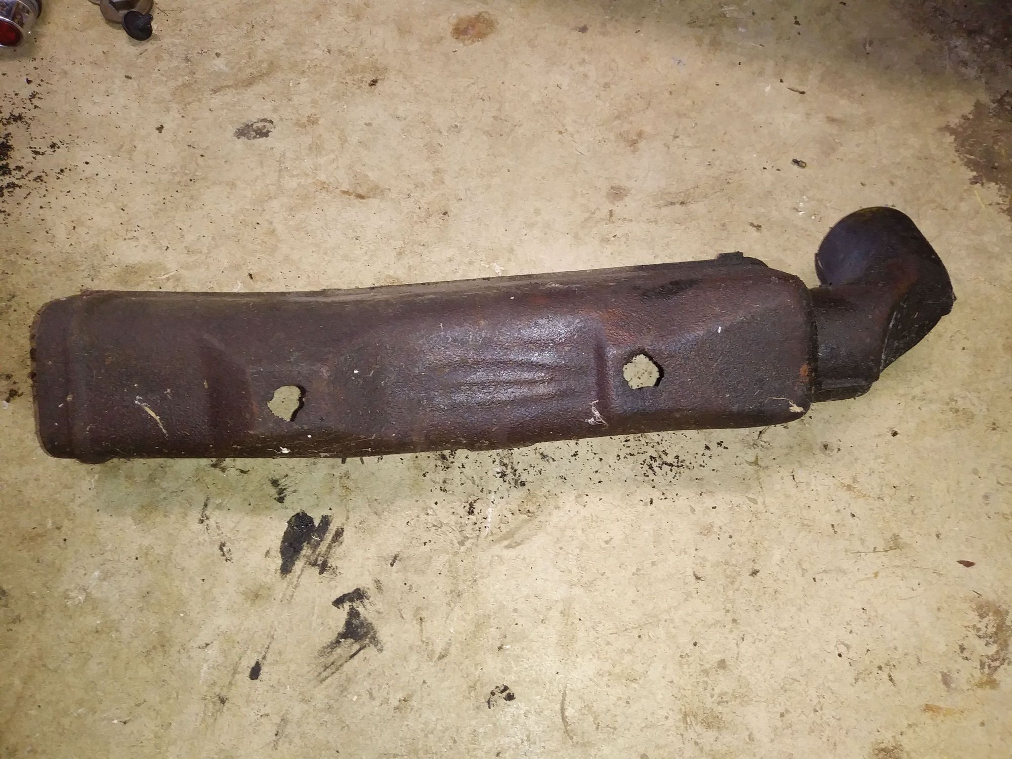

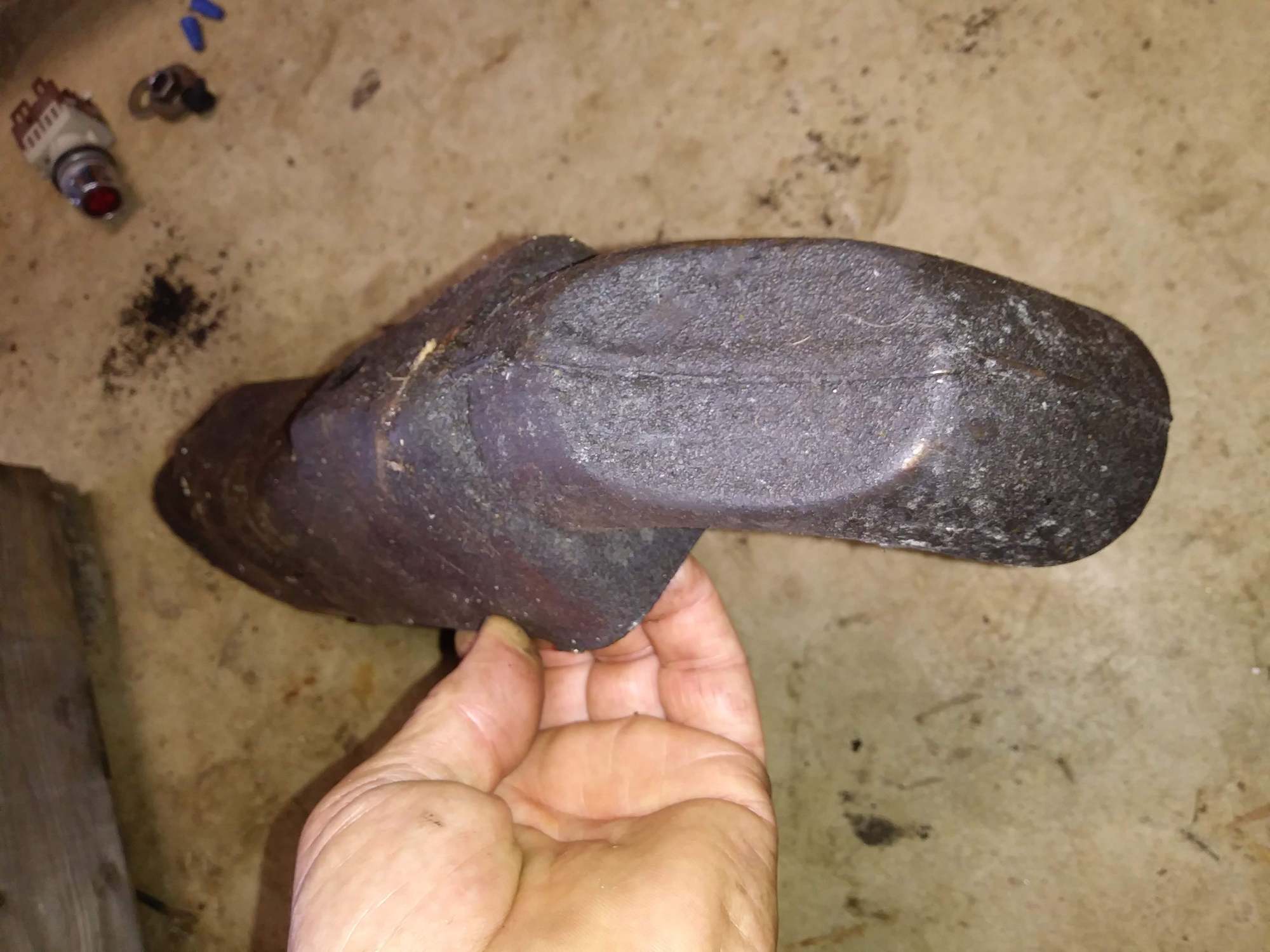

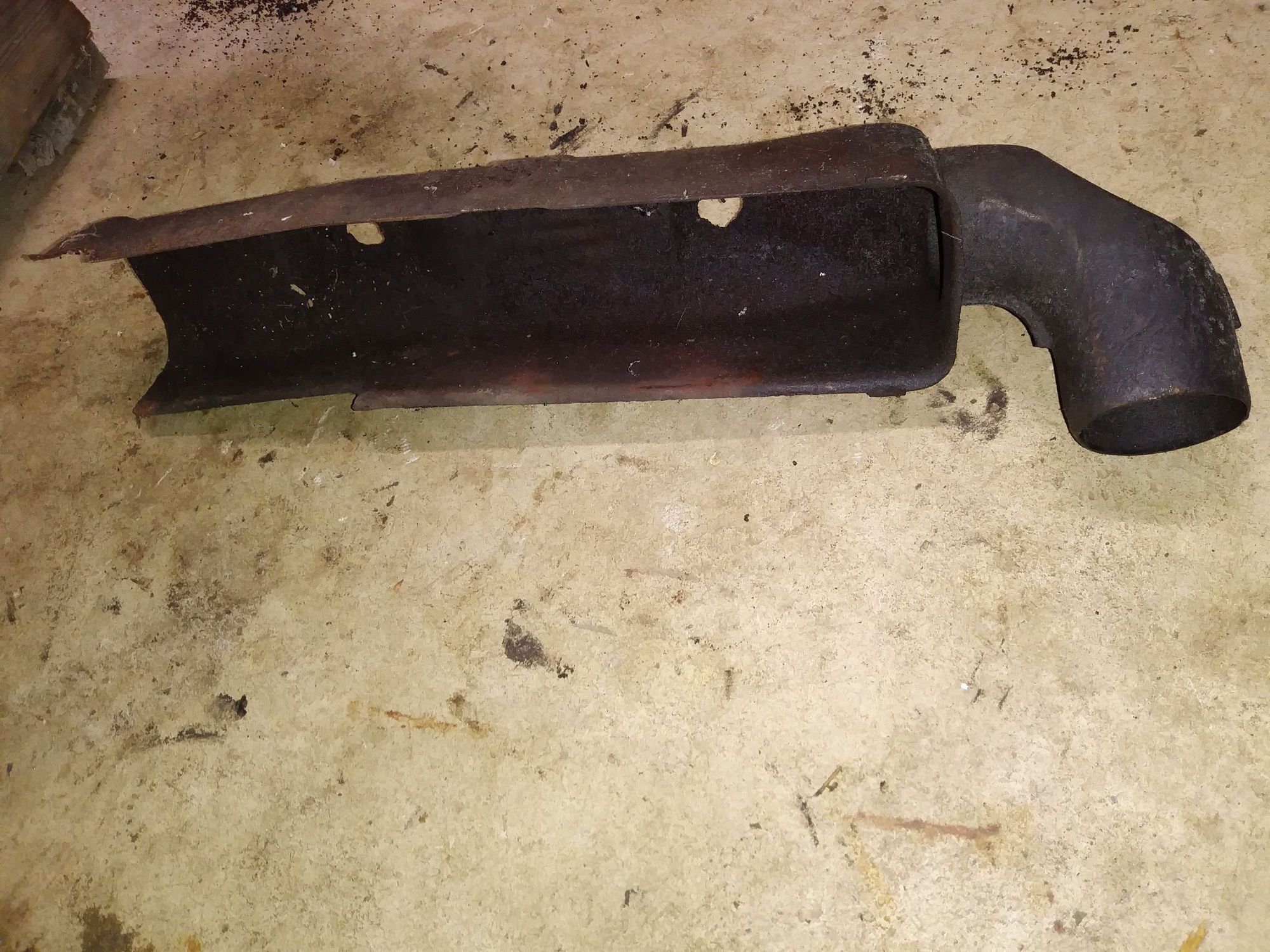

Well I thought it was a heat shield but seeing it off the motor it is not LOL
I am also guessing them holes were where the bolts were to hold it to the manifold.

Have we established it is the exhaust heat stove for the intake? Just making sure we are all on the same page. If those holes are where it mounts, and you can actually get the bolts out of the manifold, I think I would weld fender washers to the stove and bolt it back in place after a little high temp silver paint.

Y'all are right. It is the heat stove. That's a relief
