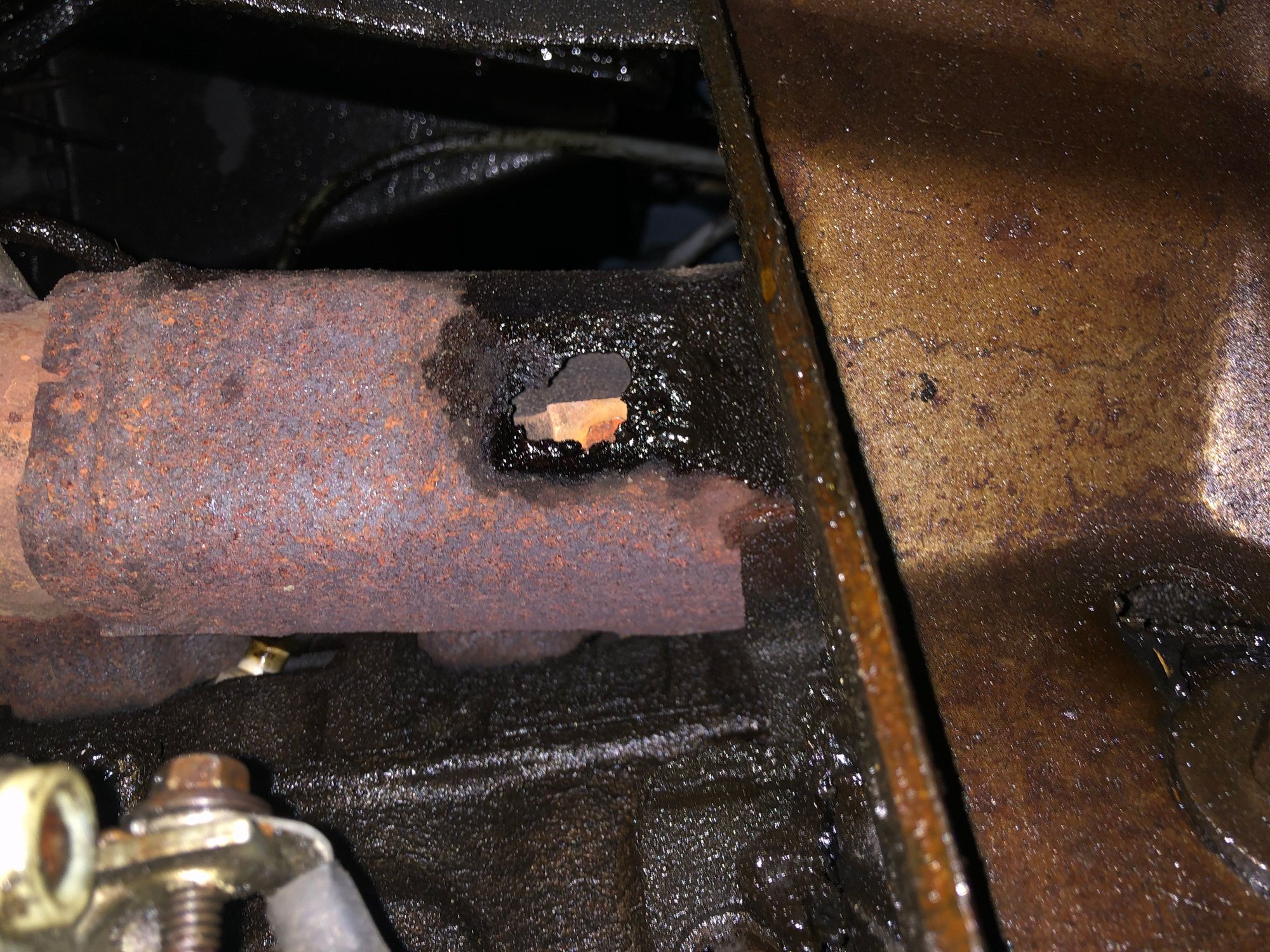

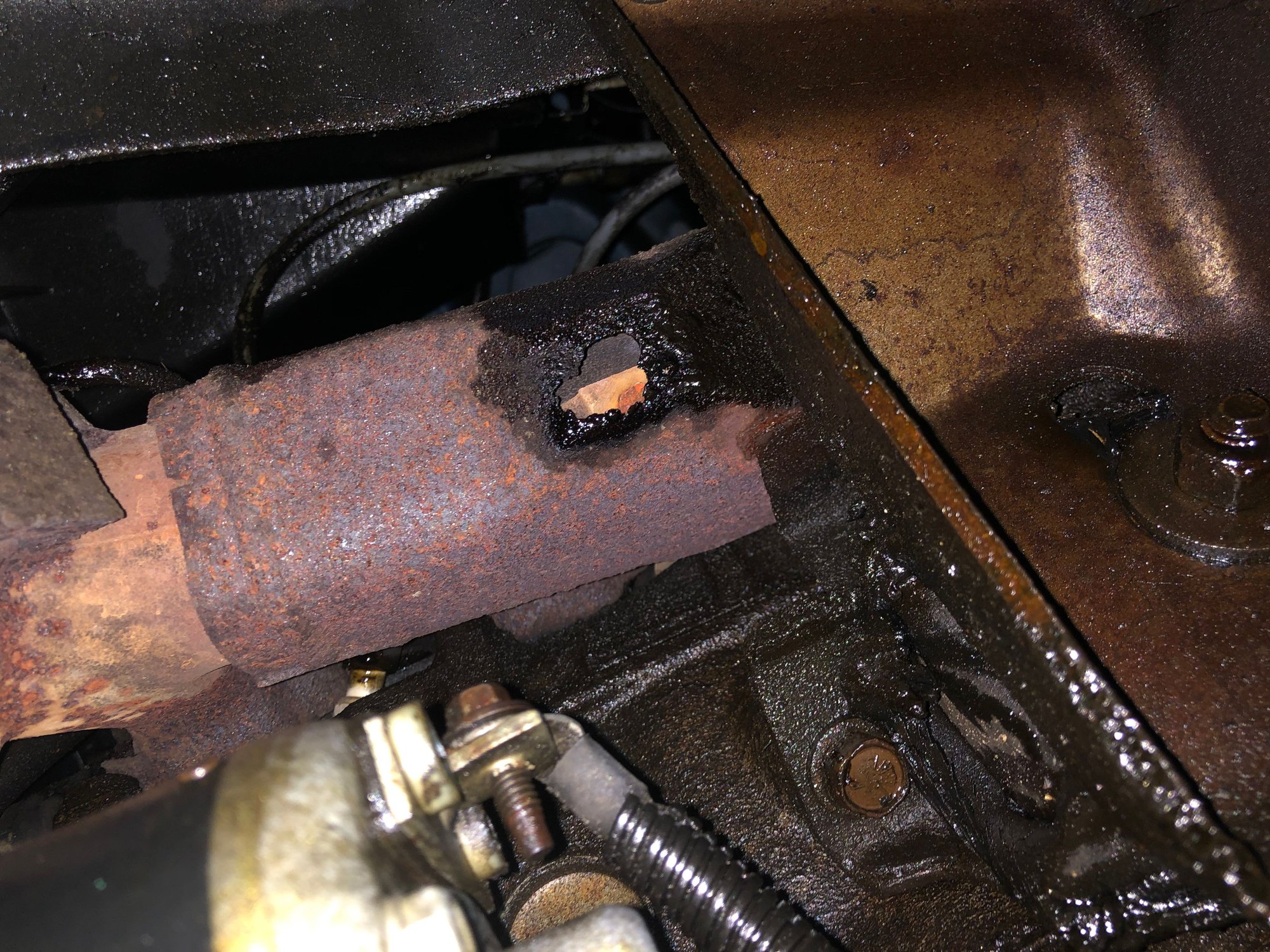

The hole in the bottom of the exhaust manifold
Back right corner of the pic is a metal tube going to the carb.

Do you have an exhaust leak on that side?
I ask because that does not look like the as I dont see an exhaust leak at the hole.
If there was you would not see the wet oil around the hole.
That looks like a tin heat shield for the starter that fits around the manifold.
I dont have a v8 so I cant look to see if I have one like yours.

Do you have an exhaust leak on that side?...
Good eye! Didn't notice that while looking on my phone. But on a bigger screen, that certainly looks like the heat stove for the heated air intake. The cast iron manifold inside is likely just fine.
More details with good pictures here:
https://www.ford-trucks.com/forums/1...ed-photos.html
As far as I know, nobody makes a reproduction heat stove. Couldn't find anything at the time when my original rusted away.
I dont think it is the heat stove tin as I am not really seeing it up top and have not known them to go on the bottom just the top.
Also you can see the starter where the cable is connected and the tin just above it.
I also believe that there was a hole there to start to drain any water that may collect on it to drain.
When you have a edge like at the hole, rust will start there. You can just make out part of the factory hole.
I dont think anyone makes a replacement and with that little hole I would not worry about it.
They do make starter heat shields to fit any motor, check Summit Racing or Jeggs.
What I would worry about is the oil leak.
Oil on a hot manifold is just asking for a fire
Dave ----

Ya looks like a hole in the heat stove. odds the engine will never notice it

If you can't find a new heat stove/starter heat shield on a salvage yard truck you could always remove it and take it to a skilled welder for repair. If you're doing a concours restoration.
