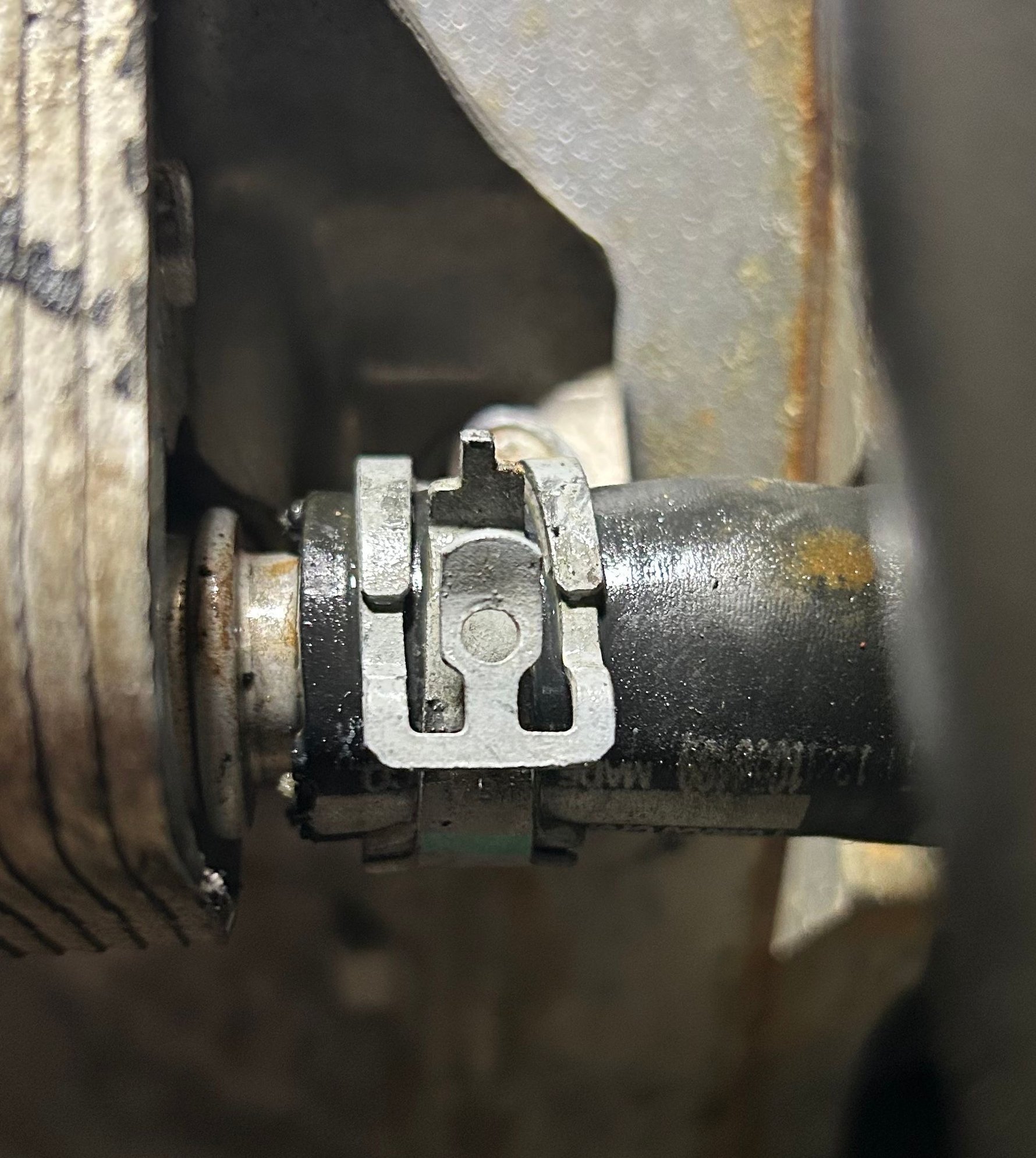

My dad has a 2019 with the 2.7 EB which developed a coolant leak recently. The truck only has 65k on the clock, so a coolant leak was really a puzzle to me. We had it scheduled to take to a dealership for work, due primarily to his preference to use them vs. a local shop. I don't have a lot of faith in the integrity of dealerships in general, and in this one specifically, so I decided to get under it and see if I could find anything. I believe it helps avoid unnecessary work if you already have an idea of what might be wrong. What I found was the locking spring clamp on the coolant hose to the transmission cooler was in the "locked open" position and the hose was about to pop off the cooler (see picture below).
This is how I left it... no more leak, and I've cancelled the appointment at the dealership.
My concern (besides how BIG that second picture is) is whether this happened out of someone's incompetence on a previous job or if it was someone trying to take advantage of my dad (he's 89). He's had two shops work on it in the last year - the dealer did a cat converter replacement (he said it was a recall) and a drive-through lube shop did an oil change. Both of those jobs require removal of the splash shield to access the area. I'm just trying to figure out why either of those would result in someone touching that hose clamp. Most likely would be the cat converter job, but I'm not sure why you'd need to disconnect the cooling line from the transmission cooler.

my guess it has been that way possibly from new on the line ,time and travel expansion, made the clamp move down more off the bulge and start leaking , it's not a area where i feel anyone would waste time on to do a trick on anyone, main things shops do today are the old you need a new cabin and air filter showing you someone else's really dirty ones, OHH you due for a BG brake fluid change.flush at 20.000 miles, and your throttle body and injectors need cleaning

My main question was whether anyone here knows what's involved with the cat replacement... it would've had to be driver's side to be anywhere near this coolant line, and if the hose was disconnected then that would've drained the system (or some portion of it). That seems way off base for a procedure involving the exhaust, but if it's gotta be moved for access or something then ... maybe? I considered whether it might have been left like that at the factory, but seven years to work its way loose? Another question someone asked was whether the lube shop does coolant checks and flushes, maybe started out thinking they were supposed to do one on his truck but found out that they weren't and forgot to go back and seat the spring clamp. We'll honestly never know the truth, but I'd like a better idea of whether it was malicious or just incompetence... I'm leaning to the latter.

I don't even have to guess that you hit this one on the head. It takes a small bit of effort to pop that clamp clip to speed production, but putting them back to that position is a PIA. I'm saying it was never popped from production.
