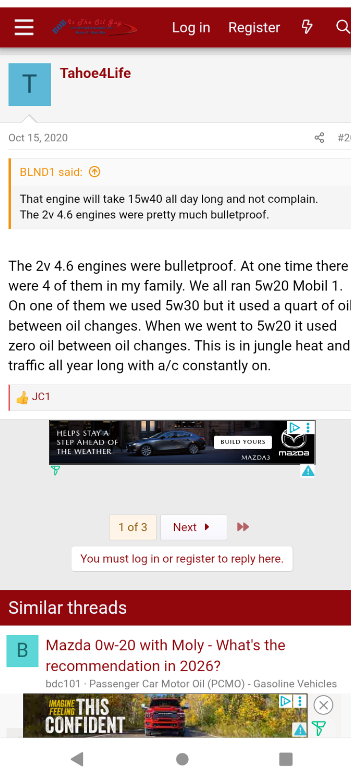

Changed oil two months ago with Valvoline Restore Protect using 5W20 and have roughly 1500 kms thus far.
Oil level is stable and have not had to add any more.
Used it on the highway harder accelerations.
In prior oil changes using Valvoline Restore Protect 5W30 at around 1500 kms, I would need to add a half quart.
I used super tech 5W30 before starting to use the Valvoline Restore Protect and the same issue with needing to add a half quart of oil every 2000 kms.
Which makes no sense because 5W30 is thicker than 5W20.
You'd think the oil burning would slow down.
Last 2-3 oil changes I started changing the oil after the engine was nice and hot.
I don't know if using this method or maybe the Valvoline Restore Protect is cleaning the sludge or carbon off the piston rings.
But a noticeable difference.
Anyone chime in ?
