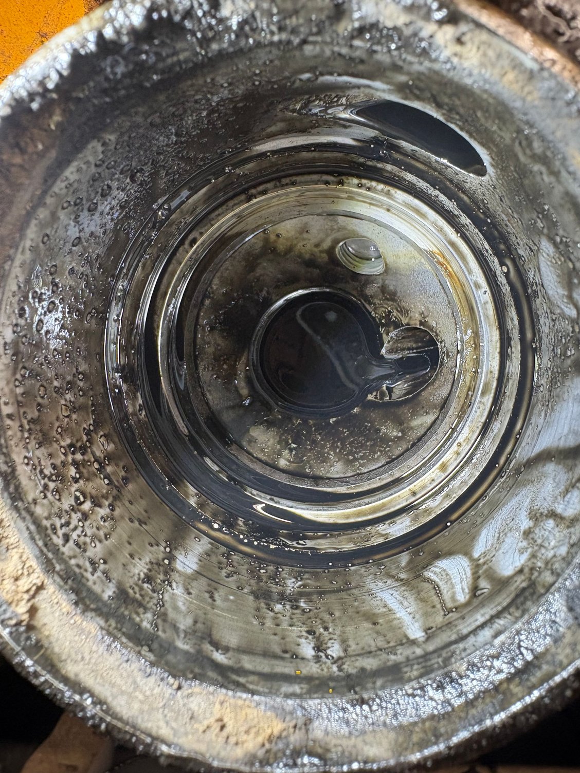

I next drain the oil, no signs of a bunch of metal, and I can see the pickup tube is still there, and solid by poking with a screw driver.

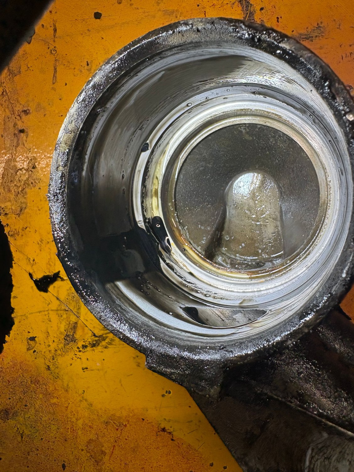

​Then I take the filter off, and yes the bypass valve works hard, and the pressure valve spring deal is not stuck.

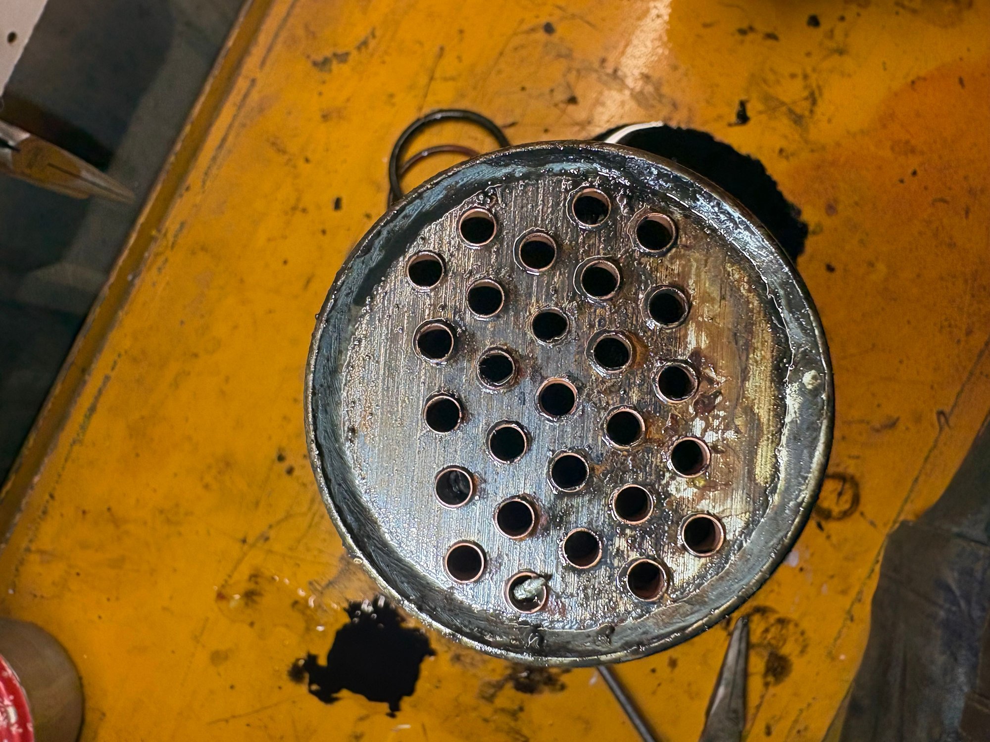

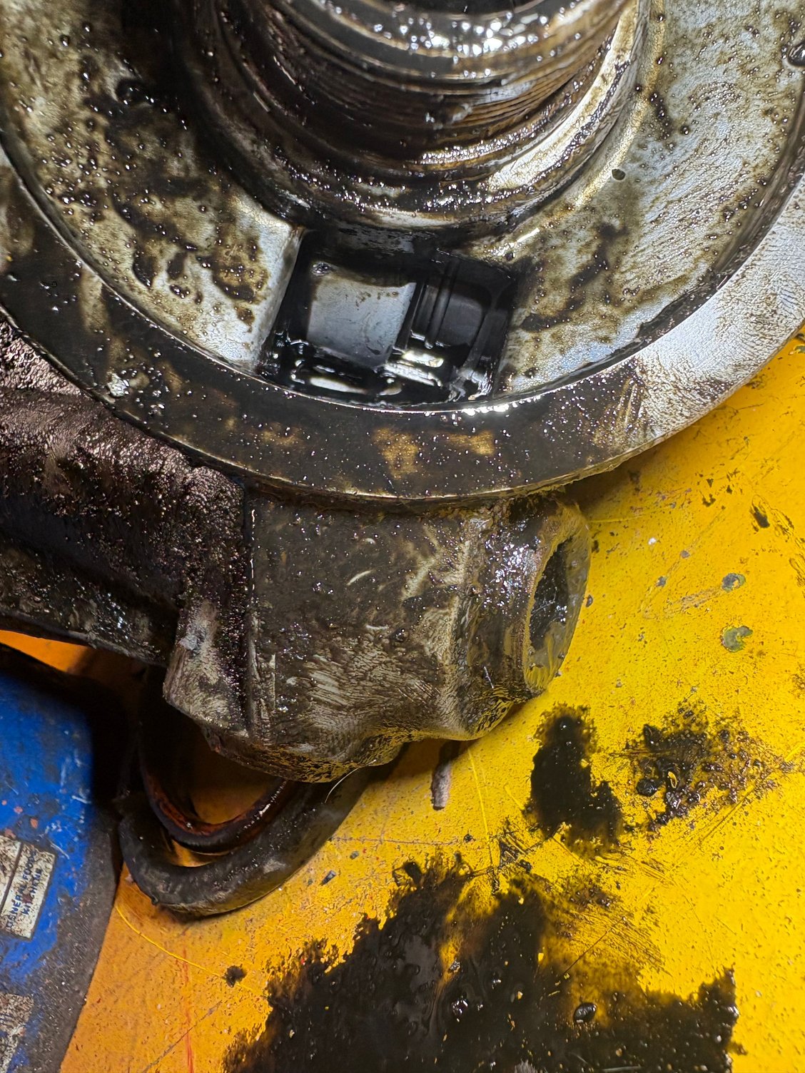

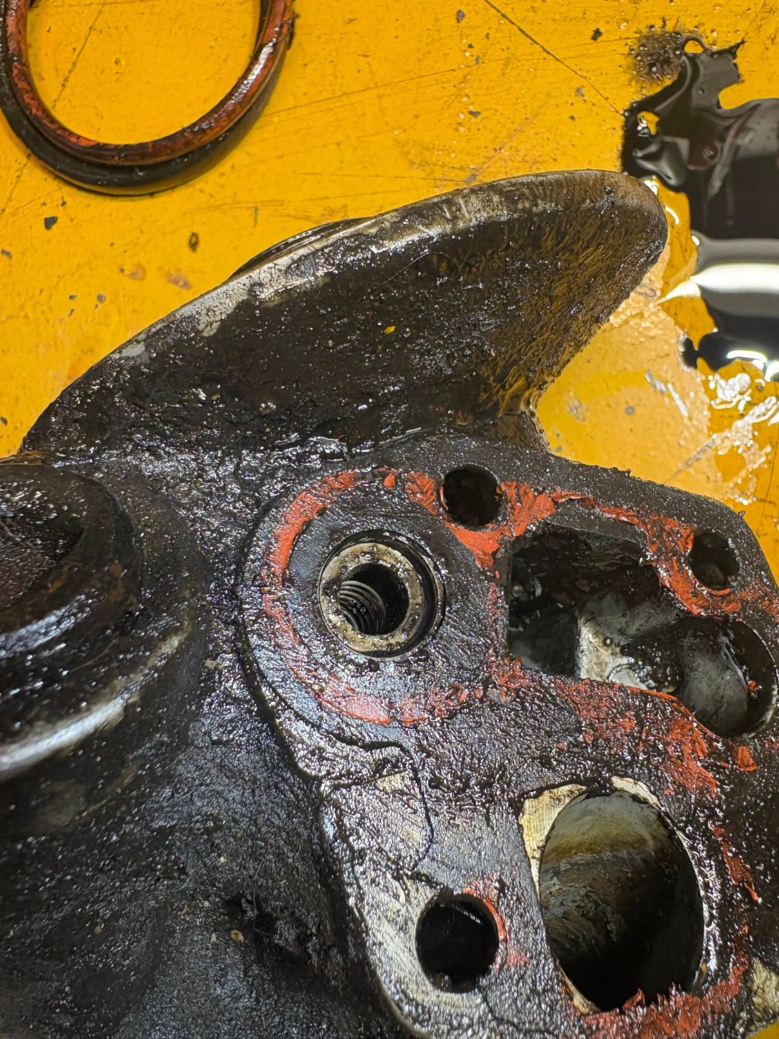

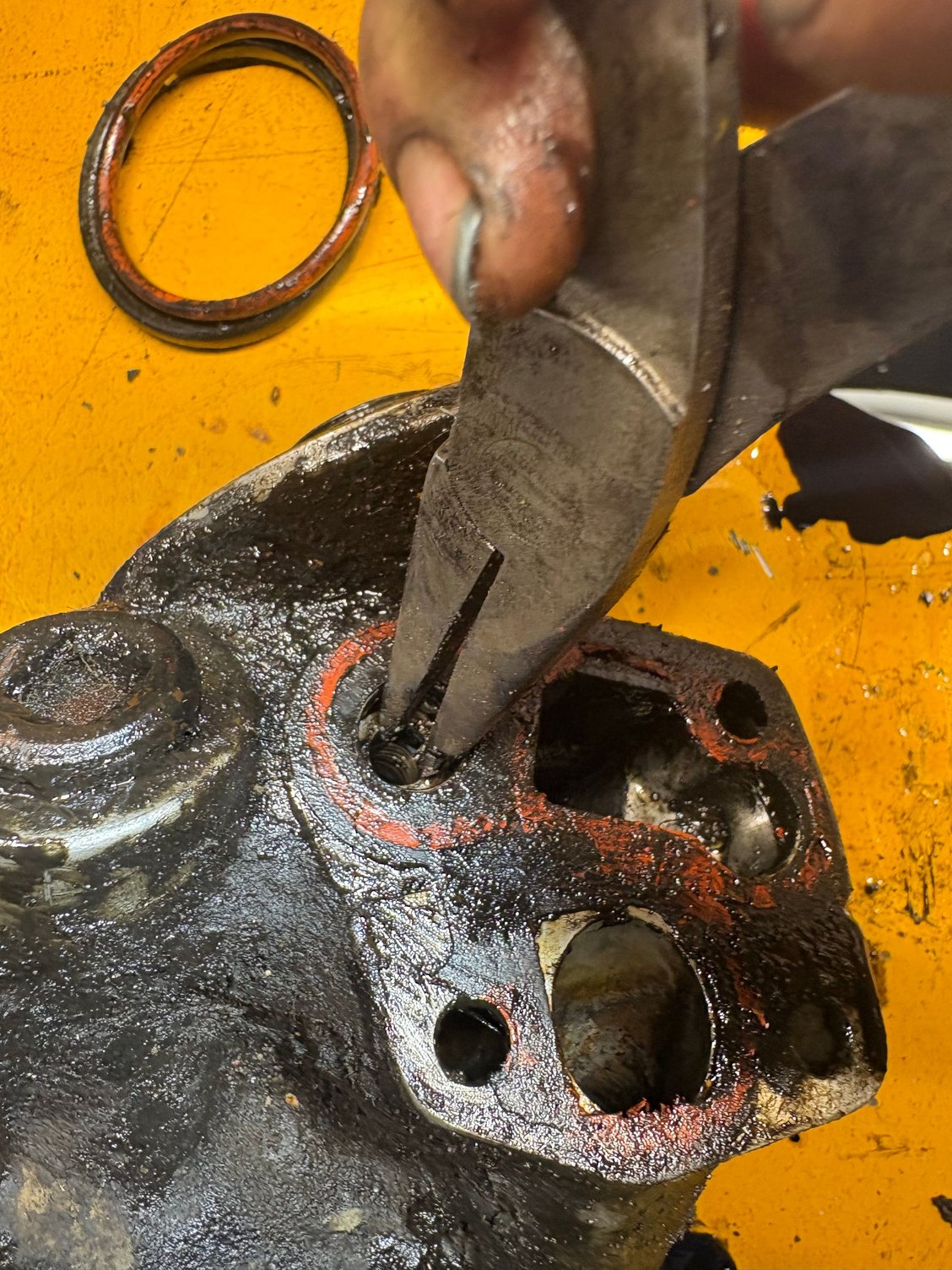

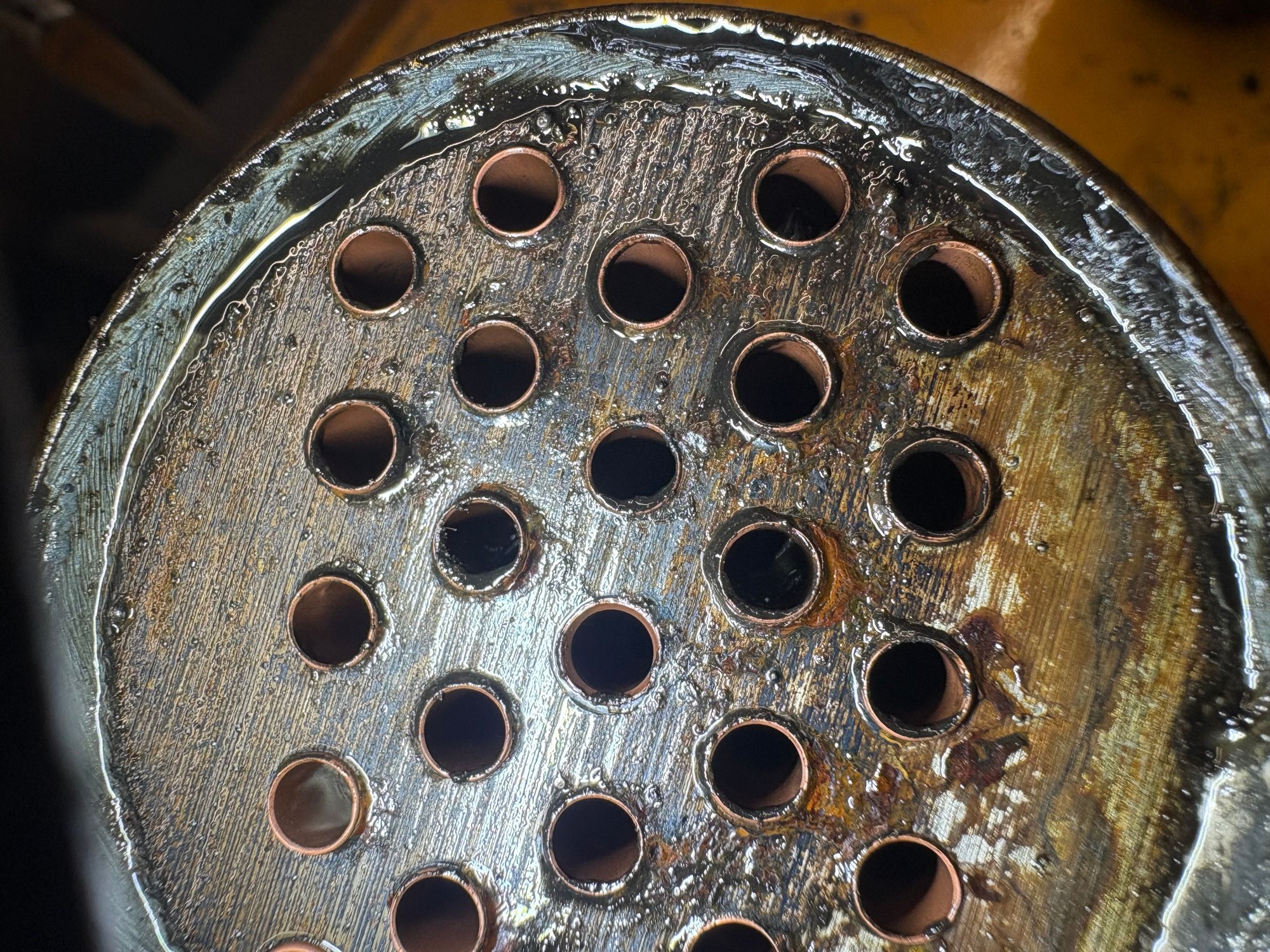

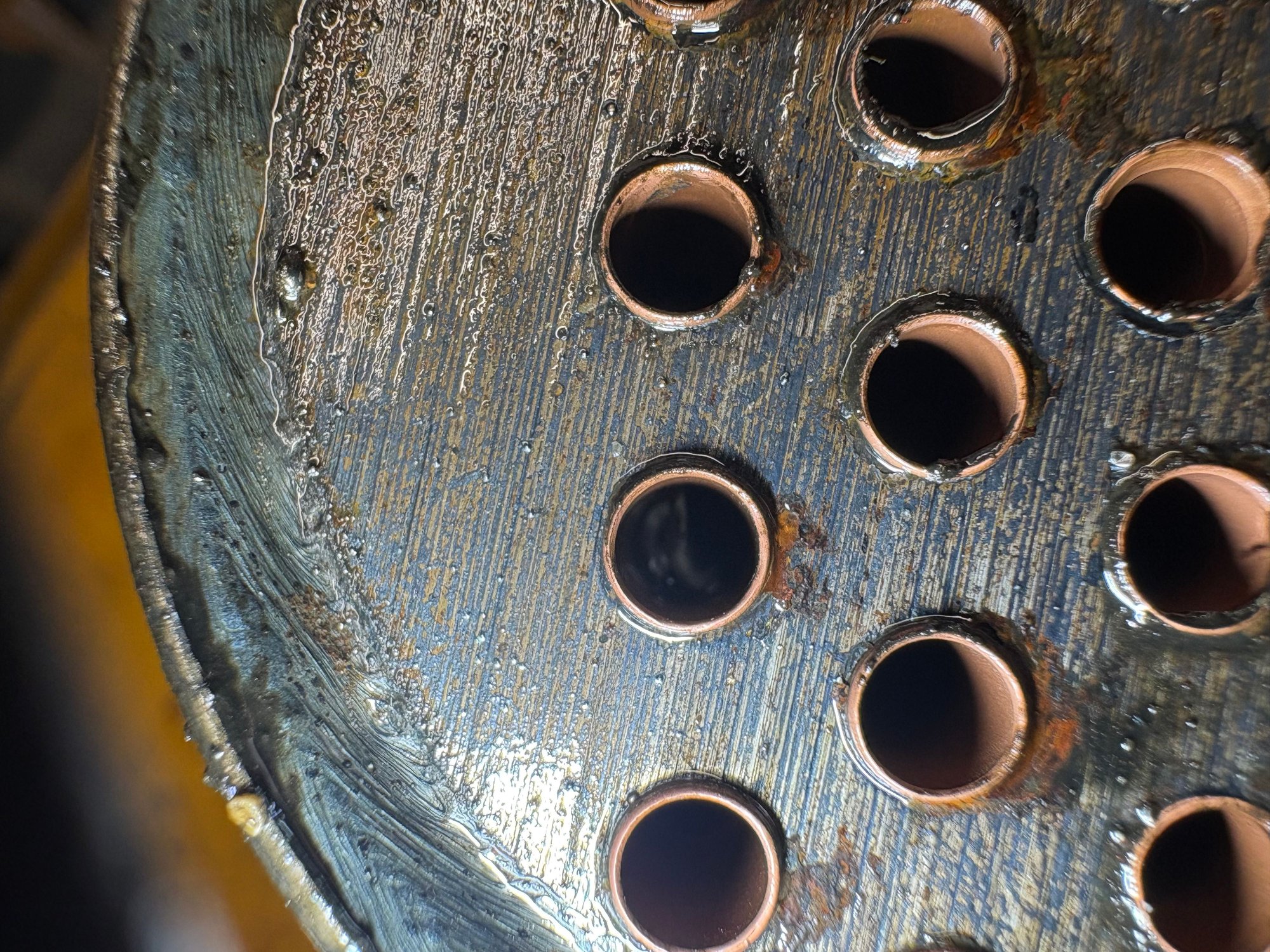

I now have the oil cooler off, and somewhat taken apart, I did not pull the engine for this.
The passages for the oil inside the cooler are a tiny bit rusty, this truck sat in a barn for 14 years, and there is some rtv blocking a couple of the passages, just a little. With it apart, the pressure valve deal pushes in, to allow the holes to align up for passage, and springs back shut.
I feel that the tiny bit of rtv is not causing 0 oil pressure, hard to believe. I don’t know what to do from here.

pictures of oil pressure valve thing

By the pictures I see nothing that would cause no oil pressure.
maybe there is a piece of rtv blocking the oil pressure sender port?
Where are you drawing oil pressure from, drivers side at the oil filter, or top rear of the block ?

Old Feb 22, 2026 | 11:13 AM
paulrademacher's Avatar
paulrademacher
Joined: Dec 2022
Posts: 89
From: Central MN
Top rear of the block

Im curious what is causing this when you find the smoking gun. I think the next step is to remove the drain plug and drain the engine oil. Then shove a borescope inside the oil pan and look at the oil pickup screen and look for any cracks at the oil pickup tube.
