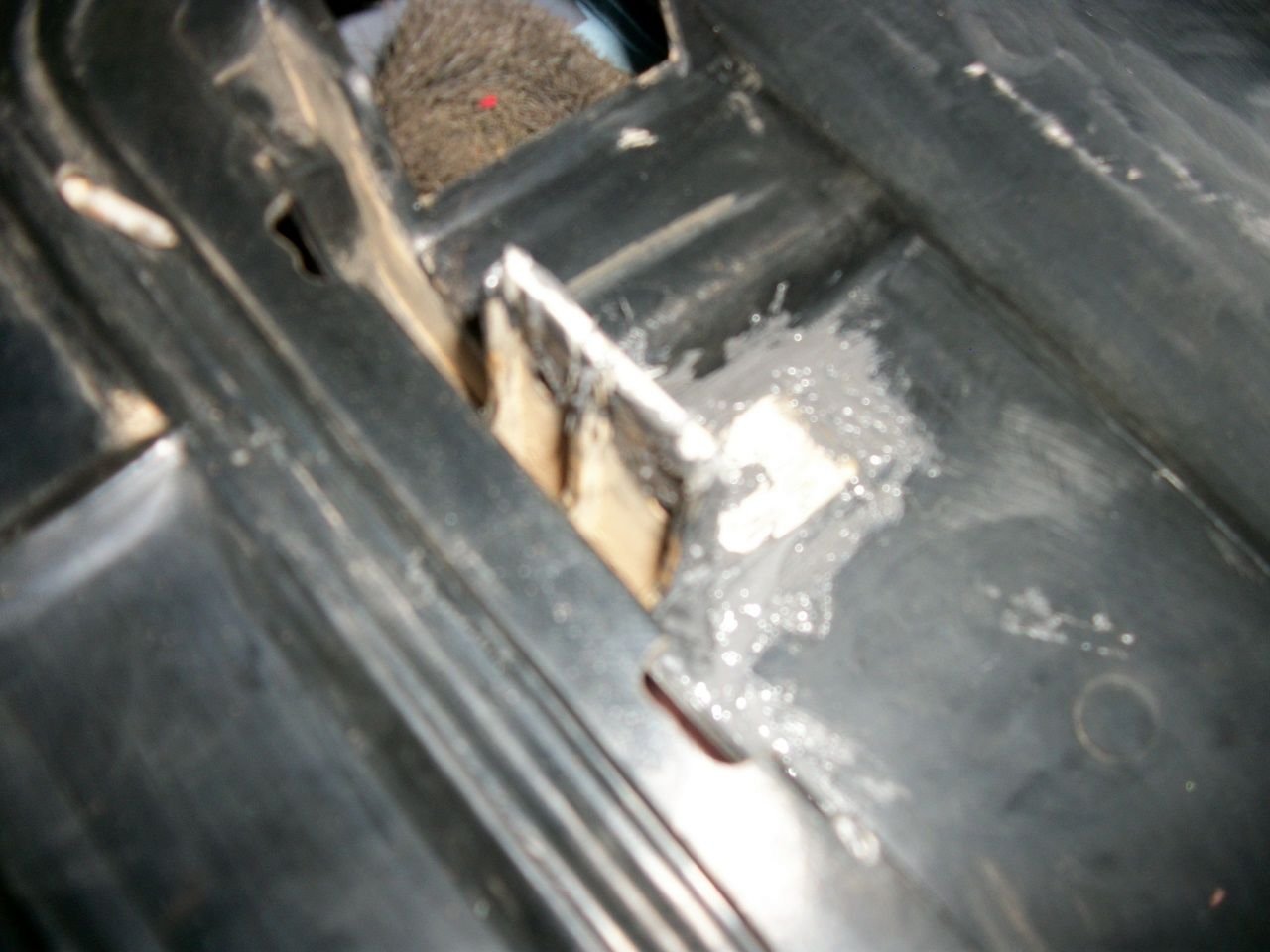

And if you are in the door panel work process, with the door panel off take the padded arm rest off. And dremel notch to clear where the 2 bolts that hold the opening handle L bracket too the inner door skin. Notching them will let the door panel set more flush. When put back on, the arm rest covers the notchs.

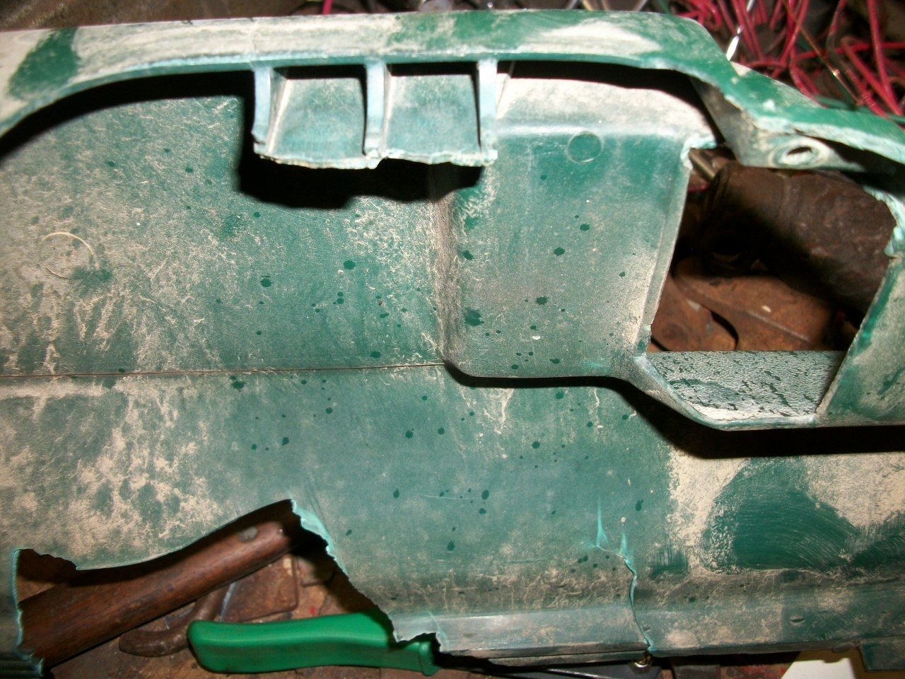

The notches from the back side and some other overhauling work.
2 part epoxy, JB plasti weld, JB weld. I have tried several things.
The notch to use the Xmas trees. 2 part epoxy to hold it on.
JB weld.
So what is the white thing with JB wled on it.....

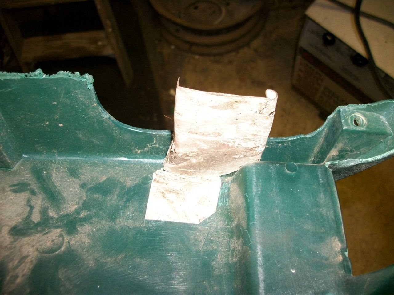

This below is the piece under the finger cup, and on top of the L bracket, that has 2 phillips screws go thru, that holds the finger cup in place and holds the center of the door panel to the door. And the area that takes ALL the door closing force, can break often.
I made some sheet metal reinforcement tabs.
Even if the piece is missing...
I made this one just a bit to short to wrap around the lip on the LH side.
Then JB weld the piece to the door panel.
Make sure the area where you are going to put the adheasive is clean and even scratch it up a bit to give the eopxy or JB weld a surface area to grab onto.
