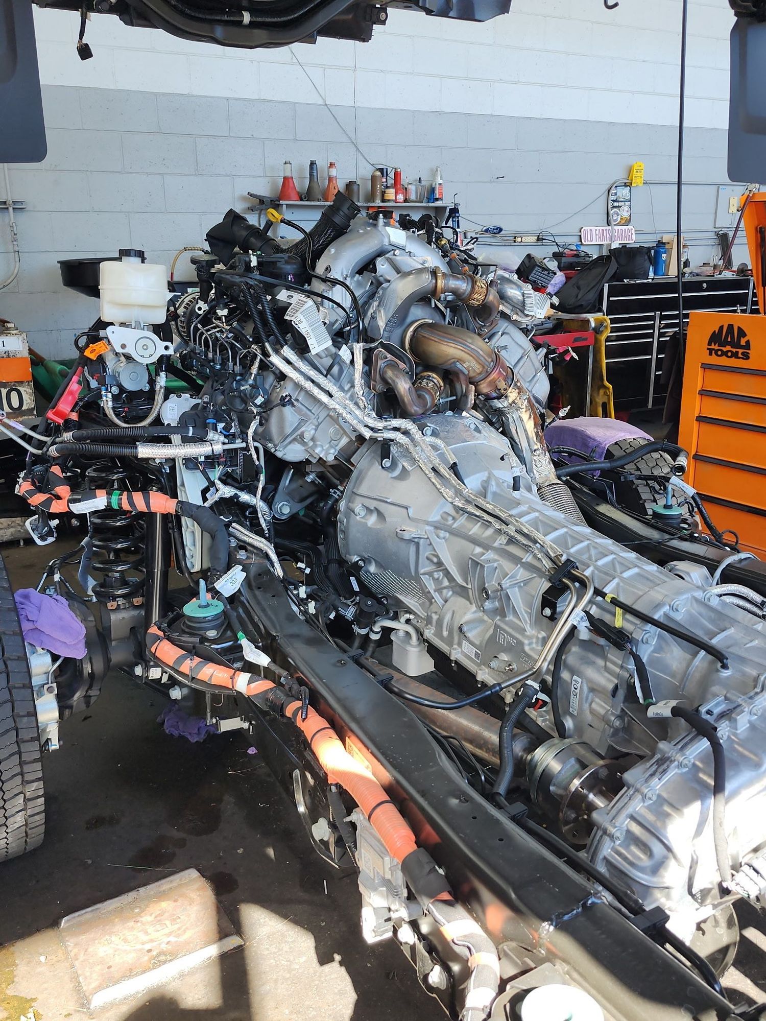

Dealer continues to work at a remarkable pace and communicate well. Old engine out, new engine in. Now to reconnect everything and give it a test

Originally Posted by SushiSean
Going to go out on a limb and say this won't be done today. Old motor still in.
THAT is a mechanics dream job. CLEAN, no rust, no grease, heck can work on that in your Sunday go to Meetin clothes. Should have them throw a DPK on while its being assembled.

ya exactly. let's see what they come up with. Diesel tech says it looks like the crankshaft failed.

My 2017 went thru the same cab-off engine rebuild (not a replacement). Rightfully so, it was a better truck afterwards because the diesel mechanics did such a great job. I had 27k miles on the motor so it was still relatively clean too. Had zero issues afterwards. No rattles, no follow-up fixes, zero. They also sent pictures and updates on a regular basis. Glad they’re taking care of you.

Originally Posted by Tsax6010
It is always fascinating to see the cab-off pics
There are new lifts out with double lift arms, one that lift the cab, the other to lift the vehicle at the same time.

Cab’s back on. Should be delivered back today.
Feel for the tech having to reconnect all the accessories on the upfitter switches. Probably added hours to the job. Will make sure to treat him to a nice bottle of something as a thank you.
Will be sure to follow up with whatever I learn.

Called to ask what time I could pick it up. They told me they realized at the last moment that the parts department also ordered a turbo, and they forgot to install it. So, off with the cab again. Pretty deflating, killed my confidence in this whole operation.
