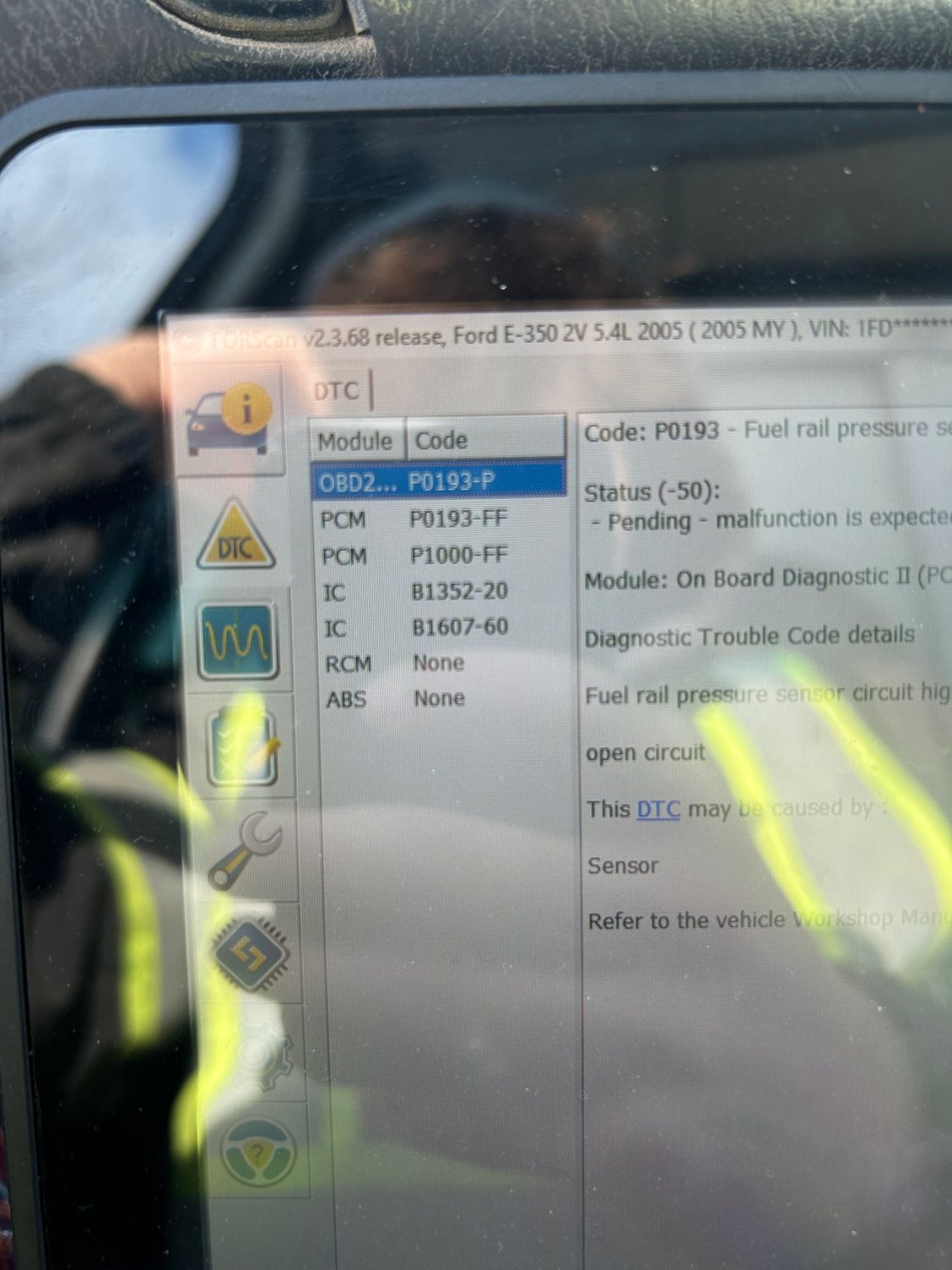

I have a 2005 e350 super duty with the 5.4, and as far as I can tell, the 5r110 transmission. It shaving shifting issues and wanting to know some direction before I condemn the trans itself. What happens is it shifts 1-3 fine, then it will hold 3rd and keep revving up and not want to shift out of 3rd. Once I let off the gas, it will shift up into 5th, then when I hit the gas again it feels like there’s no power and instantly drops back down into either 3rd or 2nd and revs to the moon. So basically when you finally are able to get it to shift up, it kicks itself back down immediately, and you can’t hardly get above 45-50 mph. All of these gears I’m listing are what’s shown in forscan. I am a novice with forscan as well, so any other testing that can be done from there would be appreciated. Also, there have been no trans fault codes so far.

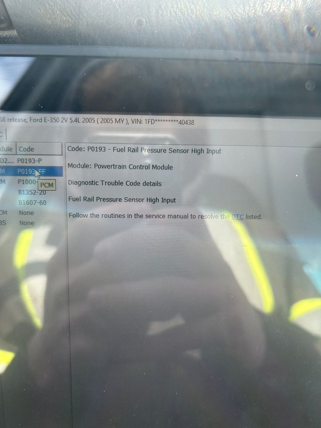

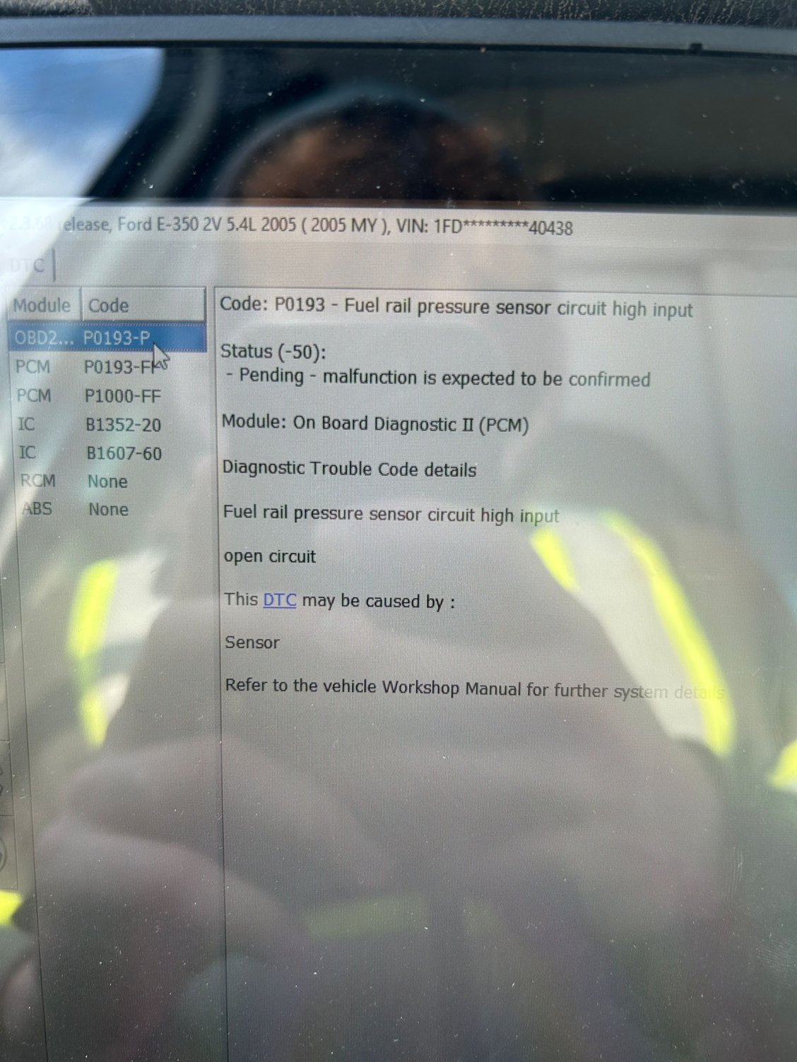

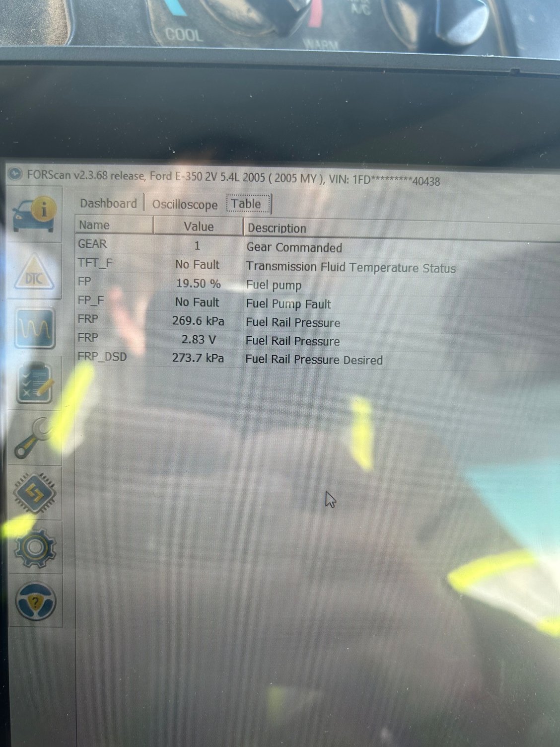

I haven’t been able to get any connection to the TCM, I’m not sure if that’s because I’m doing something wrong on forscan, or if there is no tcm on this particular vehicle and it’s all ran through the pcm. Anyways, attached are the images of the codes on the truck, in the pcm. Additionally I took it for a drive, and the truck feels super low on power, almost as if the lack of power is the reason it’s not wanting to shift, because it’s not getting up to speed/rpm/power to meet the criteria to make the shift. Also, sitting in park, with the pedal to the floor, the truck won’t even get to 3k rpm. Also, it says the fuel pump percent is only about 25% while holding the pedal to the floor. That would explain why when it finally does upshift into the higher gears, it instantly drops down, because it doesn’t have the power to hold the higher gear. The truck just feels sluggish. I know these two codes are related to the fuel delivery, however it also shows no fuel pump fault and shows what I think is regular fuel pressure. Sorry I know that’s a lot of information, but it is what I’ve discovered so far.

The PCM runs both the engine and the transmission.
Fix the engine codes, and the trans will be fine.

Given the codes shown that I have, where would you think the issue would be? A failing fuel pump? My only issue with that being the cause is that according to forscan, the fuel pressure seems to be what it is calling for.

You would need to monitor fuel pressures when the issue happens... Usually it will be fine at idle but with load on the engine the fuel pressure will fall fast. Also monitor fuel rail pressure return voltage.. The voltage should go up and down slowly.. You can unplug the rail sensor and see if it drives better.. If it does, the sensor is giving incorrrect info to the pcm. If its something else like the fuel pump driver module or the fuel pump itself it will run worse...
Also, if a torqshift in any vehicle, isn't getting enough torque it won't shift.. You would not be the first person to think its a transmission issue...

I thought the E-series got the 4R75, esp with the 5.4?
Anyway, I'd start by looking at the FRP sensor and wiring. If these have a FPDM I'd also look at that for corrosion.

They came with either a 4r or a 5r depending on application... High input code mean the pcm is sending 5 volts to the sensor and the sensor is not changing the voltage so that the pcm can understand it.... Monitor your rail sensor return voltage and the rail pressure. Graph the return voltage. It should have no zigzags in the voltage...
Unplug the sensor and see if there is return voltage still. There should be zero return voltage.. If there is still return voltage that mean a short to power (This is rare). Unplugging the sensor will put the truck in default mode and it will still start and run but not great, IF everthing else is good. I get ones towed in a few times a year with an after market rail sensor on them causing random no start/stall, run rough issues.. Only use an oem sensor if yours is bad.
