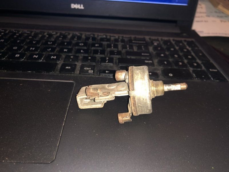

Making use of some time going through my stash and came across this wiper switch that obviously was placed in the wrong box...
It definitely is a Cole Hersee switch extremely similar to what should be there, but unlike what should be in the box, this has a bi-metal contact - possibly for intermittent wipe. I don't have any Cole Hersee or related catalogs that would help further identify this... Thoughts?

I can't give you a part number, but my understanding of the bi-metal contact is that it is a circuit breaker protecting the wiper motor and wiring if the wiper is stopped. (Frozen to the windshield, etc.)

Yeah, circuit breaker was another thought that had crossed my mind, just overlooked expressing it above.
I'm more accustomed to the breakers being enclosed like this example:

That looks like the one I installed ror my 51 with electric wipers.

Yep, my 52 with electric wipers had that exact switch in it.

@51fred and @silverstar71 , you both are saying that your stock setups have the bimetal strip per my picture in the first post?

Yep, it's just a primitive circuit breaker.

I went back through my phone and found this from when I was changing the harness.  Not a great pic, but you can see the circuit breaker on the back.

All very interesting - my other examples are this style:

My 1953 original:
Yes, same here.
