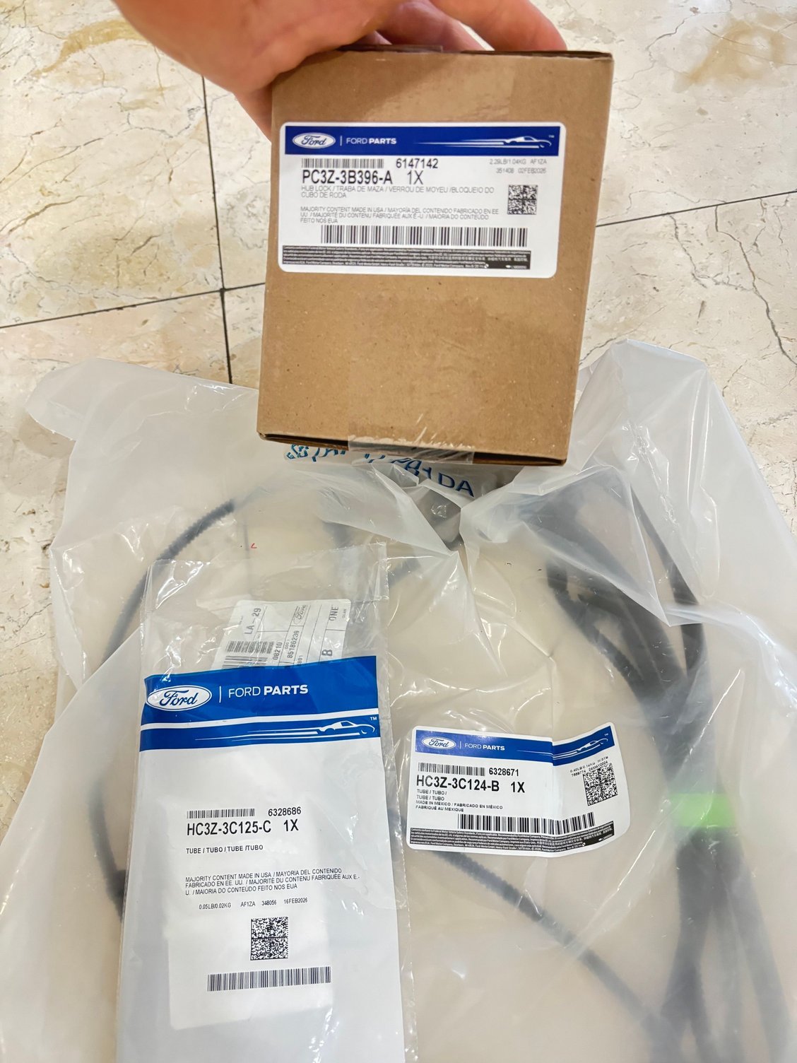

Old Mar 25, 2026 | 08:54 PM
wcbcruzer's Avatar
wcbcruzer
Joined: Aug 2024
Posts: 380
Likes: 117
Well I got them parts. These are the latest part numbers if anyone else is interested. Other part number should cross-reference to these. Unless this is just old stock they had left over.
Gotta say this is nice. Been driving clunkers for so long that anytime you order a part from the dealer, it's on "universal back-order" indefinitely.
