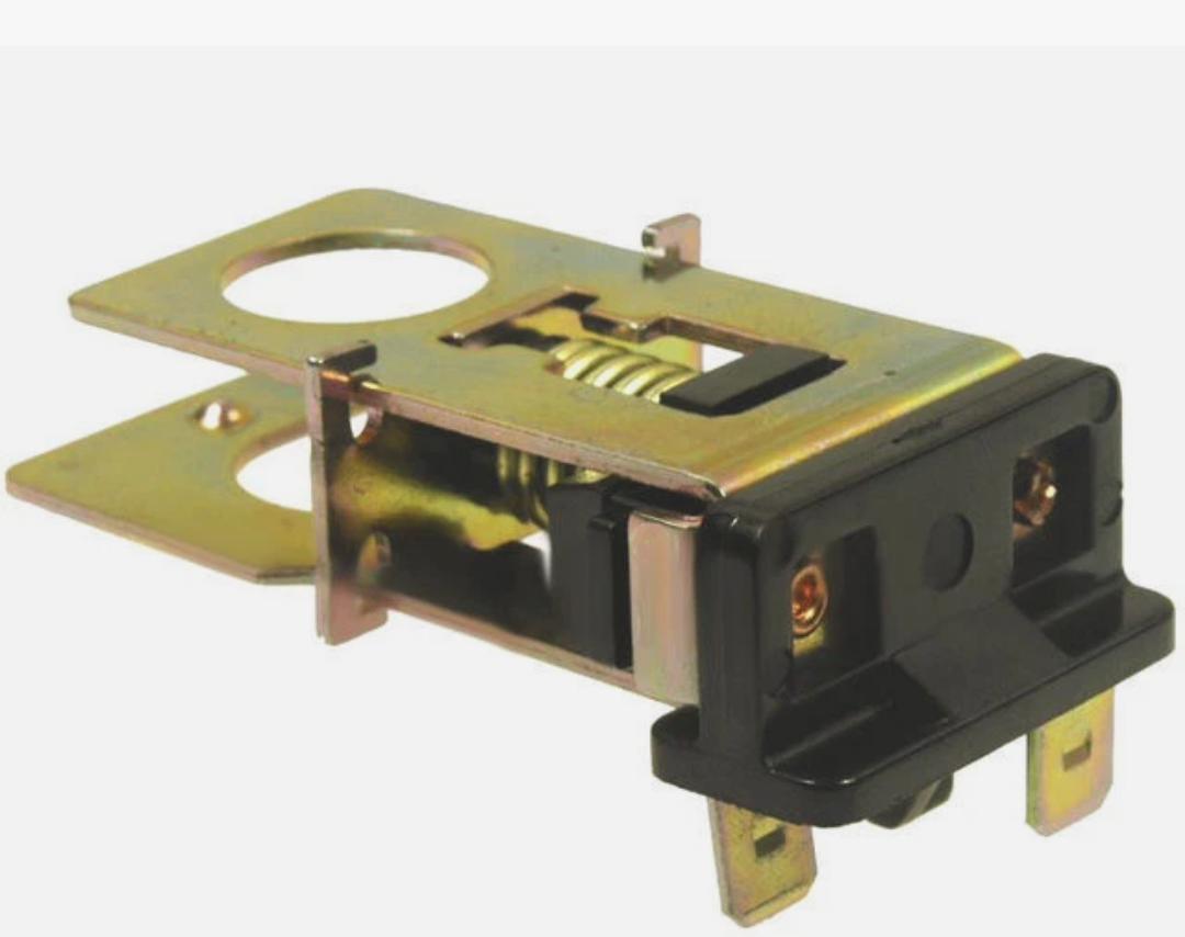

Question on a 91 E350 with 7.5 Rv.Cranks yes ( 12.4 volts non running) .However Customer cannot shift out of Park.This rv is a total train wreck on wiring,no key but Push button( omg) stuff.So my theory is that the Brake momentary switch is toast..Imo the neutral safety is Not a issue as it Runs.The front fuse box driver side not labeled, no clue on the secondary eng.bay fuse bo its no where.Am i barking at the sky, or on thr right path?Checked Napa Echlin ECH SL222 thoughts? Oh I do fix alot of vehicles on the side.98 250 on my driveway getting a rear axle resto shocks then the whole Front end.

The neutral safety switch has nothing to do with shifting out of park.
It's been 35 years, so my memory could be faulty, but I thought the brake switch to shift out of park started with the 1992 models.

This Van/ rv def has the switch i will show.Based on my extensive digging 91 has it, saw it today doodling on this relic.

Try this: Turn the key one detent towards run, but not enough to turn anything on. Now see if you can get it out of park. If you can, the lockout is keeping it from shifting. That could be due to a bad switch, or a bad brake light switch.

This Umm custom rv has had the original ignition yanked.They installed a screwy push button.O may just run a temp jumper and see if that flies.As I know it will keep the lights on.The part in question is $30 but there let's say ( struggling) money wise Have a ton work so, I may pony up and buy the part.

If they wired up the starter button, and probably a on/off switch for ignition, and didn't do anything else with the steering column, then the shift lever would never be unlocked.
