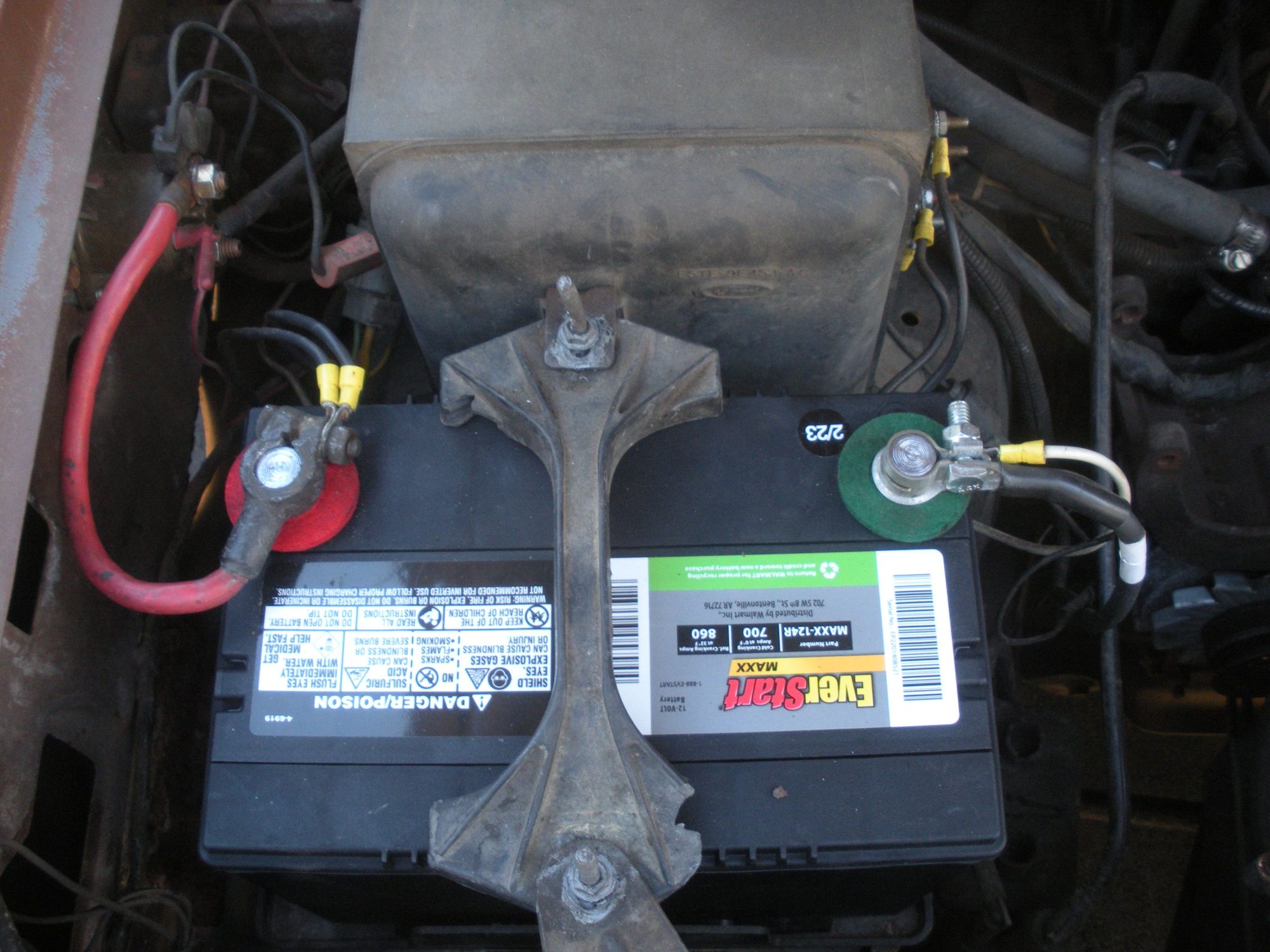

Battery, make sure your cables look something like mine.
