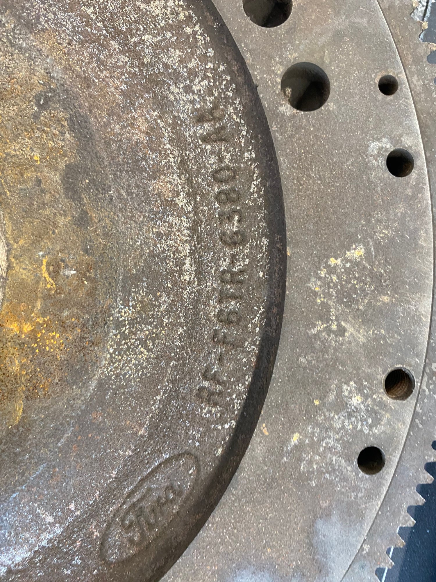

I have 2000 4.2 4wd with 5speed manual my flywheel is this amd no flywheels at oreillys will line up.
Old Jan 26, 2026 | 11:51 AM
BareBonesXL's Avatar
BareBonesXL
Joined: Jun 2023
Posts: 1,379
Likes: 383
From: WA
Line up with what?
https://www.rockauto.com/en/catalog/...,flywheel,5348
