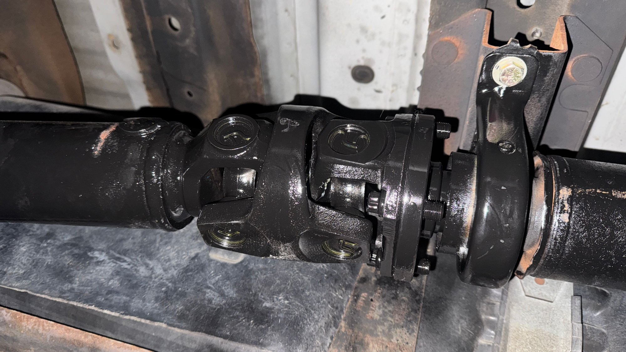

As expected Nitro gear specs the lash to .006 to .008 (I guess it was scribed on ring gear)... those that I spoke with seemed to be of the opinion that since I've run it, it is likely to want to wine either way. So paused on doing anything about that at the moment. I needed to get my drive line vibration corrected and decided to add a 1400 series double cardan to the rear shaft and eliminate all the shim mess on carrier bearing. Drive line service in Sacramento built me a real nice two piece shaft with a 24 hour turnaround! Installed the shaft, test drove and now I'm having trouble detecting any wine at all now? And no more vibration!
