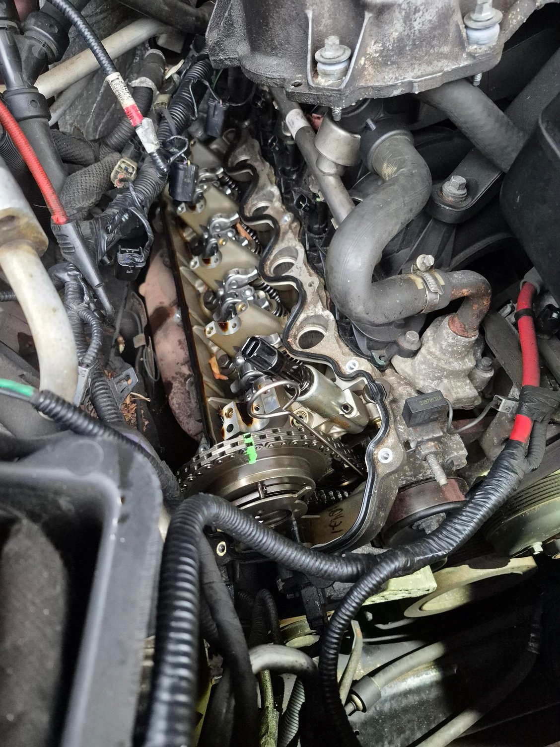

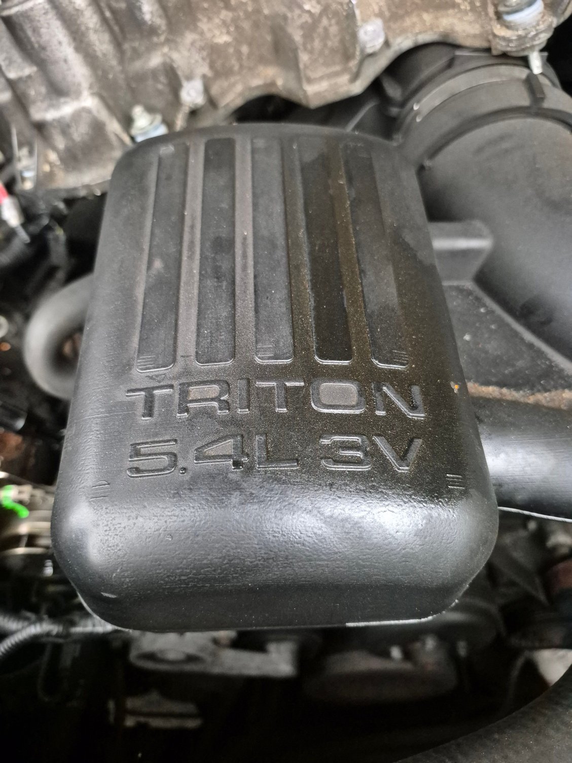

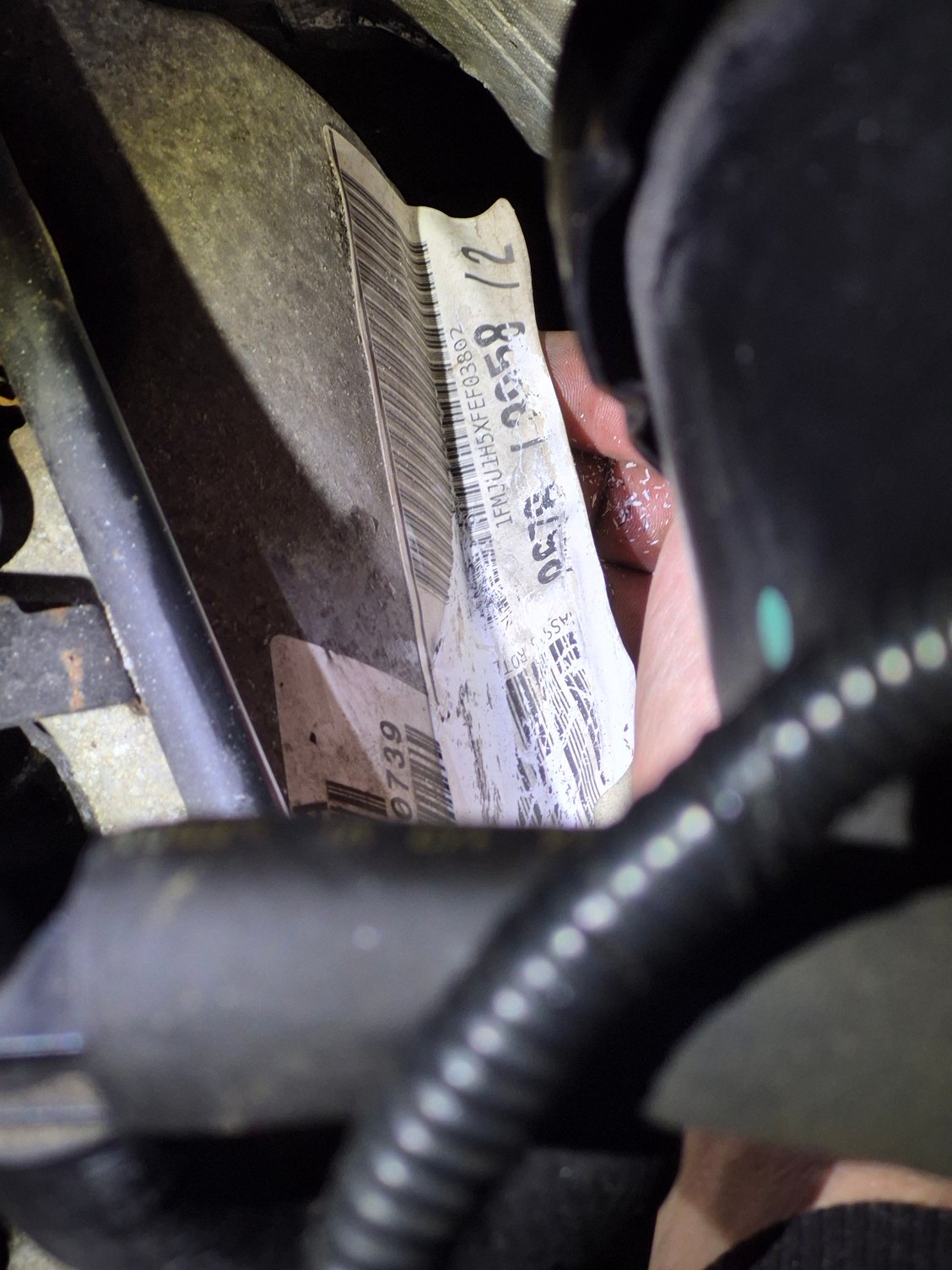

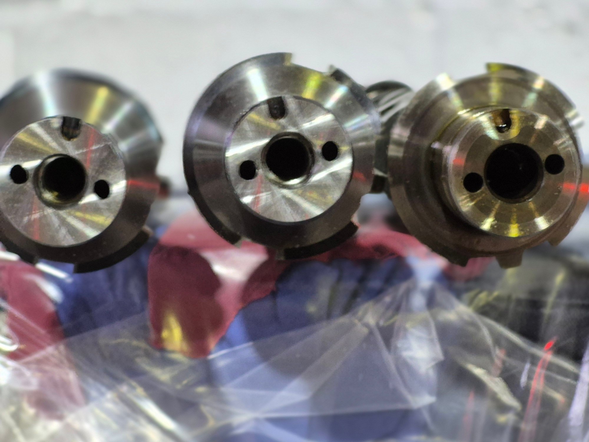

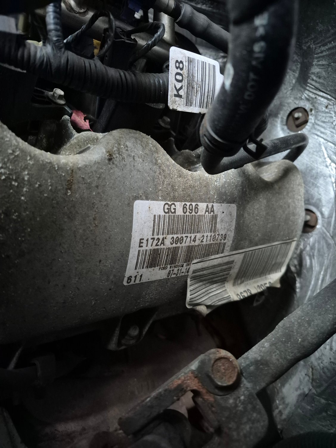

OK we've taken some photos and found the stickers you see below. There is also a photo of the original cam shaft we've removed that was working for 10 years (the one with 9F-9L3E-6251-CA printed on it) and you can see the new cam shafts have the notches in the wrong places. Thanks again for the help - the lower sticker was hard to photograph as when you touched it the letters flaked off but hope this helps a bit.
thanks
Mike
THis is the best I could get - the lower sticker was flaking off as we moved it so we can't see the lowest numbers properly
This is the best we could get of the bottom sticker

The two on the left are the new ones but the notches in the ends don't match the originals)
This is the original camshaft that worked for 10 years and we're trying to replace (says 9F-9L3E-6251-CA on it)
Better pic of the notches that do not match the original cam shaft

We actually have a set of the 2014 cams in stock sop we went out and took pics. The number on the cam matches yours. This is the 9L3Z-6250-C.

Thank you - just a quick one. So the two parts have sligthly different formats - is that normal?
RF-9L3E-6251-CA <- the one I have and you do too
RF-9L3E-5C255-C <- the other one I cannot check as it's in the engine still so just wanted to check the 5C255 bit was right as it's an extra character
Thanks
Mike
Old Oct 29, 2025 | 02:35 PM
AppleFordParts's Avatar
AppleFordParts
SPONSOR
Joined: Jan 2025
Posts: 477
Likes: 281
From: White Bear Lake
Thanks
Mike
Yes, totally normal with Ford. That's actually 6C525. Some cams have that number, some have 6250, 6A271, 6A273 etc. They're just engineering numbers.
