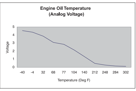

I noticed my oil temp was very high, about 240 cruising at highway speed, I backflushed and am assuming its an oil cooler. So I ordered a new cooler. Question is that when I was looking at the oil temp sensor, I noticed that the pigtail wires were exposed and rubbing together. Could this lead to incorrect readings? Im going to fix the pigtail and retest before I dive into the oil cooler, but wasnt sure if this could lead to incorrect high oil temp readings.

Bad wiring can (and does) interfere with accurate readings.

Sorry for the crappy image; I'm on the move and don't have time to get a better one. Less resistance, higher temp.
