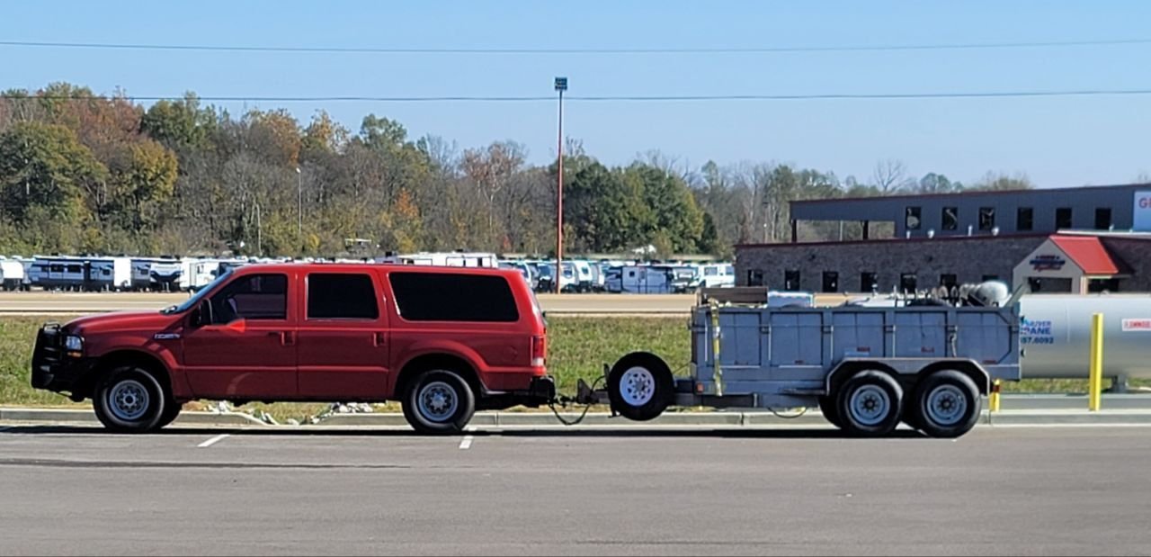

after a couple years, I settled on the Hydra 80hp PHP free tune because of how it handles the transmission shifts.
I don't mash the peddle to the metal, I typically push it to 2500 RPM and just wait for the truck to catch up....
my idea of how it should shift, is the same as my 2001 K1500 Suburban, my Excursions shifts almost identical to that...
however, if I push it to 3500 RPM or more, it will giddy up and go NOW.
When I towed in the mountains, I set it on 25hp Tow tune and set OD OFF.
the RPMs crawl up a bit, I set the Cruise at 68 and leave it alone.
It rarely ever down shifted to 2nd gear, no matter the grade,
8000 lbs of farm iron in trailer.
8000 lbs of farm iron in Big Tex dump trailer.
