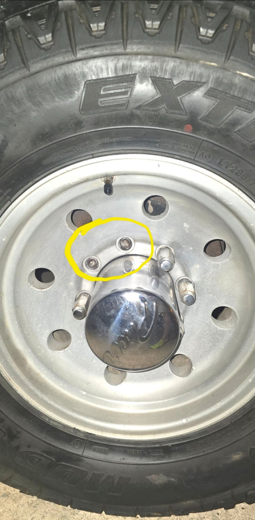

Update: Turns out the rear rims had these ridiculous spacers and the extended studs coming from the spacers are what twisted off. Took off the spacers and bolted the rims directly onto the original studs on the hub. Rides much better and the tires don't stick out from the wheel wells.
While airing my tires, I discovered a lug nut missing and when checking the tightness of the rest, a second, adjacent one twisted off. Evidently the last tire shop overtightened them
. Is this safe to drive (with two adjacent missing lug nuts) for about 15 miles to where I can have a tire shop replace the wheel studs and lug nuts?

The safest answer is no. Order them or run and get them with a car and install them yourself. If the others are still good, you could probably get there ok, but the thing is, if one snapped off while going down the road and another snapped when you snugged it up, how can you possibly trust the others to be ok?......... I wouldn't risk it, but if I had to, it would be an hour trip, going 15 mph for those 15 miles.

If they used a pneumatic lug wrench without the proper limiter they could have torque stressed all of your lugs. No do not drive it. I'd call the tire shop that did the work and inform them of the issue. They should make it right.

You might play with a torque wrench and see where they are at. Might tell you if you should replace all eight.

x3 on not driving the truck to the tire shop.
Definitely inform the tire shop that did it. Have a different shop fix it and then the original shop can reimburse you. If they don't want to you can always leave a poor Google and Yelp review with pics. Don't forget the Better Business Bureau too.
