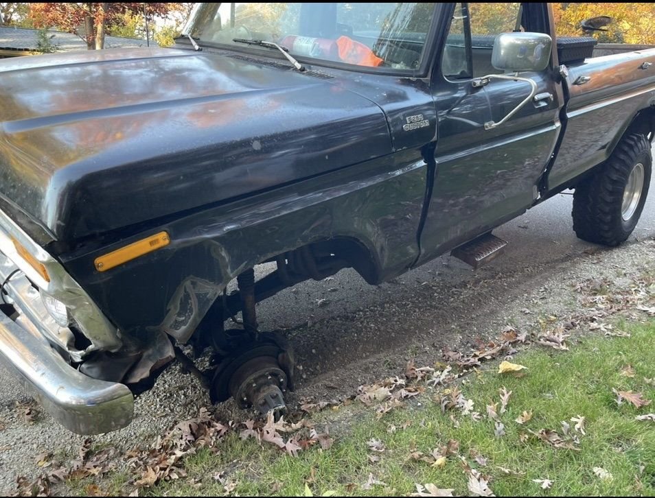

Oops
Must have set those lug nuts wrong somehow.... Wheel popped off while driving pulling a lug stud out with it.

Now you have a fender to remind you. Remind you how lucky you were. That could have been bad. Now go buy a lotto ticket. Nice truck btw.

Studd had to have just fallen into the rotor, maybe pushed by a wheel in the throws of exstacy as it was gonna drop that load down onto the road. Might well still be in the hat. Wheel took the dust cap too huh?

Yes you are lucky, VERY lucky. Sorry to see the fender paid the price. Glad YOU are ok. You must of been going 5 MPH to not have left disk brake rotor drag marks in the pavement, or ground off part of the rotor. Or was your radius are bottom bolt dragging?
For the lug stud to come out the rotor, either wrong brake rotor, wrong lug stud. As far the lug nuts loosening up, are you 100% sure you has the correct lug nut for that rim? This a a F250 lug stud upgrade.

also, inspect your wheel closely for damage. looks like i see a lot of metal dust/shavings on your rotor.

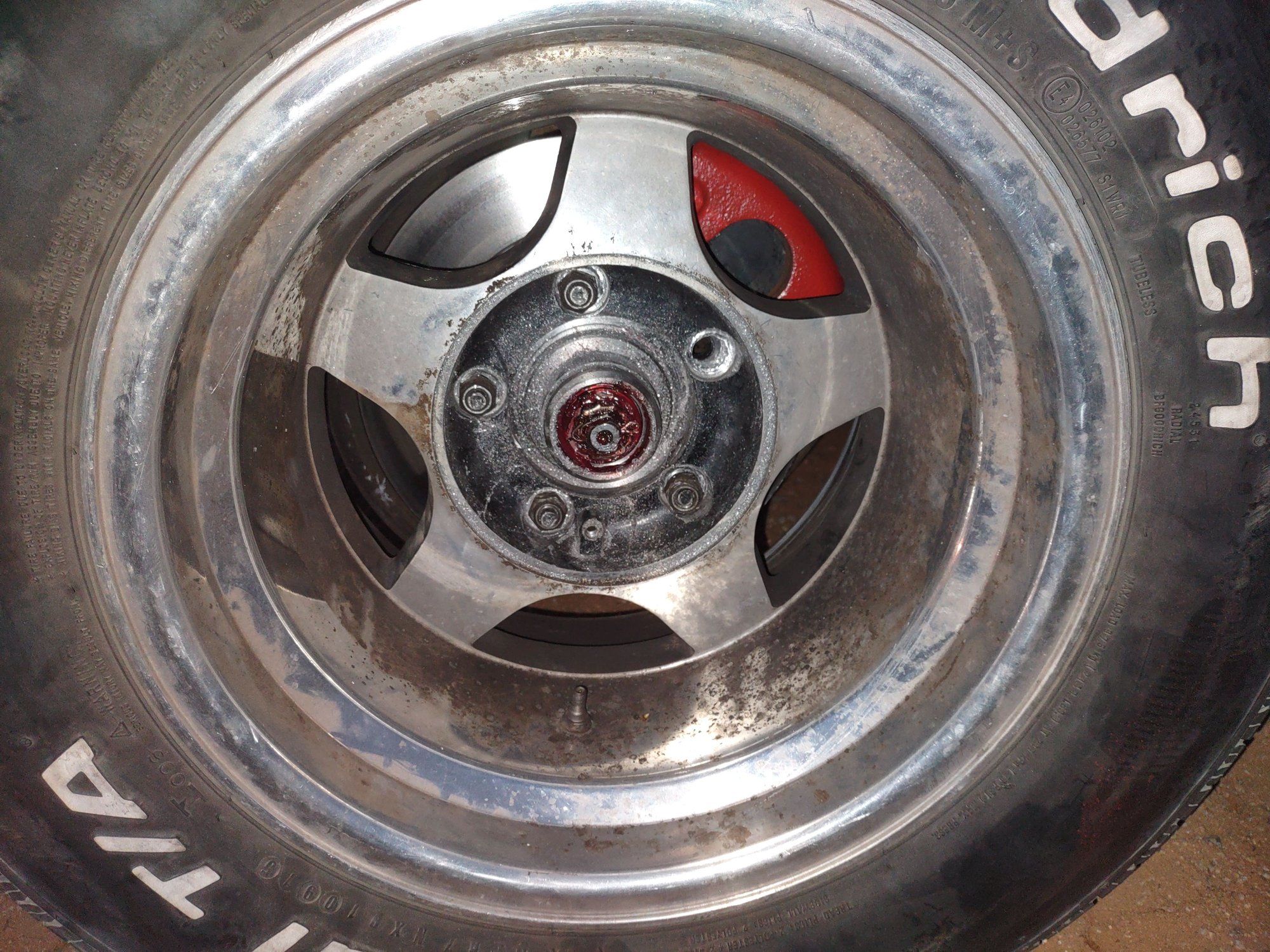

Originally Posted by 440 sixpack
What little wheel I can see in the picture looks like it could be an old school mag style. those usually take shank nuts.
Here's that wheel

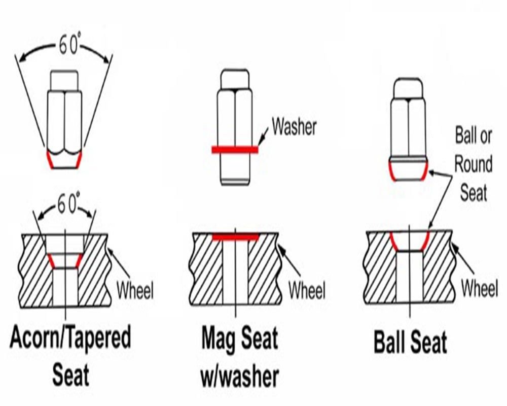

assuming those are the correct lugnuts, you do know the conical portion of the lugnut goes in toward the wheel? the picture looks like they are backwards...but it may just be the flash reflection.
I think your right I see that too.

Correct in the picture, those lug nuts look to be installed backwards.

Fender appears to have a slight amount of damage. From this time, or perhaps from another incident?
All in all you are really luck to get out of that with no serious damage to your sheet metal, and with out a traffic accident.

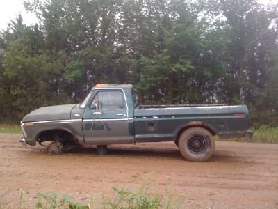

You mean like this?
