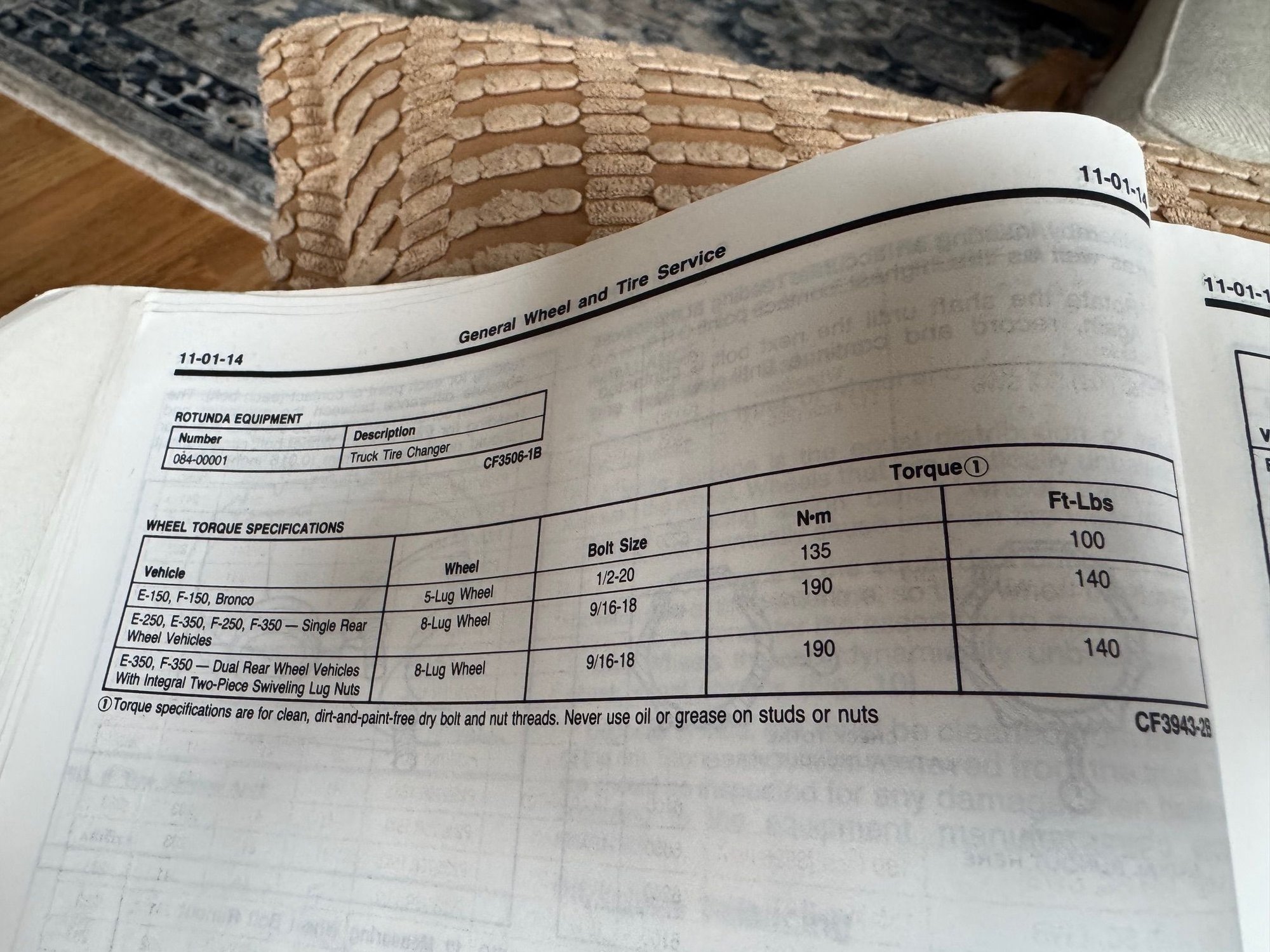

Old Jan 24, 2026 | 01:22 PM
mikeinAiken's Avatar
mikeinAiken
4th Gear
Joined: Oct 2023
Posts: 4
Lug Nut Torque settings 86 f150 shop manual
Originally Posted by Jsavare1
Can anyone tell me the lug torque spec for my ‘85 F250? 8 lug with dana 50 front. Cant find it anywhere online and have no owners manual
I know it is an old thread tu here is an 86 Ford Shop Manual
