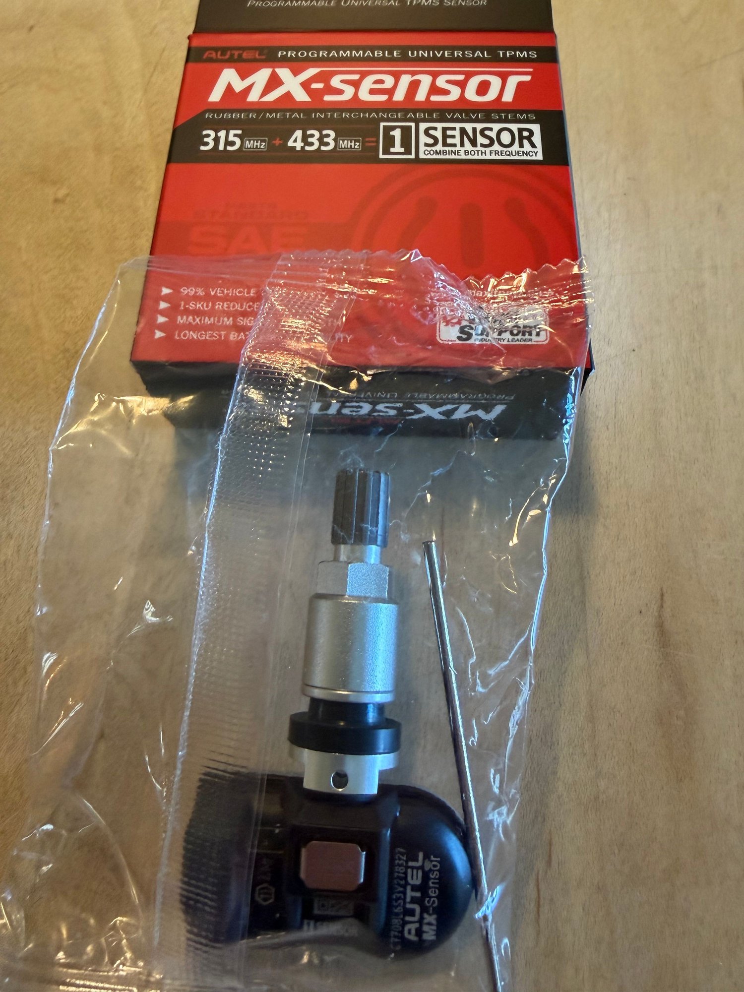

Has anyone had success with these Autel metal stems? They have a more substantial rubber gasket than Ford’s version. I’m due for new tires and that usually kicks off a new round of leaking stems!

I’ve ran them in my stock & Aftermarket wheels on 2019 F350 SRW with no problems at all.
IIRC I had to get the tire shop to program them to my truck.
Also IIRC you can run 10-12psi less air pressure than with the stock TPS w/o triggering the low tire light.

I used these on both my 2020 & 2022 F-350 Superduty wheels with no problems. Keep in mind that rubber stems give when meeting an object and these don't. I've used both and now only order the Autel MX PRO rubber stems. I have my own installation tool and programmer so no more hassle to change out at $20/wheel. I prefer to clone the OEM sensors then to program new ones each time.
