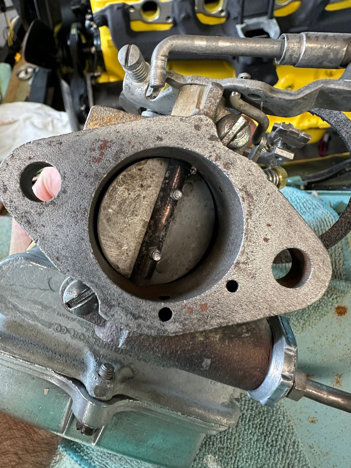

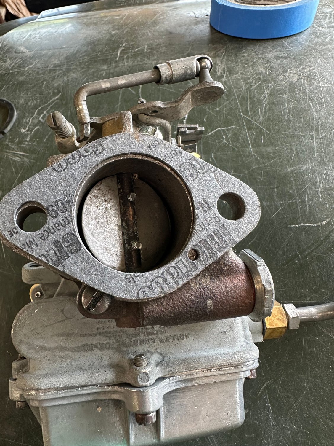

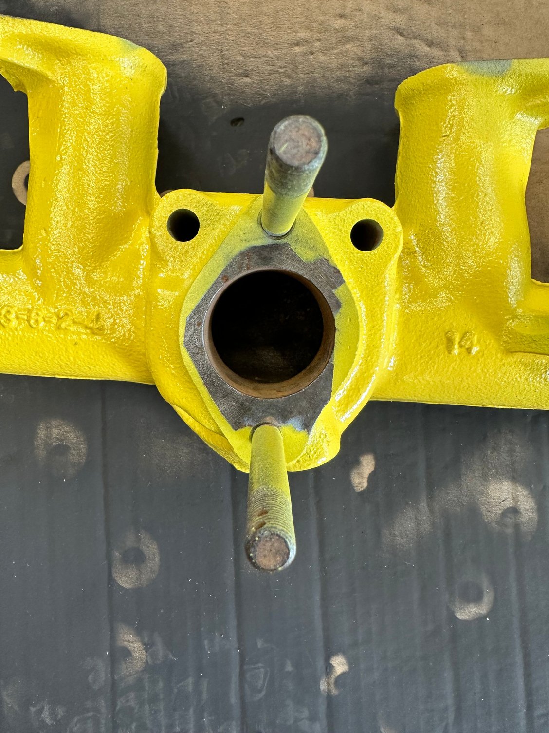

I want to be sure I get the correct gasket. Here are pics of my carb. On the bottom there are 2 small holes. The gasket I have has hole in it but it doesn't line up with anything. Does the gasket need those 2 holes or is it supposed to be solid? No corresponding holes on the intake.
I am ordering 6 as it looks like they need to be stacked as a spacer on my 223.

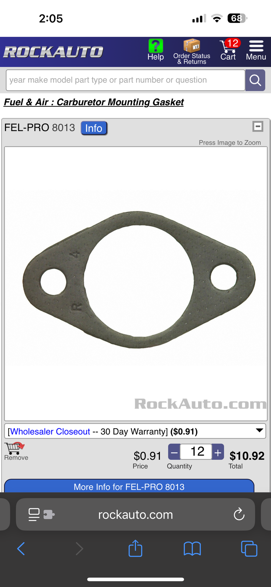

These are the ones from Rock Auto I found.

Yes, Ford documents 6 being used. The holes you are discussing on the carburetor base don't have anywhere to go on the manifold, so I wouldn't think that it really matters in this application.
