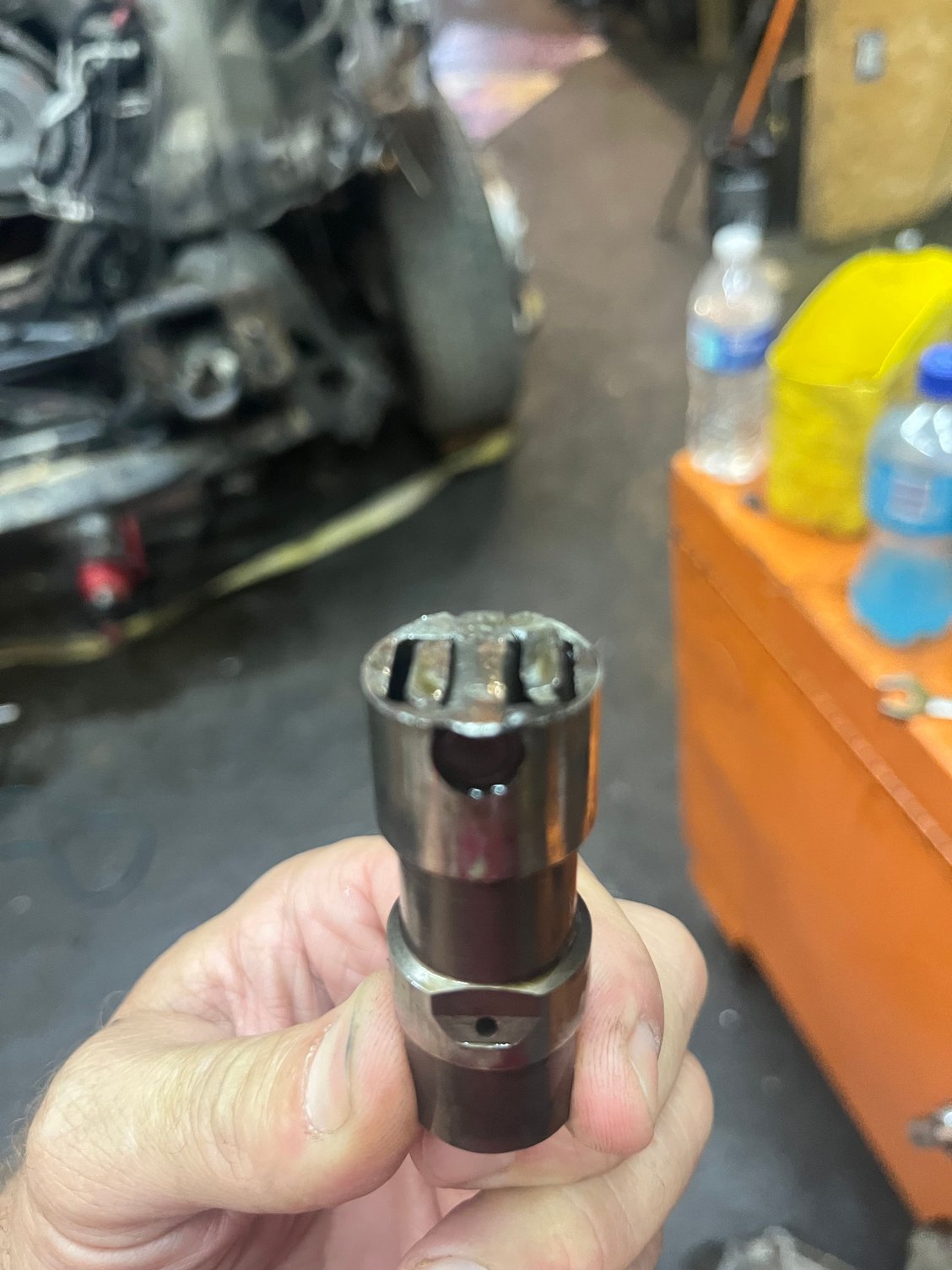

Bought a truck w a needle bearing in the lpop. Removed the heads to figure out which lifter was the culprit and so far no joy. But, we have one stuck. Comes up about half 1/2 or less and we can't see to get it out. Tried some pliers to grab it but won't come. Just stuck.
any ideas? Tks

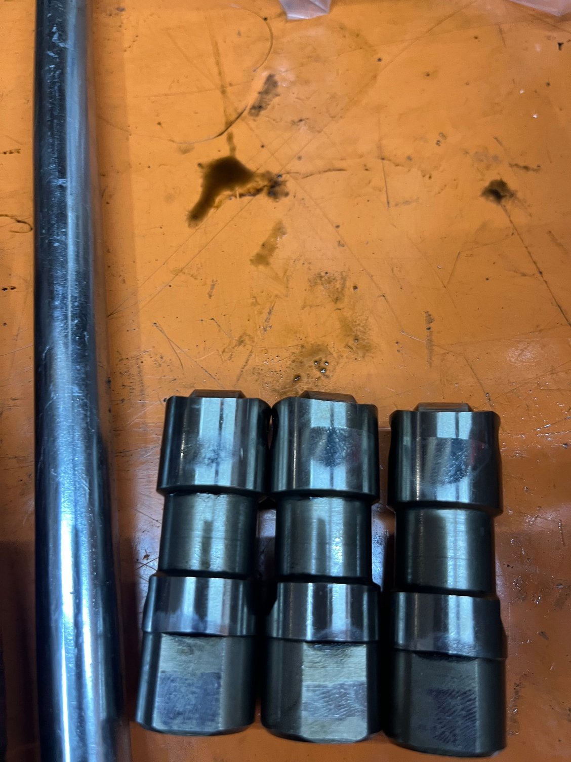

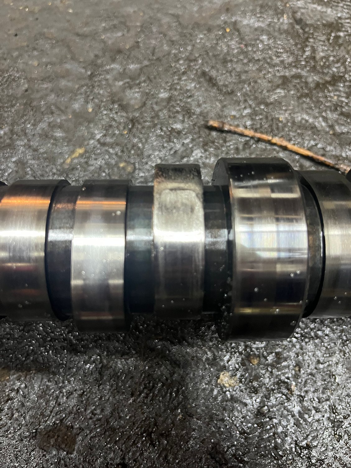

trying to figure out which lifter lost a needle bearing at this point. 11 that came out roll ver smooth on the finger. 3 have just a tiny rough feeling spot rolling it around but you wouldn't know any bearings are missing - not noticeable. One I can't get out. One I can't get out is next #5 cylinder and the race on. The cam doesn't have any bad scarring but does look like a bunch of ice pick, head of a needle size marks, as you turn it. It's noticeable compared to how smooth everything else is.
ordered a slide hammer tool to get this last one out.

I see it now. The three next to it. You can see where they got oil starved and started to wear.
the one stuck must've seized before it let loose and the bottom mushroomed on the cam.
we got a spare block w a cam. Looks like some work ahead.

It's stuck because the roller end was getting beaten and mushroomed a little. There is not much clearance to the bore.
The scuffing on the sides of the lifters is normal; they rock side to side depending on which side of the cam lobe they are on.
The pitting that you see on the lobes is the start of delamination. The thin, induction hardened layer on the lobe is starting to separate from the base material. Eventually, the crack will propagate under the surface, and larger pits will be found where the layer has flaked right off the cam base material.
As Hartwig said, the cam comes out, and the lifter is dropped into the block.

cam shaft is toasted too.

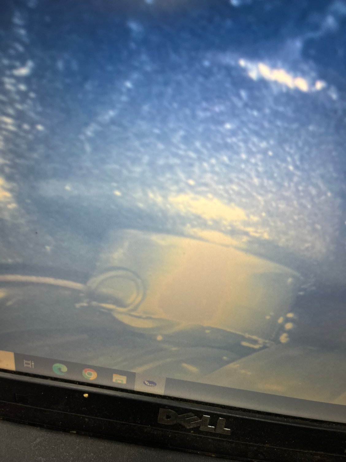

we will video the bearings but they races adjacent to the damaged lobe are in really good shape. Surprised at how little wear they show for obviously losing oil pressure around 5 and 7. We will dry it out look it over real good, hope to get a new cam in there and start putting it back together
