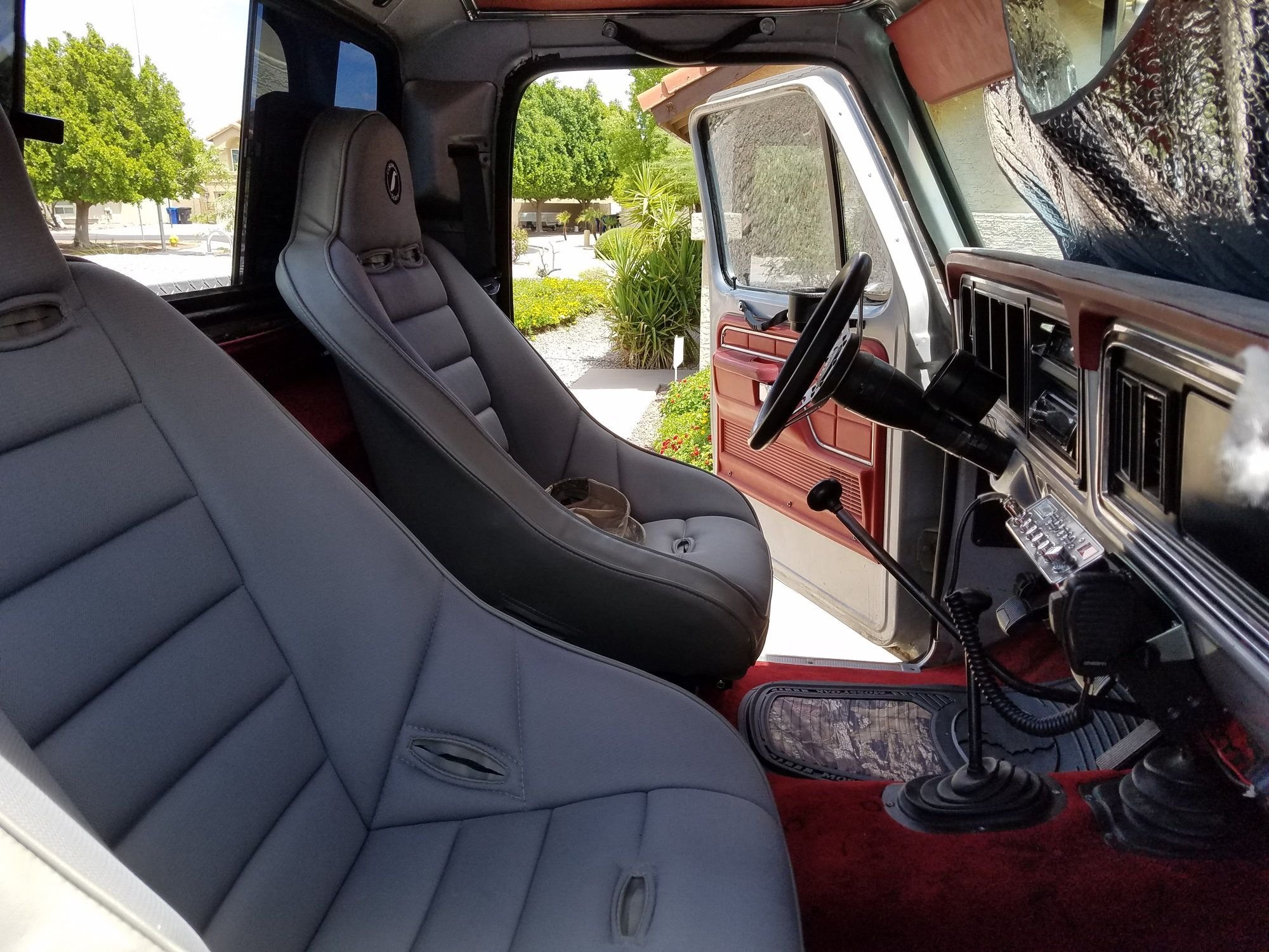

Well if you are considering Corbeau seat brackets...you might as well consider their bucket seats also. Note to self, that are not something to just jump up and slide into. You are steping up into the cab and climbing into them, for sure. But once you are in them, you are not sliding around.
Thread post #65 is his seat install. https://www.ford-trucks.com/forums/1...e-build-5.html
https://shop.broncograveyard.com/Cor.../products/296/

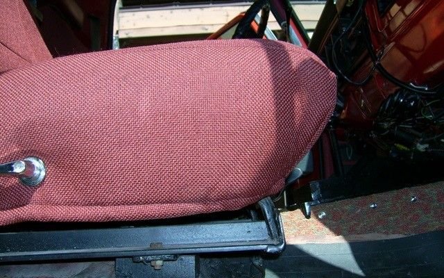

Well, not to sway you, but just to offer mount ideas for what you do wind up with. That front most black bar is 1/4" thick, 2" wide and spaced up off the floor near the ends with wood, since the 1980s. Right behind the belt buckle is a red like wise 1/4" thick angle, The lip of the angle also holds my behind seat storage in place. it too is spaced with wood to remain level.
Below are my 1986 Mercury seats, I cut the legs on the tracks and welded them to 1/4" flat bar that you see. Those are old seat covers.
Here you can see how the seat tracks I welded up set on the cross bars, a 3/8" bolt with washers hold them. The bolts near the center of the truck go through the floor too, nuts and washers under the floor. That's my newest seat covers. You can see that by changing bolt lengths, adding washers or spacers between the seat track bases and the bars on the floor, angle and room under the steering wheel can be adjusted to suit too.
Below is my new seat covers on my old seats, they pretty much stay all the way back unless I need to get something from behind one.
That is the center of a three section behind seat storage I built long ago, it sits behind the angle, the top has a few bolts into riv nuts in the cab back. The two sides have covers that the seat backs hold in place.
I had it all out a couple few years back to refurbish while the truck was getting long overdue refreshing. This is just as it was waiting for its refresh too.
Anyway, you mentioned making brackets, etc. Maybe something there helps? Take care and do post pics when done please, we like pics here.
