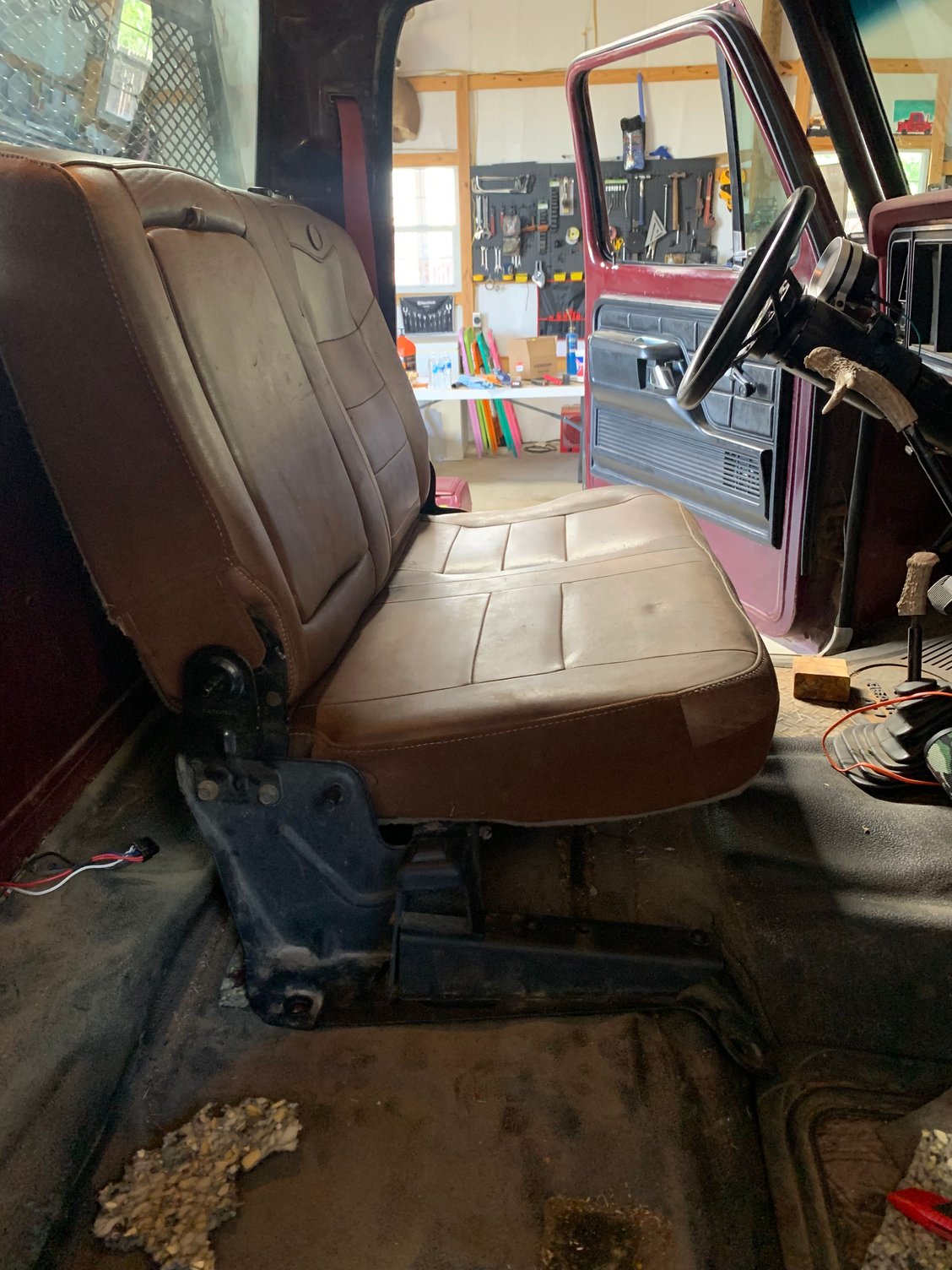

I got it set in and it’s really pretty close to ok. The center support leg sits a little higher than the two outside legs so I’ll need to figure out how to lower where that hits the floor slightly to get everything level. I could shim the outside legs up but I don’t want it any higher. I’m 5’11” and it’s ok but anyone over 6’ would be too tall. I plan on keeping this thing forever so I’m ok with having it a little high. The front feet are in good spots and I think all I will have to do is bend them slightly to make the angle match the floor just right. I have real thick vinyl and some insulation under it on the floor so it’s a little hard to tell how much it will suck down when I bolt it down. I’m out of time for today but I’ll mess with it again tomorrow.

Some pics:

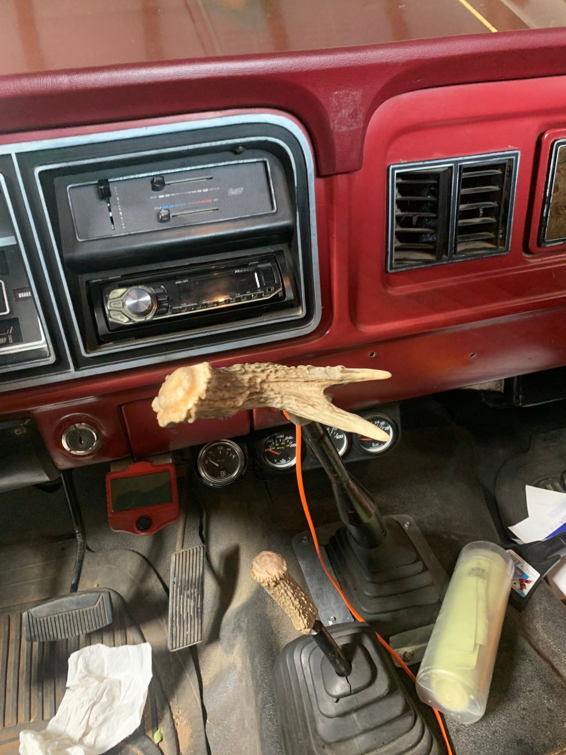

Nice, now I am back on the hunt for one of them. Nice shift *****...ah horns there Deerhunter4.
Seen this? https://www.ford-trucks.com/forums/1...-trinkets.html
Thanks! My buddy had the idea and I had a bunch of sheds at the house so I found some that worked for the ZF5 and the TC.
BTW this seat is kicking my butt. I’ve tried everything I can think of but I think I’m going to have to cut the center support and weld it back together. I need that one about an inch or two lower. The center of the cab floor is that much higher than the outer spots closer to the doors. The outer two legs put the seat at just the right height but the center leg is just too high and the two sections of the seat won’t align. I’ve got it shimmed on the outsides with 1.5” square tubing for now and it bolts in just fine but I don’t like the height. Oh well at least I have something to keep me busy.
